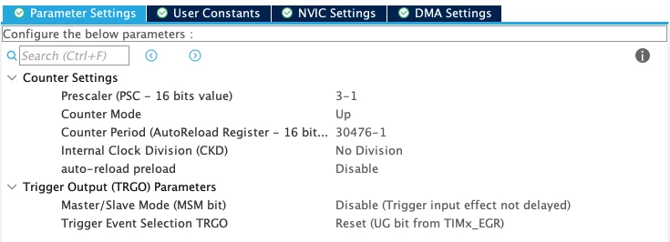

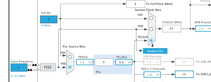

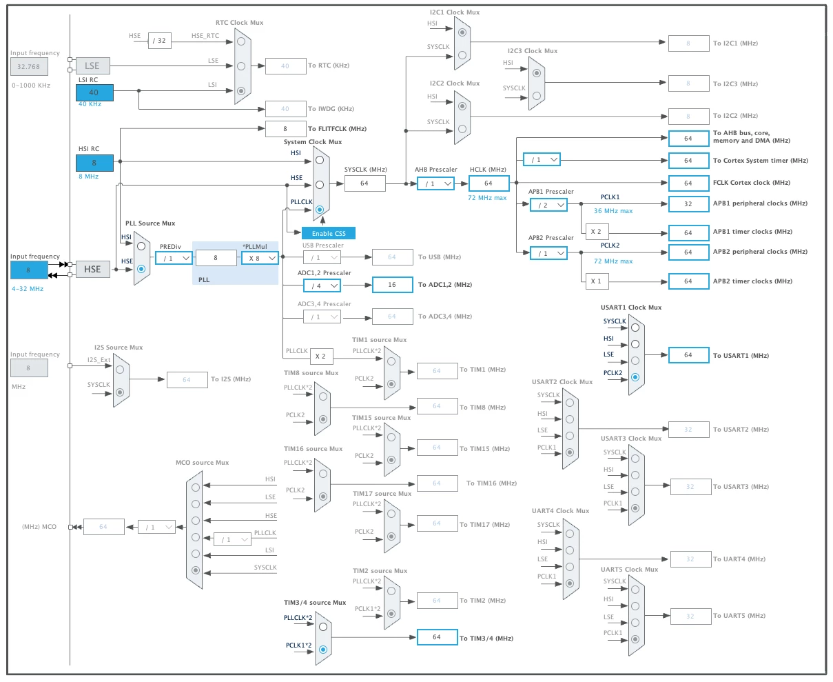

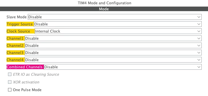

My STM32F303RE is running with an 8MHz crystal feeding into HSE:
Using TIM4 I want to generate 700 interrupts per second, but I only get 318.
As can be seen TIM4 runs at 64MHz and the following configuration should trigger about 318 interrupts:
Using the following formula:
(edit note - had a typo in the formula)
interrupts_per_second := clock_frequency / (prescaler + 1) / (counter_period + 1)
64 MHz / 3 / 30476 = 700
The 318 interrupts are way off the expected 700 and I just can't figure why. Any ideas are highly appreciated.

NRumm.1
NRumm.1Best answer
Jan 20, 2024 12:18 AM UTC
*** me - it was a bug. Deep in my code I disabled the interrupt and restarted the timer.
Thx for your support, guys - I learned a lot !

Jan 16, 2024 8:13 PM UTC
64M /3 / 30476 = 700 --- seem ok.
+ How you check the rate then ?
try -> set a led toggle in timer int and look with a scope at the pin.
Jan 16, 2024 8:16 PM UTC
How are you monitoring this exactly?
Try clocking from internal HSI to rule out any HSE issues.
Your math (sort of) and expectations check out.
> 64 MHz / 2 / 30475 = 700
Think you made a typo here. Should be 3 instead of 2. Result is the same.
64 MHz / 3 / 30476 = 700.0043750273439 Hz

Jan 18, 2024 8:42 PM UTC
So I'm still not making any progress here.
What I tried so far:
  • used MCO to output the HSI and HSE clock on pin PA8 - the measured frequency is 8MHz which is exactly what it should be, so the hardware setup is correct
  • used MCO to output LSI with a measured result of 37,9 kHz - everything ok here
Interestingly I was unable to output PLLCLK and SYSCLK using MCO. Once I use HSE as the clock source for SYSCLK I measure 8MHz which is ok. In my clock setup SYSCLK is generated from PLLCLK so I wonder if there's something wrong with my setup of PLLCLK, but I can't see what it is.
NRumm.1
NRumm.1Author
Jan 18, 2024 8:52 PM UTC
Some progress here - the issue with the lacking MCO signal for SYSCLK and PLLCLK was caused by the default speed setting of the MCO output pin PA8 as GPIO_SPEED_FREQ_LOW. Once set to GPIO_SPEED_FREQ_HIGH there's a signal on that pin and I can measure the expected 64 MHz.
So now I know that all clocks are working as expected, just the timer isn't.
Jan 18, 2024 9:01 PM UTC
What else is going on in your program? Feels like there is competition for cpu resources and/or an interrupt which is blocking for too long. Change frequency to say 10 Hz, do you get all of them?
NRumm.1
NRumm.1Author
Jan 19, 2024 9:37 PM UTC
I changed the timer config to get 100 Hz, but only measure 44.3 Hz. The factor between the expected and the actual frequency is constant over a wide range of timer settings - it stays around 2.2, so the expected frequency is 2.2 times the actual frequency.
