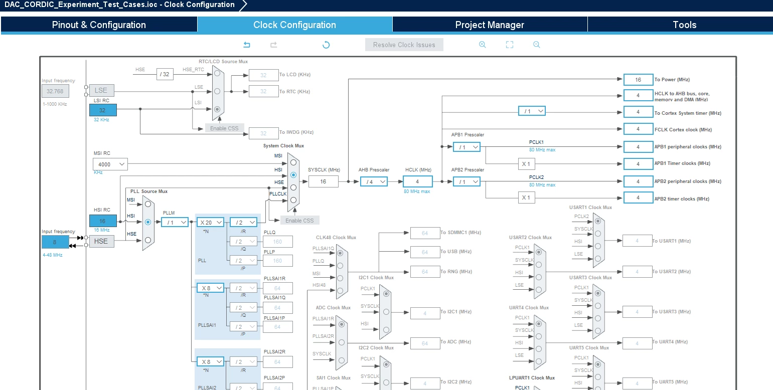

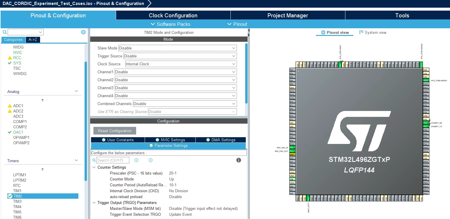

I am using STM32L496ZGT6P. When using DAC along with DMA to generate voltage and frequency of my desired range. But I am unable to get hold of the frequency setting. Sysclk I set is 4Mhz. 20 is prescaler value, 4Mhz/20 = 200000.This is further divided by 10 which is time period(ARR) .I am supposed to get 20000 as output in DAC, which I am getting in UART because of the below function, but I am not getting that in CRO. in CRO I am getting 100Hz when I tap DAC output. I have cross checked the output of the DAC using multimeter also. I am getting 100Hz in multimeter. I am unable to figure it out where is the mistake. So any help in this regard is greatly appreciated.

Below is my Sysclkconfig function.
void SystemClock_Config(void)
if (HAL_PWREx_ControlVoltageScaling(PWR_REGULATOR_VOLTAGE_SCALE1) != HAL_OK)
Error_Handler();
RCC_OscInitStruct.OscillatorType = RCC_OSCILLATORTYPE_HSI;
RCC_OscInitStruct.PLL.PLLState = RCC_PLL_NONE;
Error_Handler();
RCC_ClkInitStruct.SYSCLKSource = RCC_SYSCLKSOURCE_HSI;
RCC_ClkInitStruct.AHBCLKDivider = RCC_SYSCLK_DIV4;
RCC_ClkInitStruct.APB1CLKDivider = RCC_HCLK_DIV1;
RCC_ClkInitStruct.APB2CLKDivider = RCC_HCLK_DIV1;
if (HAL_RCC_ClockConfig(&RCC_ClkInitStruct, FLASH_LATENCY_0) != HAL_OK)
Error_Handler();
Below is my timer init function:
static void MX_TIM2_Init(void)
/* USER CODE BEGIN TIM2_Init 0 */
/* USER CODE END TIM2_Init 0 */
TIM_ClockConfigTypeDef sClockSourceConfig = {0};
TIM_MasterConfigTypeDef sMasterConfig = {0};
/* USER CODE BEGIN TIM2_Init 1 */
/* USER CODE END TIM2_Init 1 */
htim2.Instance = TIM2;
htim2.Init.Prescaler = 20-1;
htim2.Init.CounterMode = TIM_COUNTERMODE_UP;
htim2.Init.Period = 10-1;
htim2.Init.ClockDivision = TIM_CLOCKDIVISION_DIV1;
htim2.Init.AutoReloadPreload = TIM_AUTORELOAD_PRELOAD_DISABLE;
if (HAL_TIM_Base_Init(&htim2) != HAL_OK)
Error_Handler();
sClockSourceConfig.ClockSource = TIM_CLOCKSOURCE_INTERNAL;
if (HAL_TIM_ConfigClockSource(&htim2, &sClockSourceConfig) != HAL_OK)
Error_Handler();
sMasterConfig.MasterOutputTrigger = TIM_TRGO_UPDATE;
sMasterConfig.MasterSlaveMode = TIM_MASTERSLAVEMODE_DISABLE;
if (HAL_TIMEx_MasterConfigSynchronization(&htim2, &sMasterConfig) != HAL_OK)
Error_Handler();
/* USER CODE BEGIN TIM2_Init 2 */
/* USER CODE END TIM2_Init 2 */

void calculate_DAC_OUTPUT_Freq(void)
sysclk = HAL_RCC_GetSysClockFreq();
//uint32_t data = SystemCoreClock;
pclk1 = HAL_RCC_GetPCLK1Freq();
prescaler_bits = (RCC->CFGR & RCC_CFGR_PPRE1) >> RCC_CFGR_PPRE1_Pos;
timer_clock = pclk1;
if (prescaler_bits != 0) {
timer_clock = 2 * pclk1;
timer_prescaler = htim2.Instance->PSC;
period = htim2.Instance->ARR;
timer_frequency = (double) timer_clock/ ((timer_prescaler + 1) * (period + 1));
dac_output_frequency = timer_frequency / NP;
The above function answers the question. I didn't spend enough time on how to find the frequency of the DAC. It was a trivial question!
