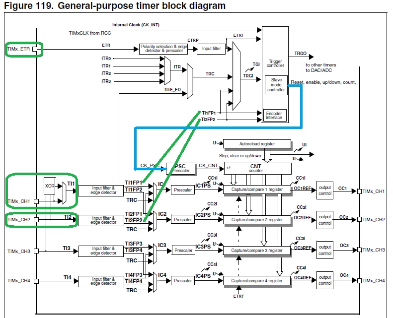

Posted on August 13, 2013 at 16:05
Could someone explain me how external clock for timer is done. Specially I don't understand how TI1, TI2 etc., are mapped to the physical pin.
Alternate function on GPIO is mapped to different timers but is it the TIx pins?
Thanks
John
