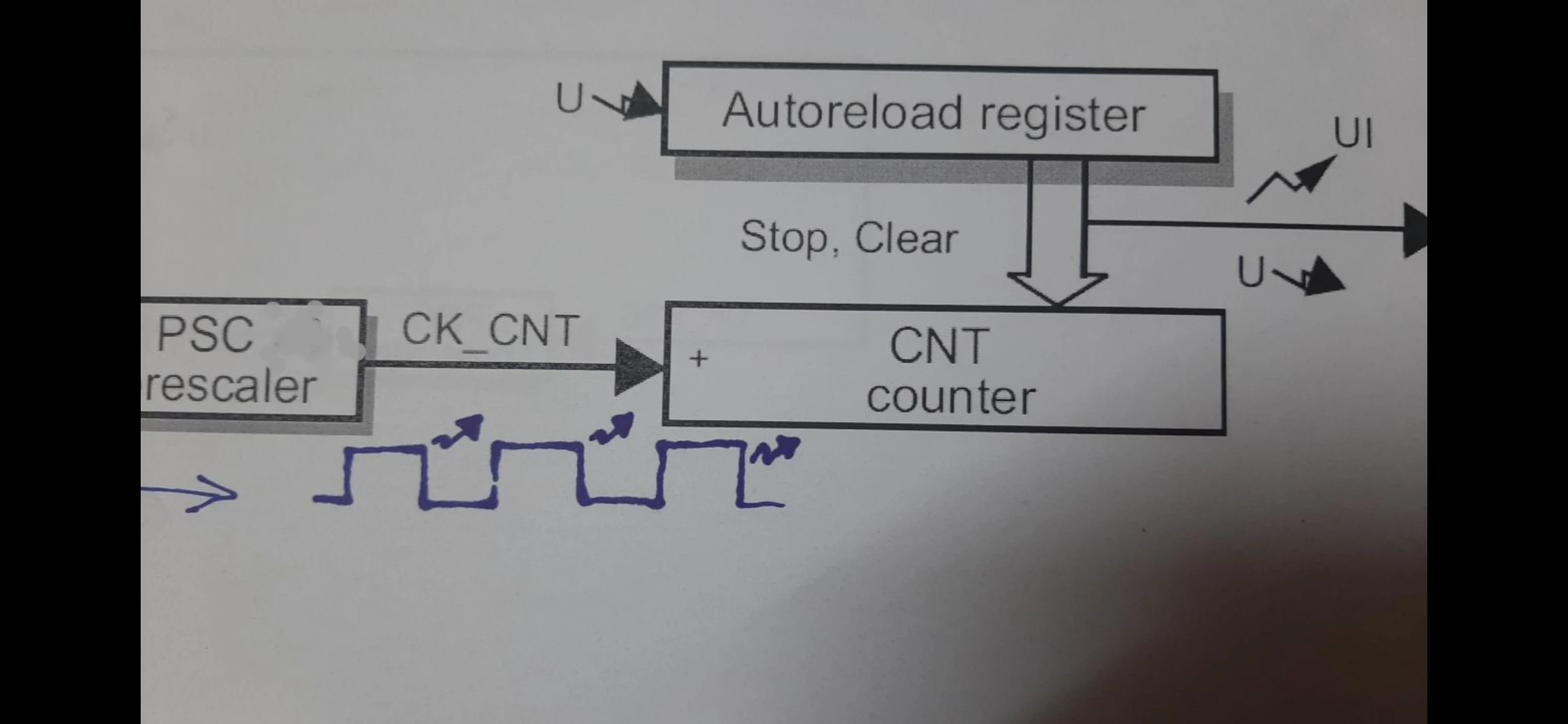

Hi
When I want timer count (CNT register) until ​5000 for overflow , Set ARR = 5000-1; now I want timer count until 1 So I have to set value ARR = 1_1 (ARR = 0) But When Set ARR = 0 timer don't work and don't have interrupt. Why??
​how to set ARR For that evry input pulse one overflow interrupt??
Tanks

The counter is "blocked" when ARR=0, this is explicitly stated in the reference manual (see the ARR register description).
You can use the trigger interrupt (TIM_DIER_TIE) instead.

You can make the Prescaler smaller, to zero for no division. The period needs some range to work with.
Interrupting beyond a few hundred KHz is probably going to saturate the processor.

I want ​to have a overflow interrupt
For every clack that comes into the CNT counter.
P​ay attention to pictur
