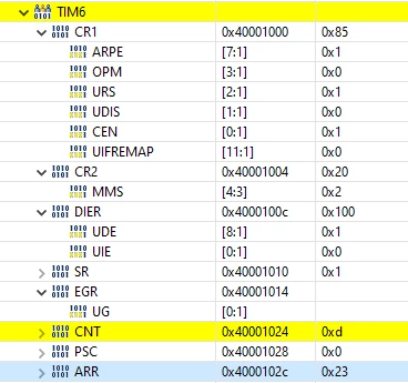

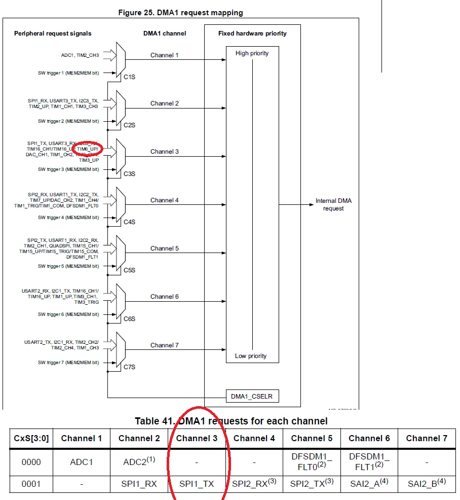

I am feeling really blind, because I cannot figure out the problem. At first, I was trying to find the right setting to get the Timer to trigger a DMA request upon UEV generation. However, I could not find such a feature. So instead, I setup DMA1 Channel 3. TIM6 should map to this DMA. Then I setup TIM6 to generate a UEV upon Overflow (URS = 1, UDIS = 0). Finally, I setup TIM6 to generate a DMA request upon update (UDE = 1).

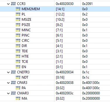

Would the DMA rapid fire send N-bytes to the SPI upon the first successful DMA request? Is there a way to get it to send only 1 byte at a time, triggered by the timer?
And auto-increment through memory? So..
  • Timer6 -> Overflow -> UEV -> DMA -> Byte 0 -> SPI
  • Timer6 -> Overflow -> UEV -> DMA -> Byte 1 -> SPI
  • Timer6 -> Overflow -> UEV -> DMA -> Byte 2 -> SPI
  • Timer6 -> Overflow -> UEV -> DMA -> Byte N -> SPI

> Will the DMA move 1 byte per request (TIM6 UEV) or 28 bytes?
One.

Which STM32?
How do you trigger DMA? Show the register which selects the trigger source.

So, first, make sure -by looking at the datasheet- that the DMA  request is lined to the right SPI peripheral
Regarding your question about the DMA; ofc it is possible -in the DMA config- by setting the DMA transfer size to 1 byte and enabling auto-increment for the DMA source address.

So Channel 3 should be able to be triggered by TIM 6 and cause SPI1 TX to transmit...?
