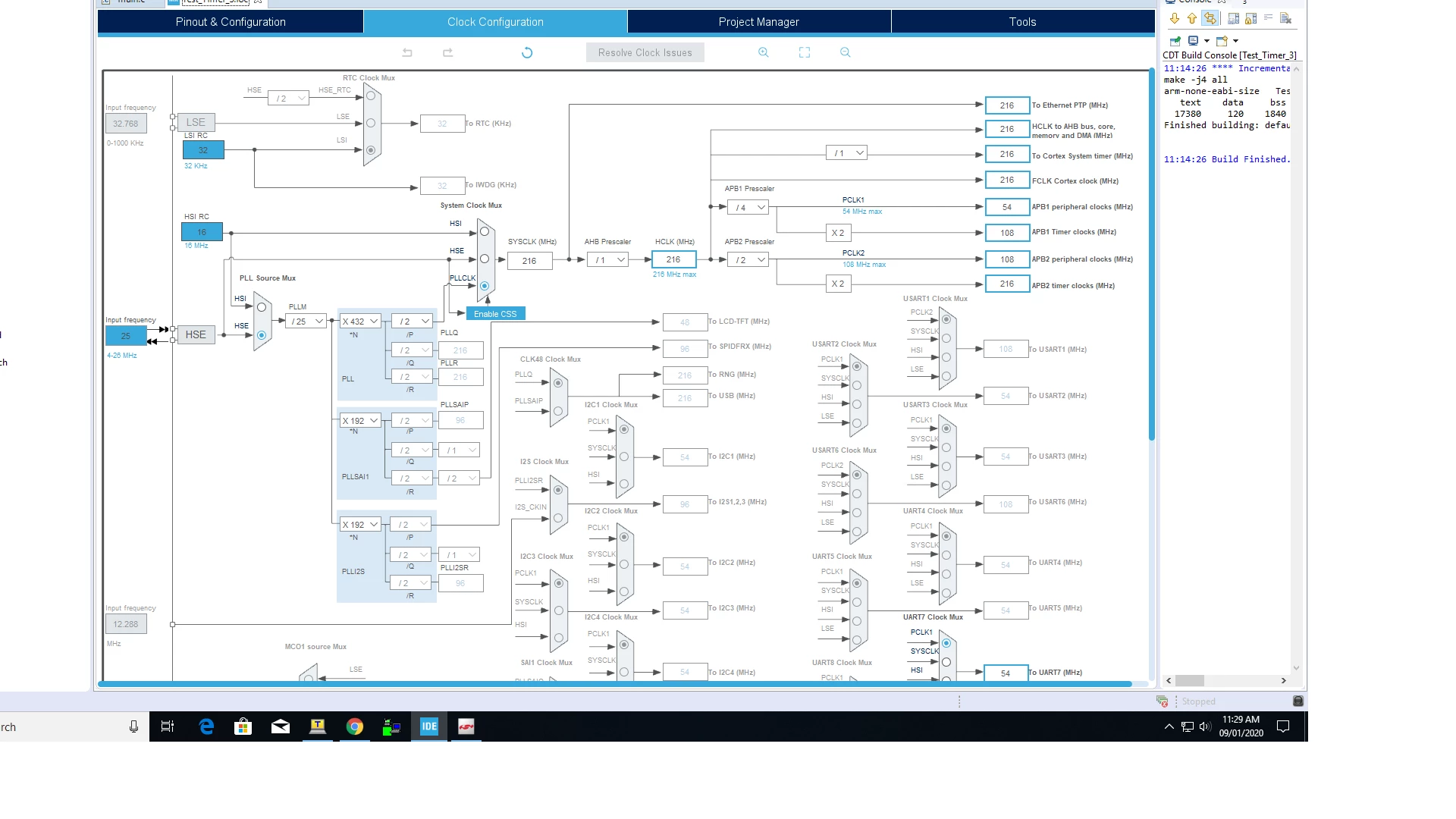

Timer count of 1 ms
Hello
I want to configure timer which increment count by every millisecond
what are value of prescaller or other parameter should configure in it ?
i am attaching you my clock configuration with this
RCC->APB1ENR |= (1<<1); // Enable clock for TIM3
TIM3->PSC = 65535;  // Int clk divided by 1000(999+1)   // 2160000    // 65535
TIM3->EGR = TIM_EGR_UG; // Forcing to generate a update
TIM3->ARR = 9999; // Counts from 0 to 7999
TIM3->CR1 = TIM_CR1_CEN; // timer start TIM_CR1_OPM
I want that TIM3->CNT should increment by every millisecond

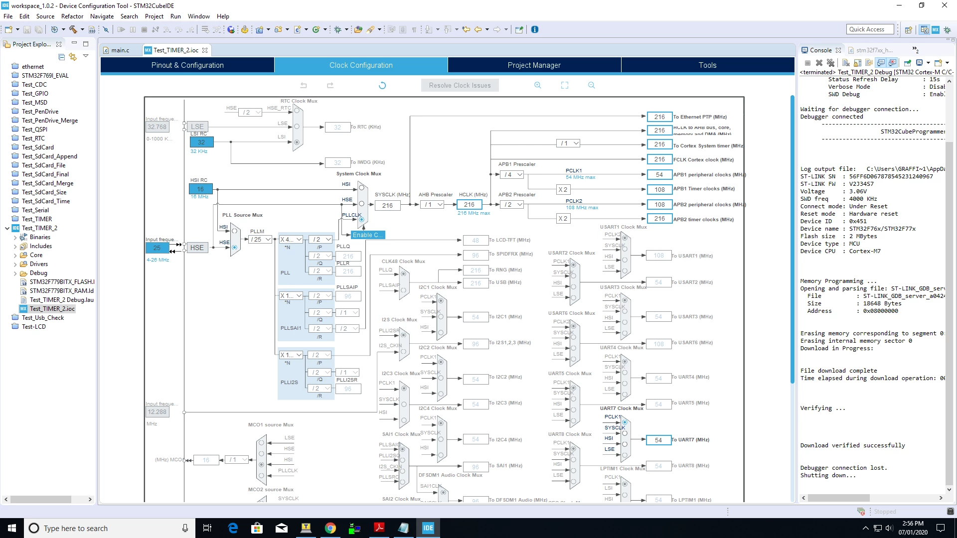

waclawek.jan
Jan 7, 2020 9:39 AM UTC
As you've probably found out, the prescaler is only 16-bit, so you simply can't divide a 108MHz input clock into 1kHz.
You could divide the whole APB1 down to a lower input clock, but that's probably not what you want as that influences all other peripherals on APB1 thus the total system performance.
Simply learn to live with what you have available. Other option would be to use two timers in master-slave arrangement, using one timer as a prescaler to the other.
dbgarasiya
Senior
Jan 7, 2020 11:54 AM UTC
Thanks for reply , I found out the solution
i divide whole APB1 and get timer clock as 54MHZ and then i solved out the solution
Thanks a lot,

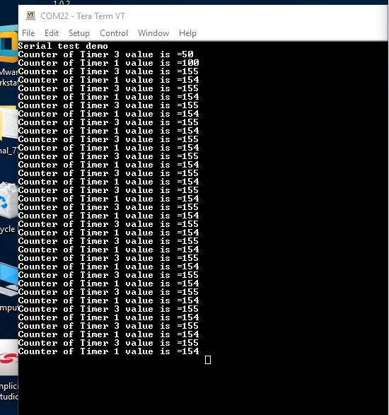

Hello ,
When i configure two timers in my project. and start both timer at same time
counter of both timer becomes same after first time (attached screenshot with post )
i have write code for counter 1
RCC->APB2ENR |= (1<<0);    // for timer 1
TIM1->PSC = 54000;
TIM1->EGR = TIM_EGR_UG;
TIM1->CR1 = TIM_CR1_CEN; // start timer 1
read count here // read counter 1
TIM1->CNT = 0; // reset counter 1
i have write code for counter 3
RCC->APB1ENR |= (1<<1);    // for timer 3
TIM3->PSC = 54000;
TIM3->CR1 = TIM_CR1_CEN; // start timer 3
read count here // read timer count 3
TIM3->CNT = 0; // reset timer 3
i have attached my output of terminal and clock configuration with this post
