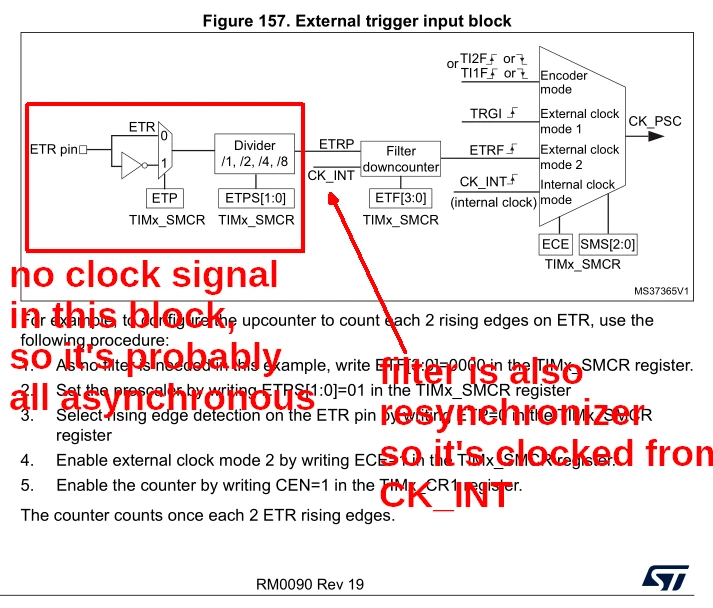

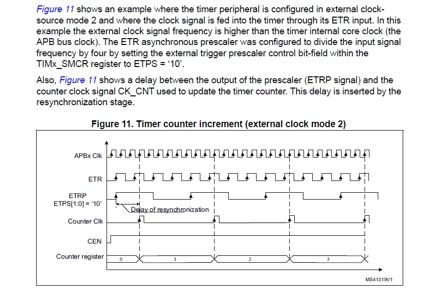

Shortly, cookbook says ETR frequency higher than core clock. It seems wrong. I am not sure if the information given is correct.
I don't see it saying that. [EDIT] Okay now I see it in the narrative. However, the waveform on the figure don't match the text... [/EDIT] On that figure, APBx_CLK waveform, which is here the internal/core clock, is clearly higher frequency than ETR waveform.

The narrative indicates, that the ETR prescaler is asynchronous. This means, that input signal on ETR may be higher frequency than the timer's internal clock, provided that the frequency after the asynchronous prescaler is lower than half the timer's internal clock.

I suspect however that input pins are sampled with SYSCLK. Calrification from ST would be fine, what Inputs are not sampled and what the sampling clock is, if sampling applies.

Mention of asynchronous prescaler for ETR in the Cookbook is IMO not a mistake. Closer look at the diagrams indicate this, too:

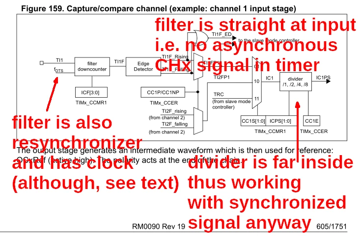

Compare with the diagram for CHx:
The input clock to filter/synchronizer there is probably incorrect, as it ought to be selectable between DTS and CK_INT, see description of TIMx_CCMRx.ICxF.
