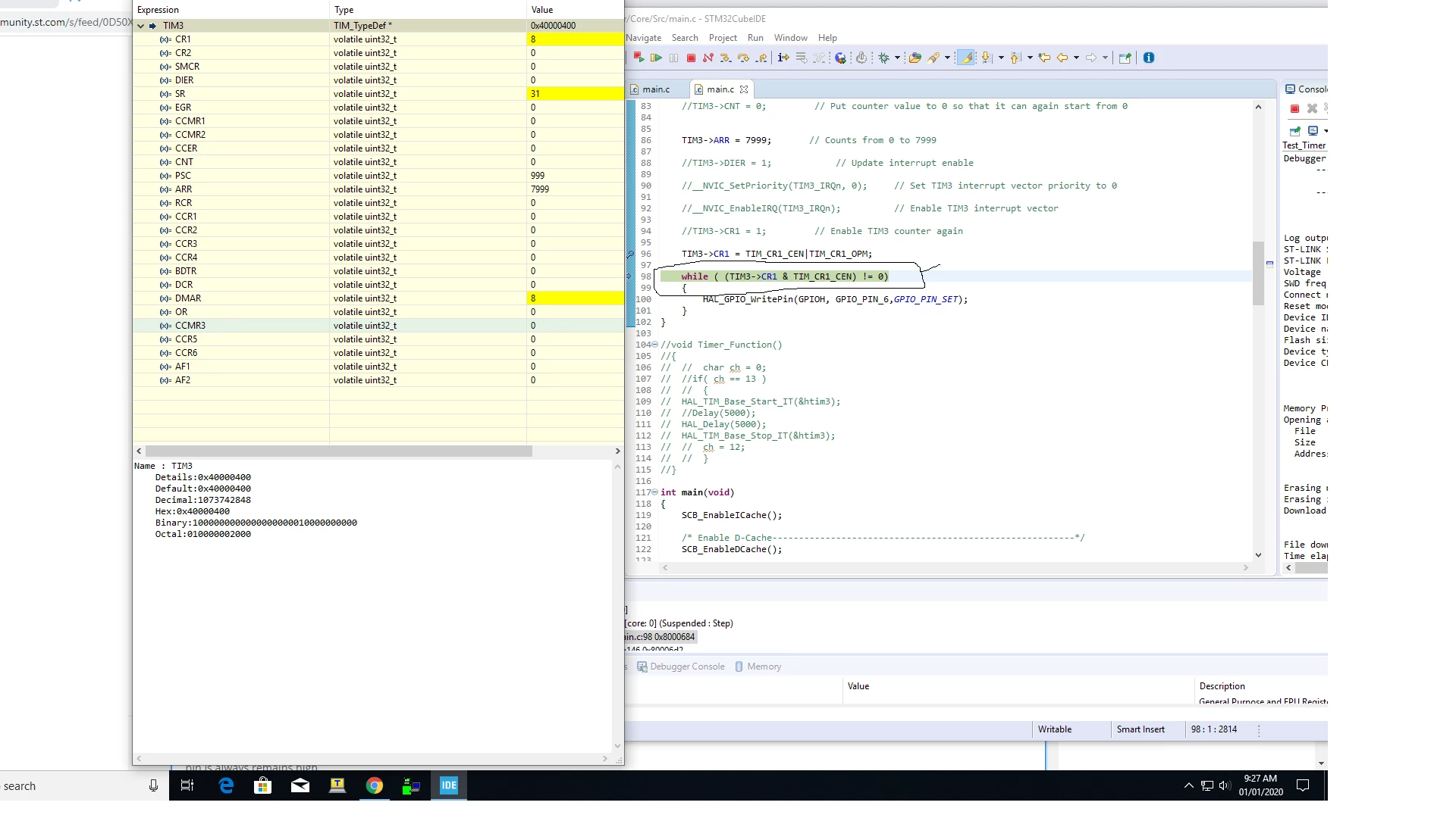

dbgarasiya
Senior
January 1, 2020
I have checked by debugging code , while loop never exits. and stops code there

berendi
Principal
January 2, 2020
I can't see the screenshot.
Check the timer registers. Do PSC, ARR and CR1 contain the values you've set? Is the counter changing?

dbgarasiya

Sorr for inconvience , i have just attached sceenshot with this post
dbgarasiya
Senior
January 3, 2020
I have solved out this problem , actually when i have write some code , like making another gpio write as @Community member​  have suggested, i solved issue
Thanks for support @Community member​  and @berendi​
berendi
Principal
January 3, 2020
Looks like the debugger got confused because there was no code after the while loop. This happens with gdb.
