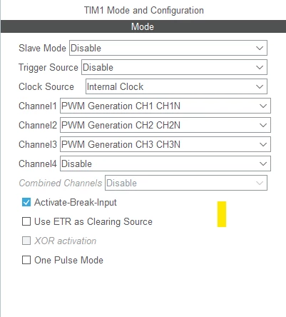

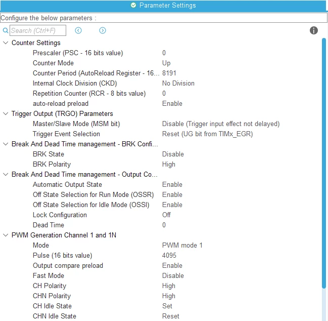

I've been working with PWM on TIM1 with the NUCLEO-F429ZI, I have three channels and their complementary channels active. This is an iterative test project, where I am bring function to life one step at a time. The following is the configuration for TIM1 (Note channel 2, 2N and 3, 3N have the same configuration as 1 and 1N).
TIM1 Channel ModesTIM1 Channel ModesTIM1 ParametersTIM1 Parameters

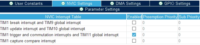

After being happy with the PWM timer, I enabled the commutation interrupt
TIM1 InterruptsTIM1 Interrupts
In the beginning I also had the update interrupt and that was working and firing. Then in my loop I was simply trying to fire a commutation generation event about once every second (just rough test). The if statement runs but the "void TIM1_TRG_COM_TIM11_IRQHandler(void)" routine never runs for some reason.
I then took the event generation out of the loop and did it once in the beginning made a test to see if the commutation flag is being set (it is), but it's never serviced and then cleared. So the LED kept toggling. It can be manually reset.
Here is the current version of my main, in the middle of trying out some tests. The code is temporary test code after trying to debug. But from all I can see I have configured the timer to accept the software events, I thought "void TIM1_TRG_COM_TIM11_IRQHandler(void)" would handle that. Perhaps I am wrong there.

waclawek.jan
waclawek.janBest answer
May 31, 2024

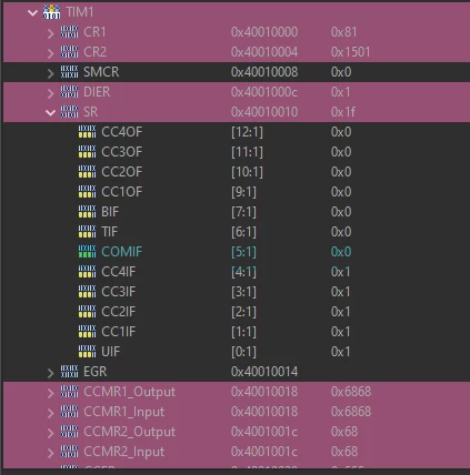

In your timer screenshots, TIMx_DIER=0x1, i.e. only UIE is set, not the commutation interrupt enable bit.
I don't use Cube/HAL.

static void MX_NVIC_Init(void)
 /* TIM1_TRG_COM_TIM11_IRQn interrupt configuration */
 HAL_NVIC_SetPriority(TIM1_TRG_COM_TIM11_IRQn, 0, 0);
 HAL_NVIC_EnableIRQ(TIM1_TRG_COM_TIM11_IRQn);
Enabling the function that I thought would handle the Event Generation for TIM_EVENTSOURCE_COM

waclawek.jan
May 30, 2024
Cube/HAL is open source, so you can debug it as your own code.
If you've verified by reading the TIM registers that the commutation event happened (the respectrive flag in TIMx_SR is set) and the commutation interrupt is enabled (respective flag in TIMx_DIER), then the processor should fire the respective interrupt (as you've said, it should be TIM1_TRG_COM_TIM11_IRQHandler, but that depends on how exactly the vector table, usually in startup code, is constructed). So place a breakpoint there, and if the interrupt does fire and stops on that breakpoint, walk through Cube's code to see, why does it not vector to the your callback. If the interrupt does not fire, follow steps from here.

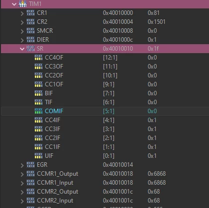

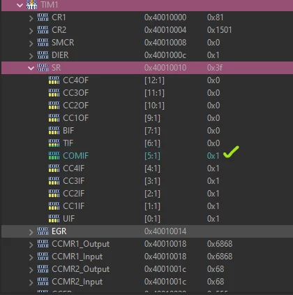

I've also checked the TIM1->SR and the COMIF bits, before and after event generation.
Before Event GenerationBefore Event Generation
After Event GenerationAfter Event Generation
After The Clear FlagAfter The Clear Flag
Satisfied that the COM interrupt flag is set and I can manually clear it I changed the main loop back to

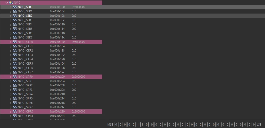

I'd like to add the contents of the NVIC registers, I've been trying to read through RM0090 to find the ISRx registers but have not been able to locate that. Thus I have a hard time knowing whether the interrupt enable lines are actually configuring things correctly. I attach here a picture of the registers, If anyone knows what page in RM0090 it is or in some other document I'd appreciate that.
NVIC ISERxNVIC ISERx
I also attach here the vector table in the start up, line 50 below has the interrupt in question.
DNG_GabbiAuthor
May 31, 2024
Thank you very much JW, this was absolutely that problem. I would have thought that either it would be enabled through CubeIDE or through the
HAL_TIMEx_ConfigCommutEvent(&htim1, TIM_TS_NONE, TIM_COMMUTATION_SOFTWARE);
I was unaware of this register (DIER) DMA/Interrupt Enable Register. For anyone else that might stumble on a similar problem adding the second line below, enables the com interrupt for TIM1.
htim1.Instance->DIER |= TIM_DIER_COMIE; // THIS LINE!
 Again thank you very kindly for the assistance JW, I was losing my hair :grinning_face_with_sweat:
