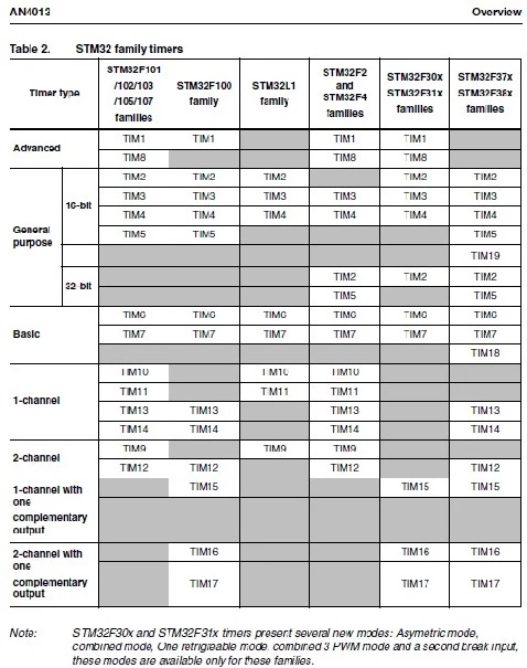

    I was looking at application note:
    AN4013
    Application note
    STM32F1xx, STM32F2xx, STM32F4xx, STM32L1xx,
    STM32F30/31/37/38x timer overview
    This shows that all F1x devices have the TIM5 peripheral.  Is this a typo or am I interpreting this note incorrectly?

    Posted on November 16, 2013 at 17:12
    The
    http://www.st.com/st-web-ui/static/active/en/resource/technical/document/datasheet/CD00251732.pdf
    is the controlling document for the
    http://www.st.com/web/catalog/mmc/FM141/SC1169/SS1031/LN775/PF216844
    , see pg 29 (and others)
    You could verify the APB clock enable bits in the two registers, and confirm the TIM5 and TIM8 enable bits are stuck-at-zero.
    The VL parts should always be viewed as function stripped parts, the reference manuals tend to focus on the highest common denominator.
    I haven't review the App Note, but it appears to over state the functionality of the chip on the VL Discovery board

    Thank you clive1.  I will refer to the data sheet as the definitive source to try confirm things like this in the future.  I have run into similar situations in the past and there has been cases where the secondary documentation (application note) is actually right and the primary (data sheet) was wrong.  But as you said, the evidence clearly shows the data sheet is correct in this scenario.
    I changed my code to use timer 3 and indeed the world is right again after the change.
