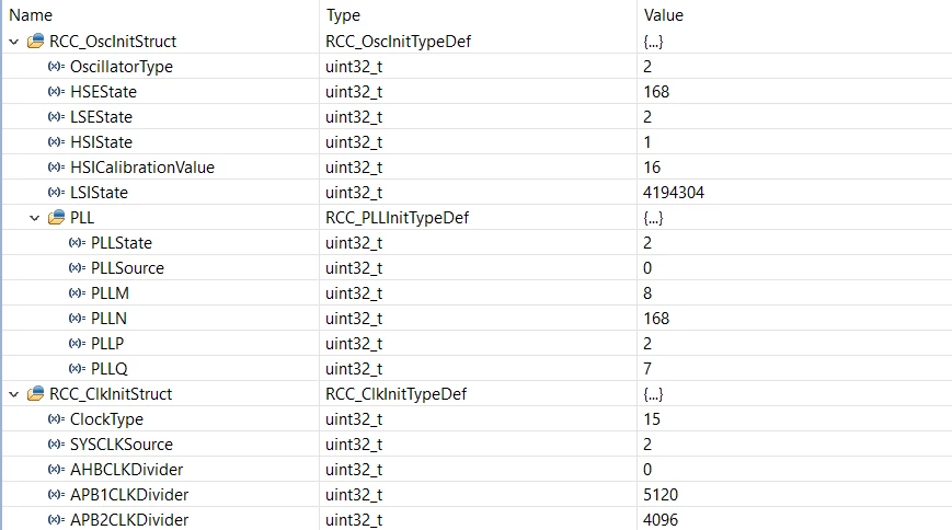

    yang hong
    yang hongAuthor
    Apr 11, 2018 9:17 PM UTC
    Posted on April 11, 2018 at 21:17
    I did some bug and get system clock information as followed:
    Do you think it is ok?
    waclawek.jan
    Apr 11, 2018 9:31 PM UTC
    Posted on April 11, 2018 at 21:31
    I don't know. There are too many things that may go wrong between setting a structure and actually having the regsiters set up - including the oscillator may be running or not.
    Why don't you output the system clock onto a MCO pin, and measure it? That's a sure way to know what is its frequency.

    yang hong
    yang hongAuthor
    Apr 13, 2018 6:21 PM UTC
    Posted on April 13, 2018 at 18:21
    I have simplified the isq code, so now only toggle output, it looks faster now, but it is still slower than what I want. I did some calculations, for example, prescale=29 and autoload=30, I got 8.5khz output, so it looks I have 8MHz timer clock. it is pretty strange because I thought I should have APB1 (84MHz). I am using NUCLEO-F429ZI and I use STM32CUBEMX to generate a code for my demo project.
    I read systme clock, hclk, pclk1 and pclk2 frequency. all of them are 16M.
    I attach my system clock code below:
