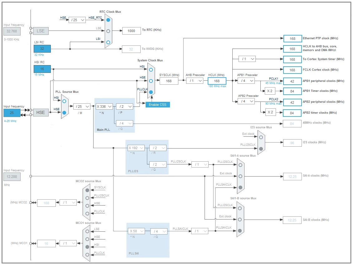

Hello.
I try timer 2 on STM32F427 and I have a problem. It ticks too quick.
Here is my system clock. I have external crystal: 25MHz
Clock I want to: 168MHz

And system init is here:And I know, that tick of timer is too quick. I measured it (indicatively) 38x. Any idea, what is wrong?

> TIM_InitStruct.ClockDivision = LL_TIM_CLOCKDIVISION_DIV4;
This does not do what you may think it does - it is a prescaler for the clocks used in input filters.

Yes. I found this information in datasheet.
Here is function solution:

// period = ( Fclk / 42000) = 1000 => 1ms
TIM_InitStruct.Prescaler = 42000 - 1;
