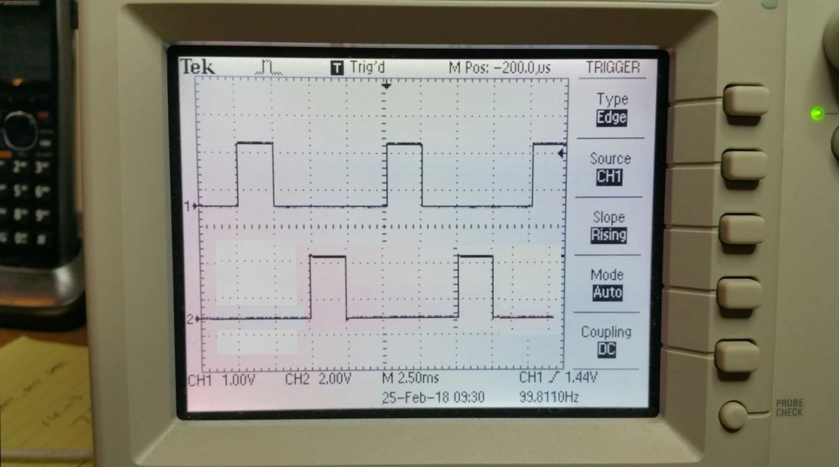

    Still getting a result that is not working. I just do not see how to configure the LL system on how to accomplish this.
    Both timers will be the same period. Let's say that period is 10ms and the DC is 25%. Then, I need the second timer's output pulse to occur exactly 1/2 the period time. See the attached (hacked) image. Again, this I can presently do in CMSIS, but not in LL.
    If TIMx starts at t = 0, TIMy output will be at t + 5ms. Again - I have the code configured so that right now, a PWM is occurring on TIM2 (PA5), TIM3( PA6) and these 2 signals are in phase. The question is, with a TIM2 period = 10ms, how do I get timer 3 to trigger at TIM2 + 5ms ?
    Seems it should be easy....but after looking at the LL mechanisms, not obvious.

    Rogers.Gary
    Senior II
    February 25, 2018
    Posted on February 25, 2018 at 16:15
    jan,
    I had the timer offset in my code, just did not post it above. It looked like this:
    TIM3->CNT = TIM2->CNT + ((uint16_t) (LL_TIM_GetAutoReload(TIM2) / 2 ));
    The issue all along was the placement of the code 'LL_TIM_GenerateEvent_UPDATE'
    Once I moved that as you suggested, it worked.Great!
    Thanks again to you and everyone else who provided help with this.
