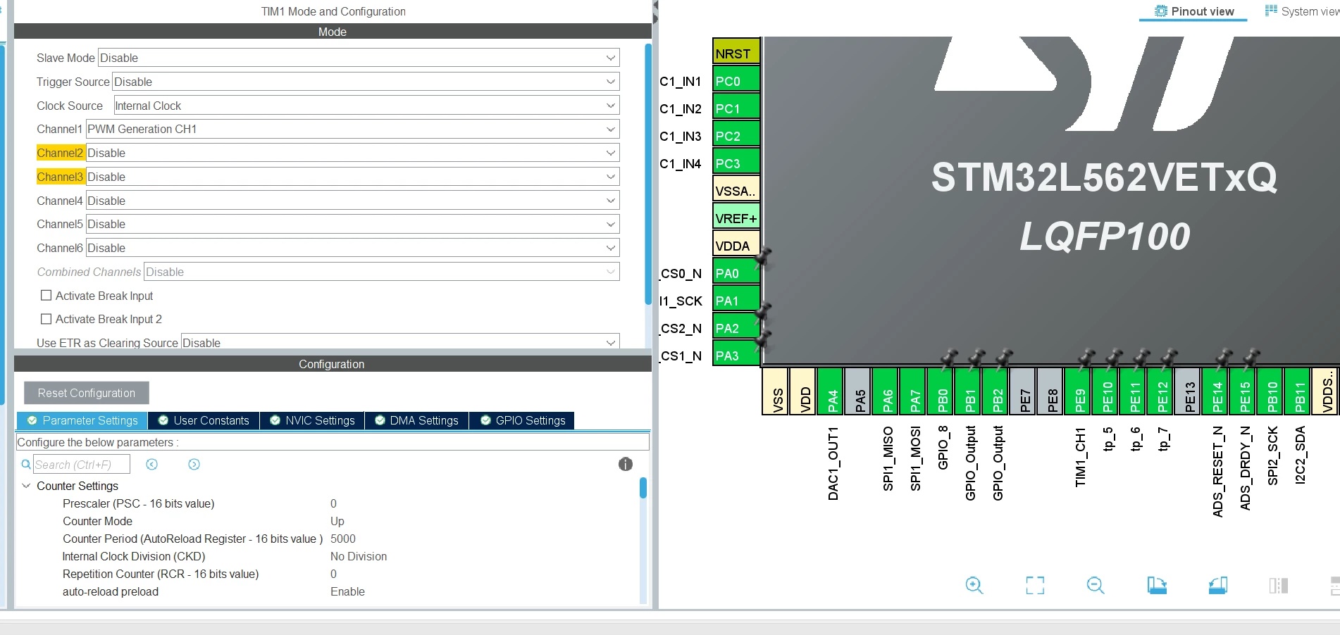

I have defined PE9 as belonging to Timer 1;
I setup timer 1 as PWM as shown above.
When I enable the timer, nothing happens at PE9.
I tried setting force  high; no change
When I define PE9 as standard output forced high, it goes high.  So I know that the pin is connected correctly to the board.
But I'm not doing something to correctly setup PE9 as a PWM output

The answers given were helpful but not the full story.
Using the GUI for Timer1 was confusing and unsuccessful.
Here is the code that eventually worked
