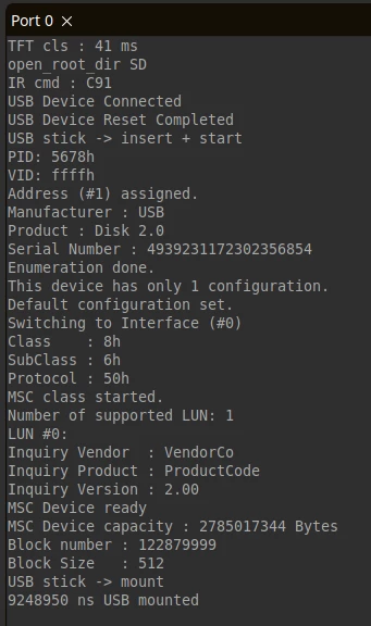

ok, so via swd + DWT counter ->
about 9,2 ms from inserted to fatfs mounted ok;
is 64 GB (noname chinese..) USB stick, exfat , 50GB free.

How often you call the  MX_USB_HOST_Process(); ?
I call it in main loop about every some 5us ....nothing else to do now, waiting for first command.
So this might be maximum speed, that can be achieved .

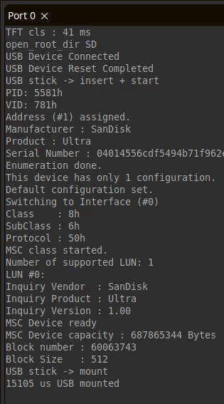

ed
Just for fun - had the idea, to try an old SanDisk 32GB stick, fat32,  also, got ->
about 15ms insert to mounted. Ok for this piece of plastic shi.t , i think.
