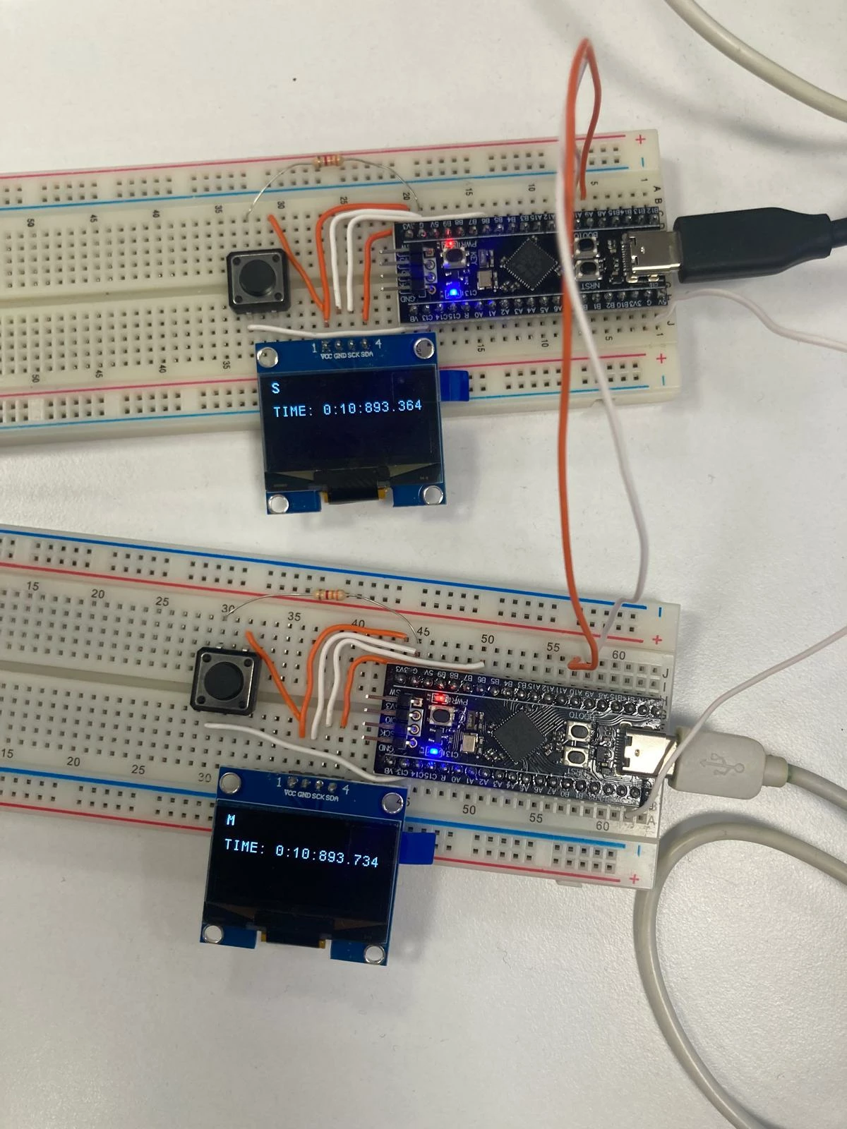

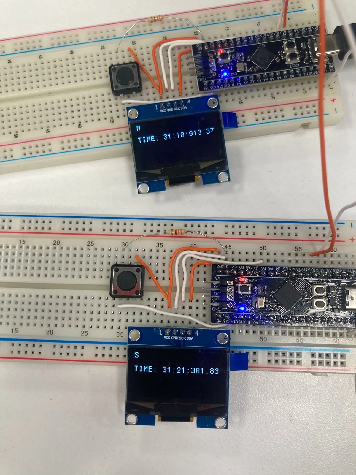

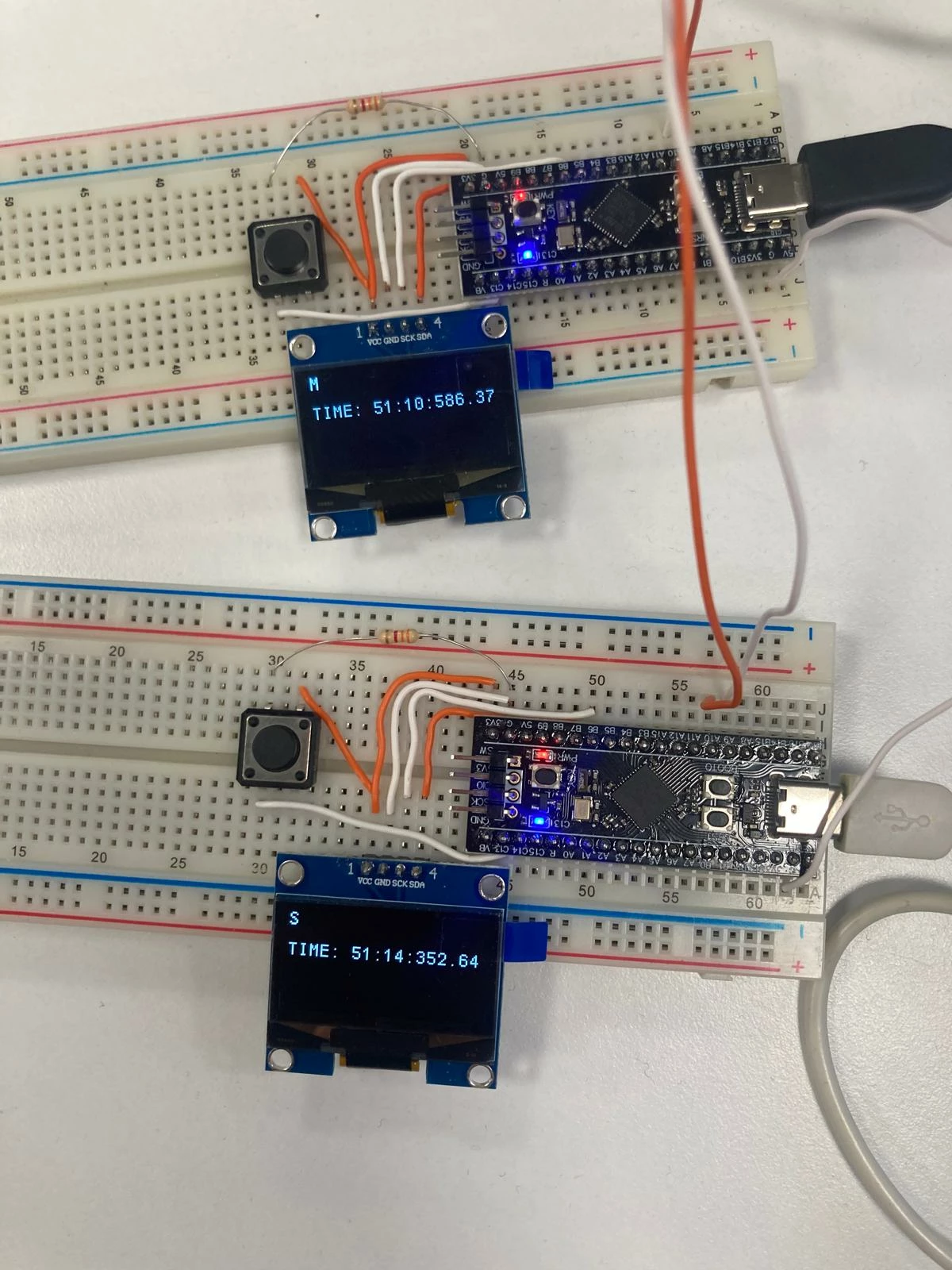

After synchronization:
  • Drift increases over time
  • After 30 minutes → ~2400 ms difference
  • After 50 minutes → ~3200 ms difference
This corresponds to approximately:
~1300 ppm difference between the two boards.
Both boards are identical and running the same firmware.

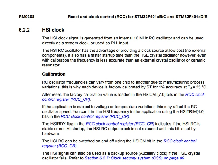

Did you refer to the datasheet?:
This is is for an ST genuine chip (genuine STM32). I'm not sure what you have on that Black Pill board.
Meanwhile, if you are measuring the time in one second precision HSI is not the right clock source. You need to use a crystal and use it with RTC and LSE.

There are two main documents for a product:
The user manual: mainly for the peripheral and register description. In your case RM0368
The datasheet: manly for the electrical characteristics. In your case DS9716  /Table 39. HSI oscillator characteristics
The errata sheet can also be considered a recommended document to refer to. It provides the limitations in the product as well as some workarounds of these limitations. In your case: ES0222
