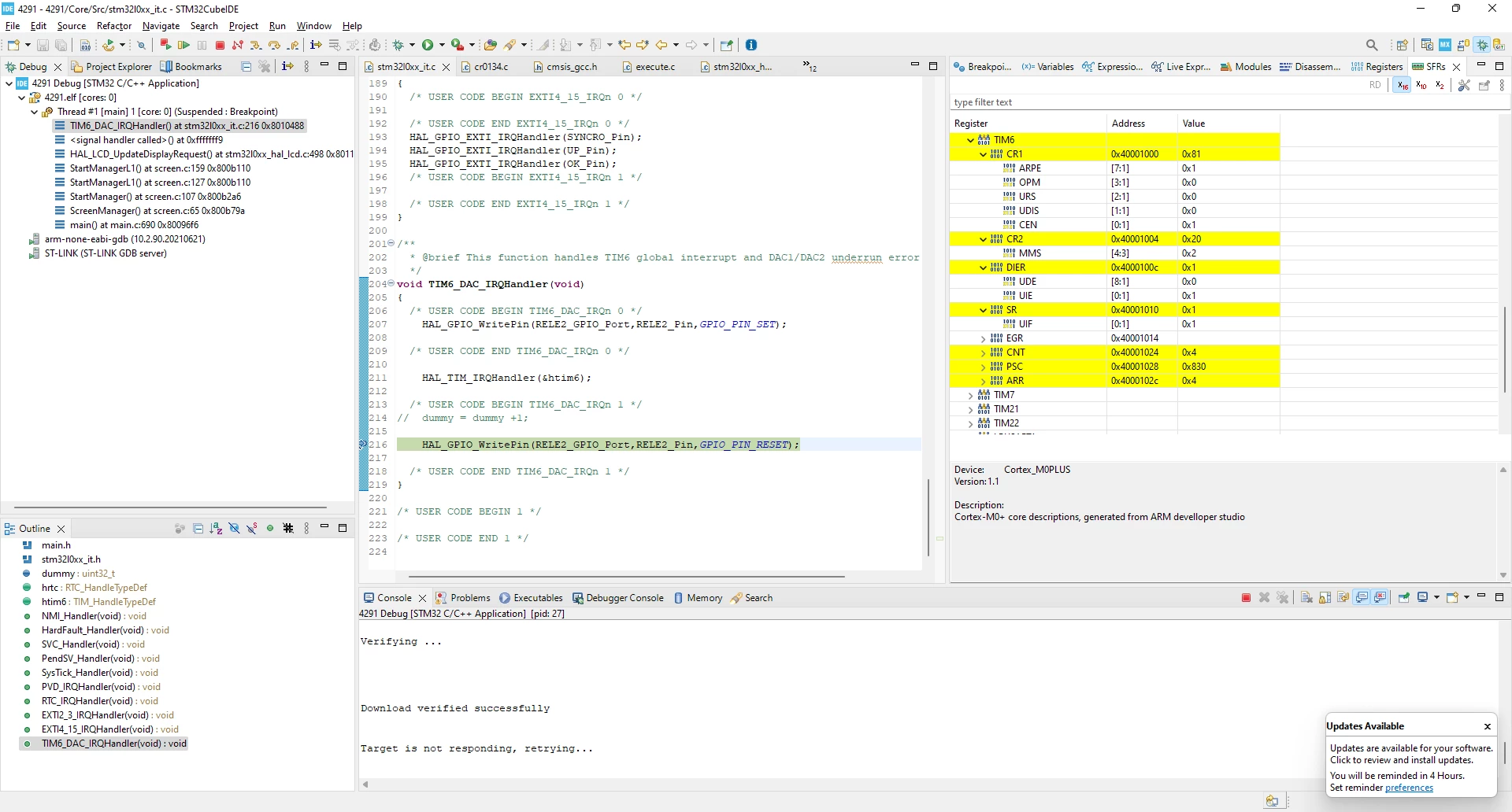

I have a project (for STM32L0) that use TIM6 to generate an Interrupt every 5ms and everything works perfectly both in release and debug when built wih no optimization.
Then I built the same project with -Os(optimize for Size) -ffunction-section -fdata-section and -WI, --gc-section (Discards the unused sections) and the project works no more.
The reason is that the application spends almost all the time in the Interrupt of TIM6.
(The programs enters TIM6 Interrupt, every 50us)
Here' s a scheme of the interrupt
void TIM6_DAC_IRQHandler(void)
 /* USER CODE BEGIN TIM6_DAC_IRQn 0 */
 /* USER CODE END TIM6_DAC_IRQn 0 */
 HAL_TIM_IRQHandler(&htim6);
 /* USER CODE BEGIN TIM6_DAC_IRQn 1 */
// dummy = dummy +1; // explained bellow
 /* USER CODE END TIM6_DAC_IRQn 1 */
The following is part of the HAL:
void HAL_TIM_IRQHandler(TIM_HandleTypeDef *htim)
 /* TIM Update event */
  if (__HAL_TIM_GET_FLAG(htim, TIM_FLAG_UPDATE) != RESET)
    if (__HAL_TIM_GET_IT_SOURCE(htim, TIM_IT_UPDATE) != RESET)
    __HAL_TIM_CLEAR_IT(htim, TIM_IT_UPDATE);
     HAL_TIM_PeriodElapsedCallback(htim);
// My callback
void  HAL_TIM_PeriodElapsedCallback()
Beyong the TIM6 interrupt I have other interrupts as well but when built with optimization
I discover that HAL_TIM_IRQHandler() is called continuosly but not my callback as if
TIM_FLAG_UPDATE is always cleared ( So why the handler is get called ?)
There's no way to sort out the things: no clear pending interrupt, no memory barriers ( I saw someone who solved similar problems with that).
It's not a time issue 'cause I set a lot of NOP and nothing changes.
The only one solution I found is to put a dummy instruction like the one commented in the code above. That solved my problem but I can't explain why.
Can someone can explain why or has a better solution ?
Thanks
Marco V.

Use bisection to limit areas with are and are not optimized.
Watch for things that need to be volatile, but aren't.
Review a disassembly, follow the code that the MCU is actually executing, relate that to you expectations and the C code.
Check the TIM's SR see what's actually flagging.
The dummy increment (rmw) forces bus transactions to complete. The code shown however is not illuminating.

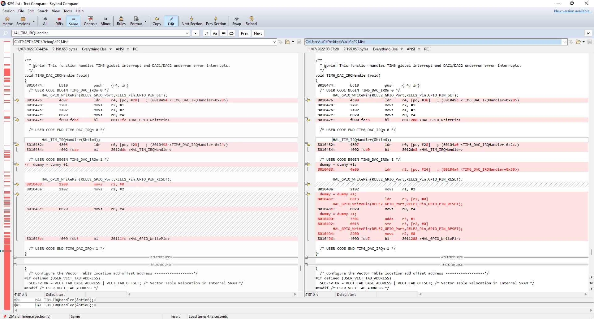

I compare the two listings: on the left thye one without the dummy write; on the right with the instruction: dummy = dummy+1
I agree with you that the only difference is that the dummy instruction forces a read and write operation on the bus memory. I'm more and more convinced that is not a problem of timings
But I also declared
void __attribute__((optimize("-O0"))) TIM6_DAC_IRQHandler()
and nothing changed
Marco V.

Show us all TIM6 registers content.
Any other TIM interrupt​ enabled besides TIM6 Update?
​Optimized code with 5ms tick runs OK?
JW​

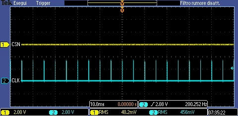

MVill.6
MVill.6Author
July 11, 2022
Thanks Everybody
I checked with the scope and the timings are OK when I put the dummy instruction
I'm going to compare the two listings: with and without the dummy write

Maybe but you should explain to me why a long sequence of NOT has no effect and a stupid R/W operation involved the memory solve the problem.
