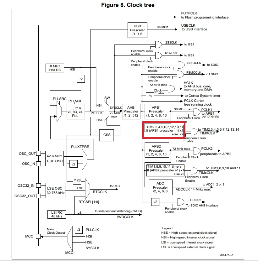

TIM6 APB1 prescaler
STM32F103RB microcontroller.

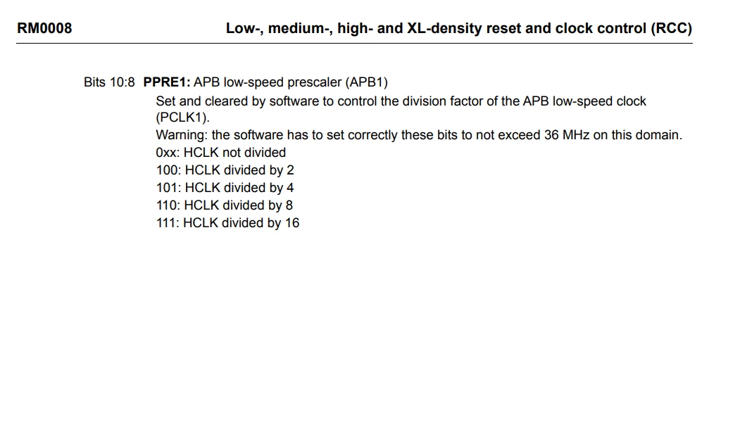

The Figure1 (see attached image) shows clock tree of STM32F103RB microcontroller. Before TIM6CLK, there is a block, which is highlighted in red rectangle. What's IF (APB1 PRESCALER  = 1) x1 ELSE x2 label in this red rectangle? APB1 prescaler can't equal to  "1". APB1 prescaler can be in states listed in the Figure2 (see attached image).

Value divided by 1 = Value so it's not divided. A clock divided by 1 keeps the same frequency on the output prescaler -> frequency not divided.

APB1 PRESCALER  = 1 ->  "Not divided" which is the first value (0xx).
Aug 23, 2024 12:19 PM UTC
Why is this (IF (APB1 PRESCALER  = 1) x1 ELSE x2)  shown so strangely in the clock tree diagram?
