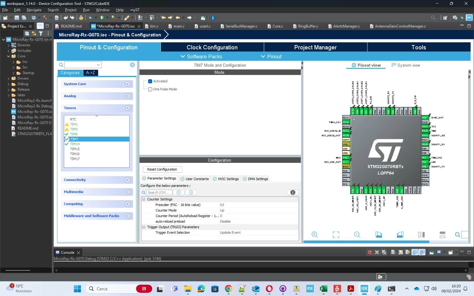

TIM6 and TIM7 identical, the interrupt is working for TIM6 and not for TIM7
I added TIM7 to application and configured it the same way TIM6 was.
I need to use two timers for my app, code contains all the same setups for TIM6 and TIM7, except for the timer expiration counters, and I observe that the callback
void HAL_TIM_PeriodElapsedCallback(TIM_HandleTypeDef *htim)
never enters in the conditional block it contains:
if ( htim == &htim7 )
/* code block */
the callback above is invoked when htim == &tim6.

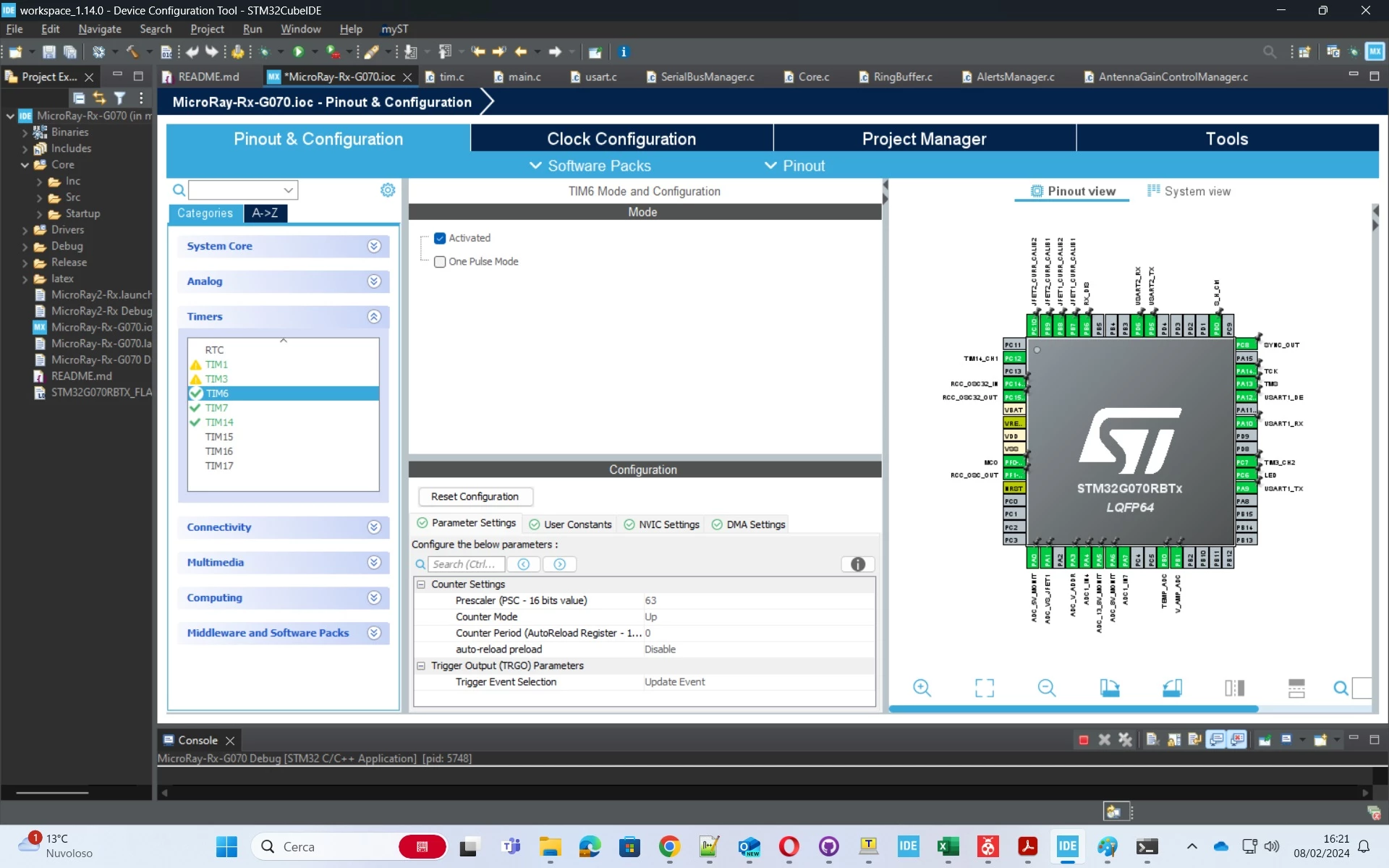

The timers setup are:tim6.jpgtim7.jpg
Please help, I double checked all I could without finding a solution

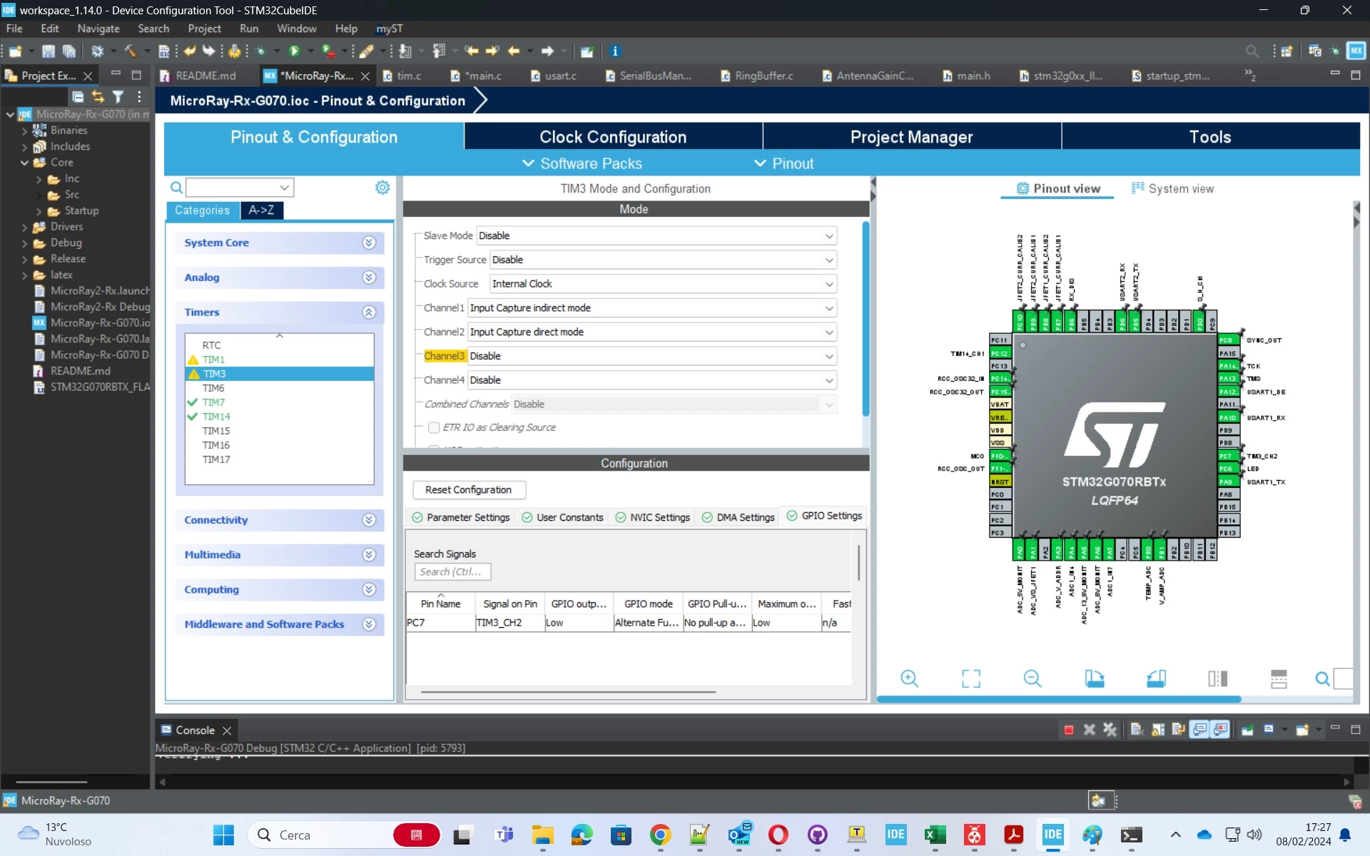

Beppe101Author
Feb 8, 2024 4:21 PM UTC
tim3.jpgHi,
the app works correctly with timers TIM3, TIM6, TIM14 together. I add TIM7 and TIM7 doesn't work as expected no matter if TIM6 is present or not. TIM14 used for PWM generation does not fire callback above. TIM3 has 2 channels for input capture and it fires the callback that does nothing with TIM3.

Feb 8, 2024 4:43 PM UTC
Are you starting TIM7?
Not really providing the full picture of the problem. Consider attaching your main.c at the least.

Pavel A.
Feb 8, 2024 4:50 PM UTC
Have you added the TIM7 ISR handler in your  stm.....it.c file?
