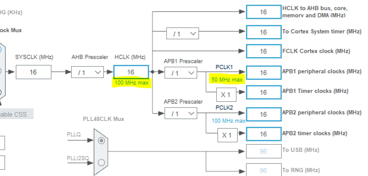

waclawek.jan
July 19, 2023
Which STM32? How are clocks set up?
> the value are not valid anymore 2001148 instead of 100096566 (aka ~1 second).
You use a prescaler to supposedly change the main TIM clock to 1MHz, don't you. So why would 100'000'000 be the expected count for 1 second? Wouldn't that be 1'000'000?
Your first observation is related to the fact that prescaler is preloaded. That's why also the count at overflow was somewhere in between - up until the overflow the timer run without the prescaler and from the overflow it run 50x slower.
Your second observation (i.e. that after PSC is loaded either through natural overflow (=> Update) or forced Update through setting TIMx_EGR.UG) the 1 second count is 2'000'000 instead of expected 1'000'000 is due to the fact, that timers' clocks in most STM32 is two times the APB clock, if APB divider is not 1.
July 20, 2023
We are using STM32F412.
I am new to STM32F412, how can we set APB divider to 1 or to the right value. I made a patch dividing the value by 2 but I would like to make a real fix to the problem.

July 20, 2023
The cpu clock rate is typically higher than the peripheral clock rates because they often can't run as fast as the cpu. But you can adjust your clock settings if that's what you want. Otherwise, the x2 factor isn't a bug and isn't something that needs a fix. It's how the chip works.
waclawek.jan
waclawek.janBest answer
July 20, 2023
As TDK said above, it's not a problem, simply take it into account and make the prescaler twice as big (more precisely,  ((HAL_RCC_GetPCLK1Freq() / 1000000) * 2) - 1; ).
