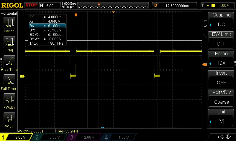

TIM4 is a master, TIM3 is a slave. Given the same values I expected their respective CCx IRQ to fire at about the same time.
Set up TIM4 to generate a hsync pulse of 2us
	RCC_APB1PeriphClockCmd(RCC_APB1Periph_TIM4, ENABLE);
	TIM_Cmd(TIM4, DISABLE);
	TIM_TimeBaseInitTypeDef timerInitStructure;
	timerInitStructure.TIM_Prescaler = 0;
	timerInitStructure.TIM_CounterMode = TIM_CounterMode_Up;
	timerInitStructure.TIM_Period = LINEPULSE;
	timerInitStructure.TIM_ClockDivision = TIM_CKD_DIV1;
	timerInitStructure.TIM_RepetitionCounter = 0;
	TIM_TimeBaseInit(TIM4, &timerInitStructure);
	TIM_OCInitTypeDef outputChannelInit;
	TIM_OCStructInit(&outputChannelInit);
	outputChannelInit.TIM_OutputState = TIM_OutputState_Enable;
	outputChannelInit.TIM_OutputNState = TIM_OutputNState_Enable;
	outputChannelInit.TIM_OCPolarity = TIM_OCPolarity_Low;
	outputChannelInit.TIM_OCNPolarity = TIM_OCNPolarity_High;
	// channel 1 is hsync (active low)
	outputChannelInit.TIM_OCMode = TIM_OCMode_PWM1;
	outputChannelInit.TIM_Pulse = HSYNCPULSE;
	TIM_OC1Init(TIM4, &outputChannelInit);
Scope trace looks as expected:
0693W000007YzcbQAC.pngSet up TIM3 to be a slave to TIM4 with the same period as TIM4

TIM3 IRQ handler toggles a GPIO line (magenta trace) on TIM_IT_Update
Q1: Why is there a delay between TIM4 Update and Tim3 Update? I expect TIM3 being a slave would be very close to when TIM4 starts a new period - ie falling edge of hsync pulse.

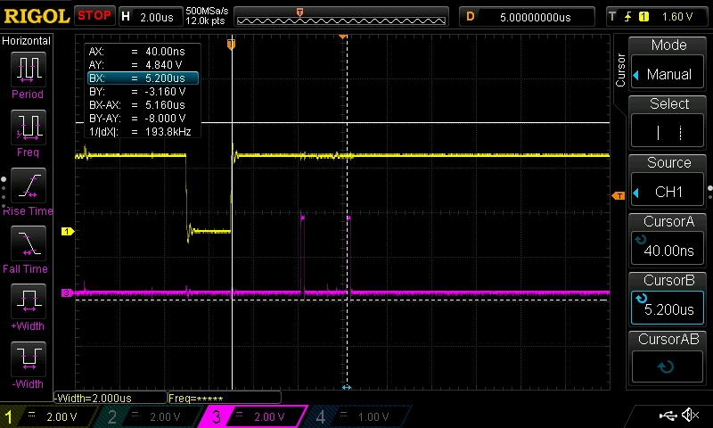

Now I also enable the TIM3 CC1 IRQ as well as Update IRQ and get this:
0693W000007YzclQAC.pngYou can see the CC1 IRQ gets generated a little before the Update IRQ (as expected)..but..
Q2: TIM3 CC1 has the same Pulse value as TIM4, but the IRQ is much later..I expected TIM3 to be pretty much in phase with TIM4
5 replies
Elektraglide
February 20, 2021
[Answering my own question for anyone reading this later that find its useful]
I noticed that slave pulses were always around 30 CPU cycles later than master. Looked at the code I spotted that TIM3 was ENABLEd about 20 odd instructions before TIM4 was ENABLEd.
Enable them both at the same time and its perfect.
Doh.

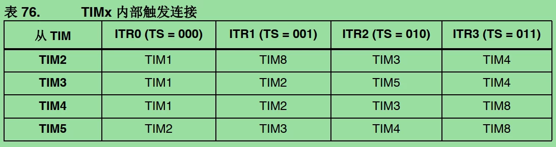

Thanks. However, if I do not ENABLE TIM3 explicitly, setting TIM3 to TIM_SlaveMode_Trigger, I get no TIM3 IRQs at all.
I was expecting TIM4 to trigger TIM3 countup..
waclawek.jan
February 21, 2021
Read my answer carefully.
Read out the timers' register content and check.
Elektraglide
February 21, 2021
Keep getting caught out by the non-orthogonal functionality on these devices!
In this case, TIM4 triggers TIM3 not on ITR0 but only on ITR3. Found this handy map on a website (subsequently found it on p401 of RM0008)
