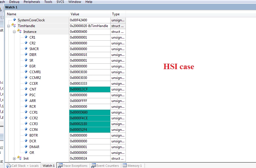

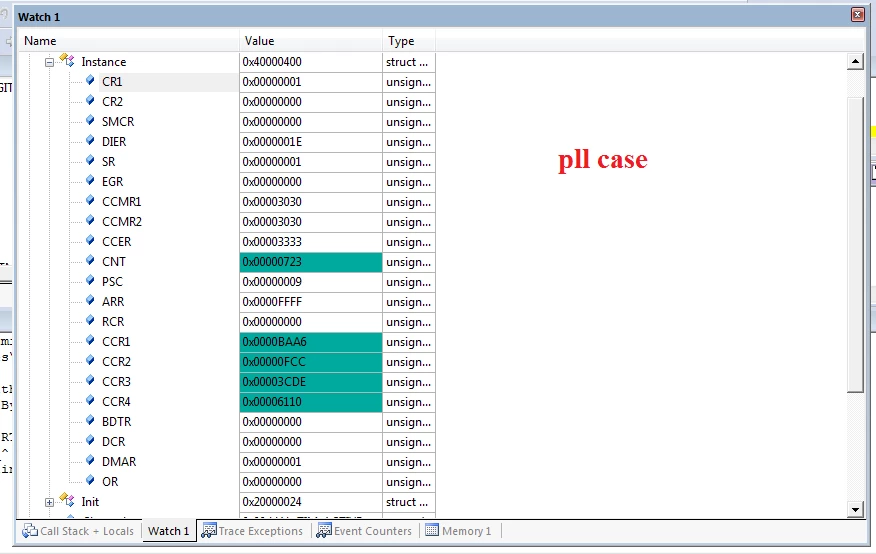

Thanks for the reply . here is a screenshots of register details .
waclawek.jan
April 17, 2018
Posted on April 17, 2018 at 18:23
There are multiple problems: ARR is 0xFFFF i.e. timer period is maximum possible; pulses lengths is also not what you described, and the output compare mode is Toggle not PWM.
As 16000000Hz/65536=cca 244Hz, with toggle mode it makes sense the output is 122Hz 50% pulse train.
This could not have worked at 50kHz at the PLL setting either.

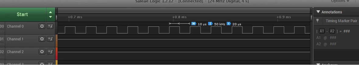

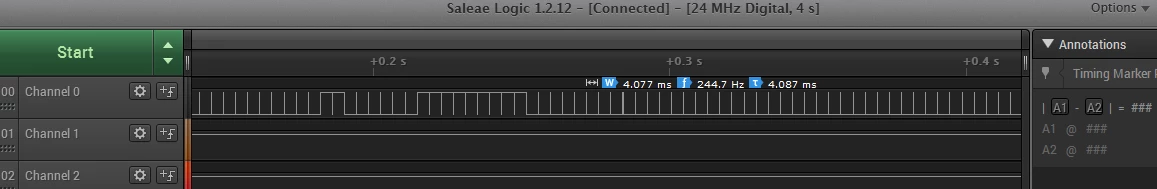

Is highest value possible , but the timer is configured to toggle the channel when it meets with CCR1 . and CCR1 is updated as below .
* @brief Output Compare callback in non blocking mode
* @param htim : TIM OC handle
* @retval None
void HAL_TIM_OC_DelayElapsedCallback(TIM_HandleTypeDef *htim)
/* TIM3_CH1 toggling with frequency = 195 Hz */
if(htim->Channel == HAL_TIM_ACTIVE_CHANNEL_1)
uhCapture = HAL_TIM_ReadCapturedValue(htim, TIM_CHANNEL_1);
/* Set the Capture Compare Register value */
__HAL_TIM_SET_COMPARE(&TimHandle, TIM_CHANNEL_1, (uhCapture + uhCCR1_Val));
it is indeed working with PLL . you can see the output below pll vs HSI

Ah, that's because with the much slower system clock the time between the output compare and the moment when you change CCR1 is longer than
uhCCR1_Val. In other words,
at the moment when you change CCR1, CNT is already higher than the new CCR1 value, thus the compare happens only when CNT overflows and reaches the value in CCR1 again.
