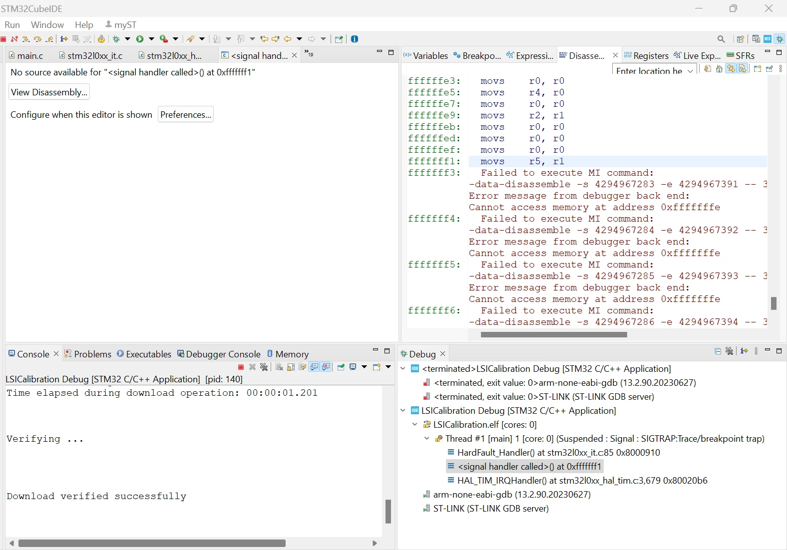

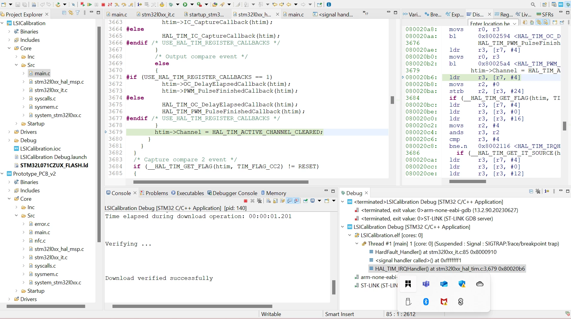

TIM21, INPUT CAPTURE mode, System clock at 2Mhz or below caused hardfault?
Hi ,
I am using TIM21 in input capture mode to measure the LSI frequency (~37 kHz). However, when I set the TIM21 clock to 2 MHz or use the MSI clock, it causes a hardware fault when attempting to capture the LSI frequency.
I have reviewed the STM32CubeL0 example code for RTC_LSI, which uses an MSI clock set to 2 MHz to measure the LSI frequency successfully. However, in my case, this setup does not work, and I am not sure why.
Thanks!

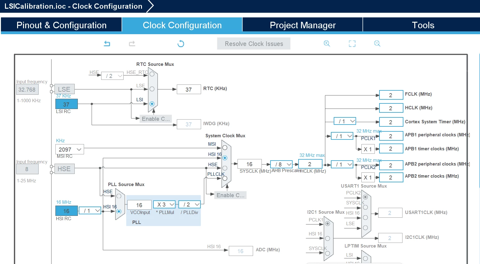

This is my clock configuration:
My timer21 configuration:
/* USER CODE END TIM21_Init 1 */
 htim21.Instance = TIM21;
 htim21.Init.Prescaler = 0;
 htim21.Init.CounterMode = TIM_COUNTERMODE_UP;
 htim21.Init.Period = 65535;
 htim21.Init.ClockDivision = TIM_CLOCKDIVISION_DIV1;
 htim21.Init.AutoReloadPreload = TIM_AUTORELOAD_PRELOAD_ENABLE;
 if (HAL_TIM_Base_Init(&htim21) != HAL_OK)
 Error_Handler();
 sClockSourceConfig.ClockSource = TIM_CLOCKSOURCE_INTERNAL;
 if (HAL_TIM_ConfigClockSource(&htim21, &sClockSourceConfig) != HAL_OK)

waclawek.jan
October 4, 2024
Timers as such don't cause hardfaults. It's your code which hardfaults, and that includes any "library" you use (Cube/HAL).
Debug as usually with hardfaults, i.e. get the stacked PC content and in disasm (best mixed with source) observe instructions before that address to find out which instruction caused the fault and why.

Tesla DeLorean
Guru
October 4, 2024
Look at the instructions that are faulting, and the registers in the MCU
Check SP is within expected scope and properly aligned.
Have a Hard Fault Handler that prints out the details.
You don't scope the incrementing pointer into a finite array
The value for R7 probably exceeds the bounds of RAM, you'd have to look at it to know
waclawek.jan
October 4, 2024
There is no single good guideline as there are infinite ways how things can go wrong.
The IDE you are using automatically unwinded the stack, so you don't need to look at the stacked PC etc. However, the "signal handler called at 0xfffffff1" line is slightly bogus and there's no point to try to look at disasm there, the real error points to the address in first screenshot (0x0800'20b6).
At this point we would also need to look at the fault registers to find out the exact nature of the error in the fault status registers (SCB_xFSR), and also content of processor's registers - for example, the pointed instruction ldr r3, [r7, #4] (read: into r3 load a word from address given by register r7 plus a constant 4), might have failed if r7 points to invalid address, which - looking at corresponding C source - would mean that the pointer in variable htim is incorrect (so then you'd look at that variable).
But the error might've been also imprecise, which means that it happened in some previously executed instruction, for example a store to invalid address is usually imprecise, as stores are not performed immediately but they go to a buffer at the memory interface of the processor, which will may perform the actual store to the actual memory/peripheral a couple of cycles later if the bus is occupied (and processor executes other instructions meantime). This means that you would need to "walk back", in this case, you'd need to look at the last few instructions of whichever callback was used, and again, check the relevant registers to find out if their content might have lead to the error in question.
At this point, you can also take a step back, and as the callback may be suspicious, look at what happens there. For example, I see you are incrementing an index to an array which you are writing into tmpCCTIM_CHANNEL_1[uwCaptureNumber++] , and I don't see where would that index be constrained/checked against array size/zeroed, potentially thrashing other variables or even the stack.
chai2145Author
October 4, 2024
Yes, By right the timer interrupt will stop after get 2 LSI edge from the code below. However If I using 2Mhz clock source , it seems like it cannot stop the interrupt and the interrupt keep coming (tmpCCTIM_CHANNEL_1[uwCaptureNumber++]) also keep increasing untill hardfault occured. It works correctly if I using 4Mhz clock and above. I have no idea but the STM32CubeL0 example code for RTC_LSI, which uses an MSI clock set to 2 MHz.
I find it so hard to find the reason why t.t

waclawek.jan
October 4, 2024
At 2MHz system frequency and 37kHz LSI=interrupt frequency there are only 54 cycles per interrupt, that's an unreasonable expectation even if it would be written optimally.
Using Cube/HAL together with no compiler optimization results in lengthy interrupt service routine (ISR), hundreds or even low thousands of cycles.
In other words, as soon as you enable the interrupt, it simply tail-chains itself forever, or, in your case, until writing to the array reaches and overwrites the stack upon which it falls to the hardfault.
With this combination of clocks, you can't use interrupts to capture every LSI edge, you have to use some other methodology, e.g. using DMA instead of interrupt together with the input capture; or using two timers, one to count LSI cycles and other to count system clock cycles, and use some mechanism to compare the two.
mbrossettBest answer
October 4, 2024
@waclawek.jan He is using an input presacler of 8 which helps some (432 cycles instead of 54), but I agree with you that this would be a good use case for the DMA if he must use a 2MHz clock.
@chai2145 You could try reducing the execution time of the ISR to alleviate the problem somewhat by shutting off the timer in the interrupt and moving your calculations to the GetLSIFrequency() function...

chai2145Author
October 5, 2024
Hi @mbrossett , I have also tried your solution, stopping the timer interrupt after receiving two LSI clock edges. Unfortunately, the frequency obtained is not correct and is much higher than the LSI frequency. I am getting around 200 kHz. I think something is messed up between the timer clock and system clock. Only can use frequency higher than 4Mhz. I'm curious why the ST using MSI 2Mhz in their sample code is working correctly. The reason why I,m using 2Mhz is because I would like to implement a low power application, therefore I keep my system frequency low.
October 5, 2024
You need to start the base timer before you start the input capture…
if(HAL_TIM_Base_Start_IT(&Input_Handle) != HAL_OK)
 Error_Handler();
if(HAL_TIM_IC_Start_IT(&Input_Handle, TIM_CHANNEL_1) != HAL_OK)
 Error_Handler();
