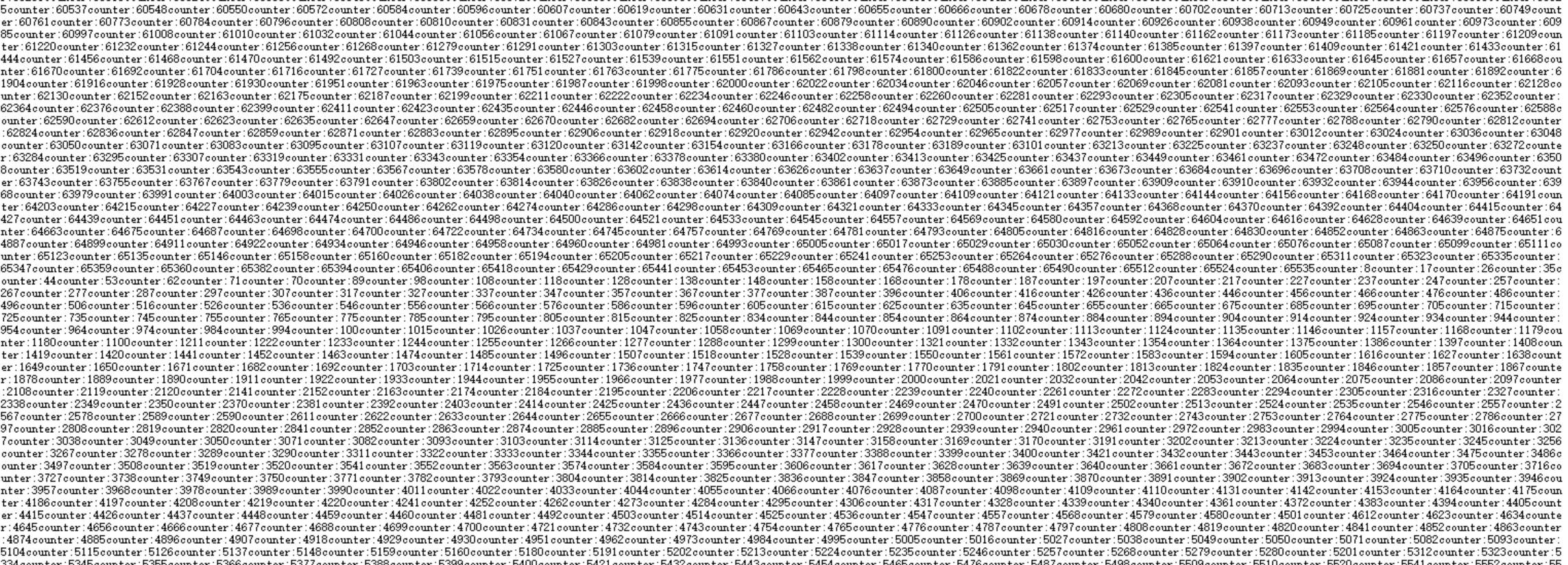

Perhaps look at and show the code that's running on the part.
The generated code and the print output routines will be far more informative as to why it's not working as expected.
Definitely 32-bit, inspect registers with debugger.

Ok, thank you. Here I'll ask my friend about the code that runs in this part.
In this case, it doesn't necessarily mean the sector has gone bad, does it

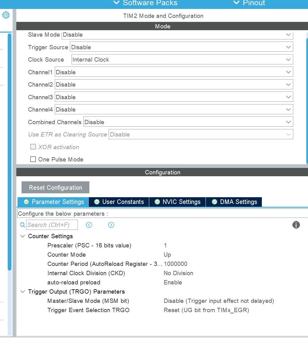

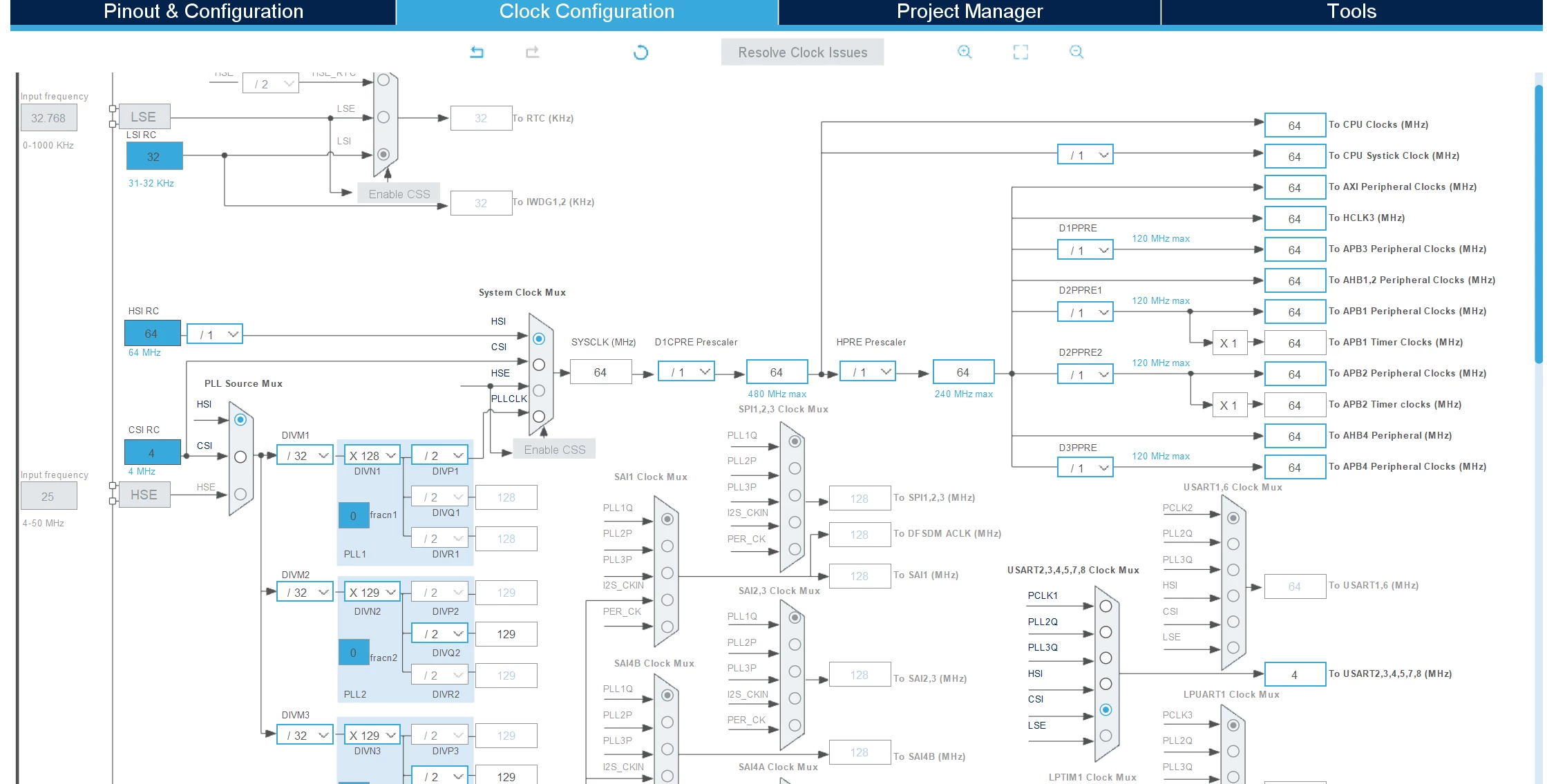

Show the generated code, the configuration screens aren't helping me understand the source of the problem.
Make sure you're not reading the TIM2->CNT value into a smaller variable and truncating.
