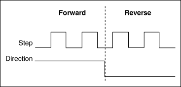

I am trying to configure the TIM2 to act as an up/down counter as describe in Encoder mode 1 or 2. I have the circuit set up to connect PB8 to a count signal and PB9 as a direction signal. I have am having an issue where randomly after an NVIC_Reset the count direction is different dispite the value on PB9 being the same. The itnitialization code is below:

What could cause the system to behave differently given the same inputs? Is this the correct configuration? The stack overflow link in the code suggests that it is for some configuration.

    The STM32 timers don't have a 'direction-count' interface/mode, so I wonder how your input signals look like, exactly.
    Any 'scope or LA waveforms to show us?

    Sorry for the delay in response. The waveforms look like you would expect:
    The code above works consistently but at some point the counter starts countingin a random direction at boot.
