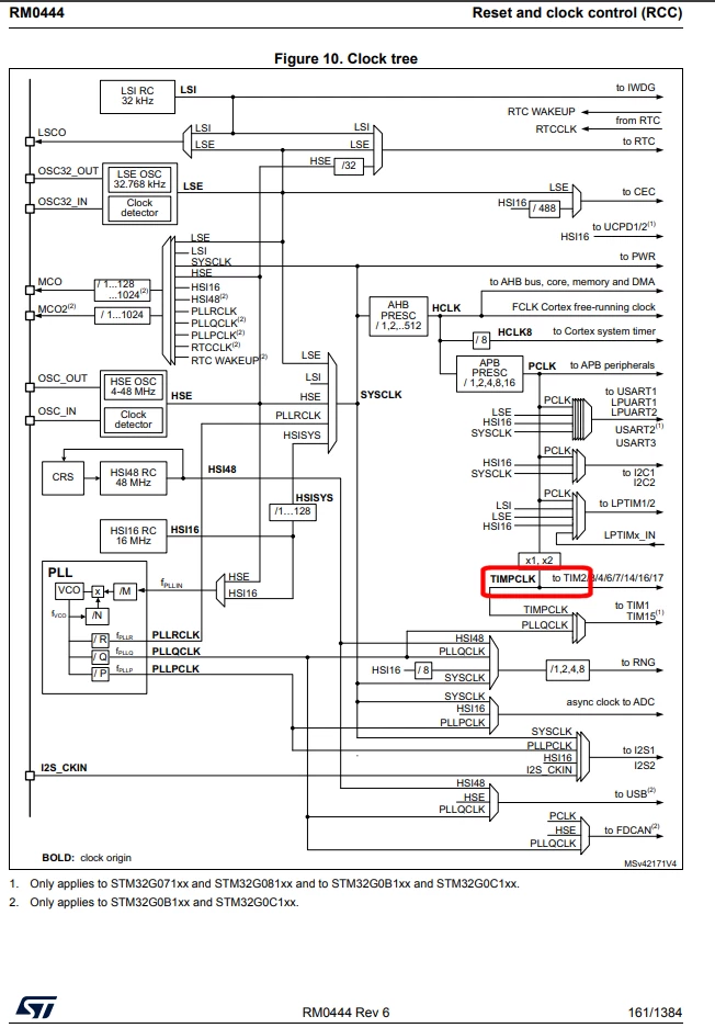

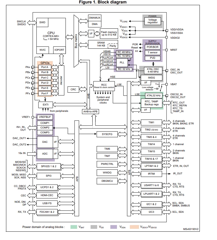

I have an stm32G0B1 that i'm working on. I want to use a timer "TIMER2" but the block diagram of the board doesn't not give the AP2B2 clock bus. I know with other boards is usually mentioned. Where do I go to look for it, as I have looked and I struggle to find it.

Is it using HSI16? that's what  confuses me .

@Marrkinho wrote:
Is it using HSI16?
Trace it through the diagram
waclawek.jan
July 29, 2025
It uses whichever primary clock source you've selected for SYSCLK, divided by the AHB prescaler and the APB prescaler (and optionally multiplied by 2 if APB divider is 2 or higher).
