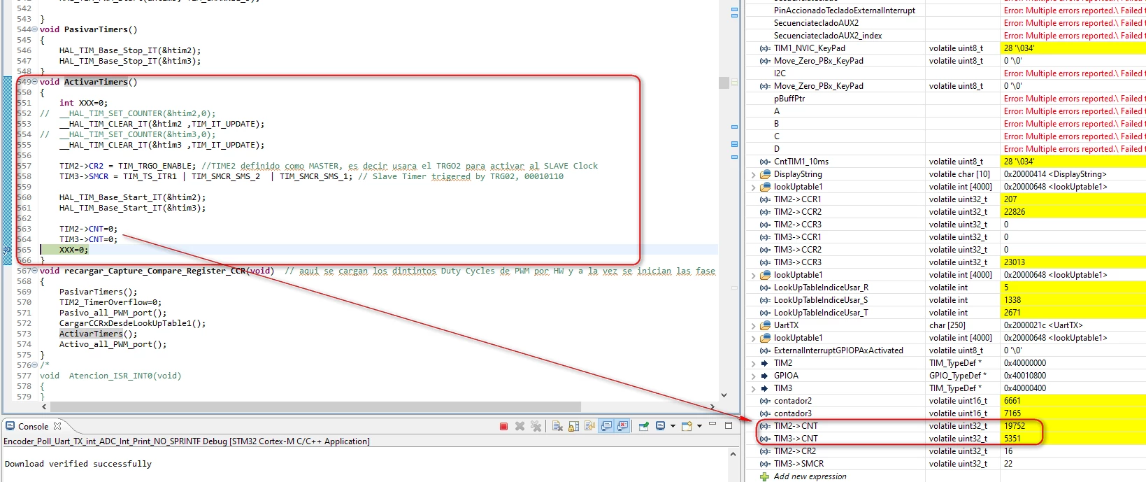

I was testing some options, but I couldn´t move forward.......In order to SYNC (as much as possible) I set Master, Slave and CNT registers in both TIMs, so after that I defined a Breakpoint in order to check if **** are same or almost the same, but CNT from TIM2 and TIM3 are not the same, there are running not tight as I expected..
I was reading RM008 14.3.20 Timer synchronization and wrote the following lines in order to set TIM2 as Master and TIM3 as Slave (as I explained above, and it is not working)

TIM2 and TIM3 are defined using CUBEMX, both timers have the same configuration at this point (setup time), but later when the program is running, when the Overflow interruption on TIM2 happened, I stop timers TIM2 and TIM3, define Master and Slave and Set **** to 0 (I am setting Master and slave every time overflow happened, I know it is not ok, but as I am just testing if clocks are working together, I guess, is not a big issue,
later I will move it outside of the loop, but I did that just to see how the clock is set when Debugger is fired just after set (manually) CNT registers to 0, STM32CUBE debugger shows TIM2/3 **** values are NOT equal...Here is a small list of 4 tests (using RESSUME button in Debug mode).

The value of **** shows me that TIM2 and TIM3 are not working in SYNC mode.... test N°2 show that TIM2 CNT is = 19636 and TIM3 CNT = 20811, when TIM2 CNT is set to Zero before TIM3 CNT....I know, Timers are not set correctly,

Reading register values in the debugger is not a viable strategy for checking if they're synchronized. First, the timers do not stop by default when the debugger is paused. Second, the debugger is not reading them at the exact same time. In the case of fast timers, there is no hope they will be equal.
A better strategy would be to set up a PWM signal on both timers and verify on scope they put out the same signal.
If you want two timers exactly synchronized, set both of them in slave triggered mode set to start on the TRGO signal of a master timer, then start the master timer. There are other ways, but that one is straightforward. If you can live with a few counts difference, then setting CNT=0 in sequence like you're doing will suffice.
