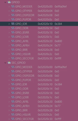

dlewisAuthor
Apr 23, 2025 6:49 PM UTC
Hi, apologies again for a late response. Here is the register values for GPIO port D.
waclawek.jan
Apr 28, 2025 4:43 AM UTC
According to the STM32H562 datasheet, there is no TIM13 nor TIM14 pin at GPIOD.

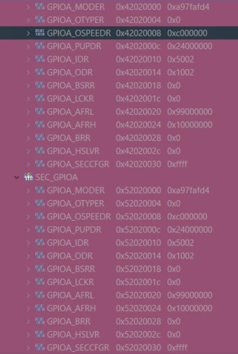

dlewisAuthor
Apr 29, 2025 6:03 PM UTC
My apologies, I was looking at the port for the wrong PWM peripheral pin I was using. Here is the port values for GPIOA which should be the correct port.

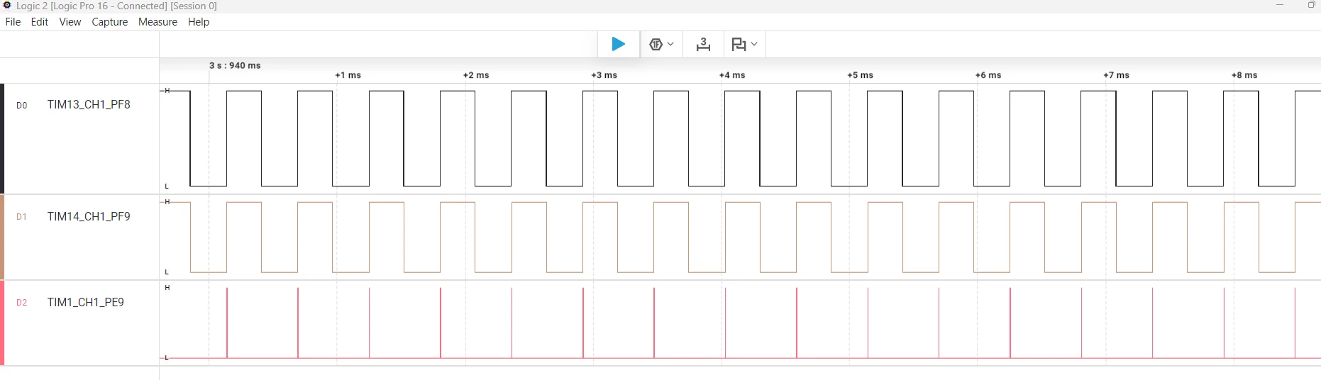

This is a test involving TIM13, TIM14 and TIM1 channel 1.
Best Regards
Younes

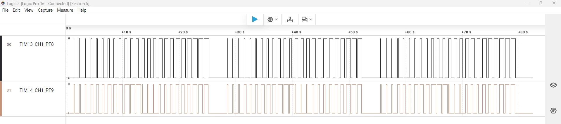

Apr 30, 2025 6:47 PM UTC
Hi @dlewis
I started from 0 as pulse period as you suggested, then I changed the periods for TIM13 and TIM14 as follow in accordingly in the while(1).
 MX_GPIO_Init();
 MX_TIM13_Init();
 MX_TIM14_Init();
 /* USER CODE BEGIN 2 */
 HAL_TIM_PWM_Start(&htim13, TIM_CHANNEL_1);
 HAL_TIM_PWM_Start(&htim14, TIM_CHANNEL_1);
 /* USER CODE END 2 */
 HAL_Delay(4000); /* no output signal as pulse = 0*/
 while (1)
 period1 = (period1 + 100) % 900;
 sConfigOC.Pulse = period1;
 HAL_TIM_PWM_ConfigChannel(&htim13, &sConfigOC, TIM_CHANNEL_1);
 period2 = (period2 + 200)%900;
 sConfigOC.Pulse = period2;
 HAL_TIM_PWM_ConfigChannel(&htim14, &sConfigOC, TIM_CHANNEL_1;
 HAL_Delay(3000); /* delay to follow changes*/
 } /* while 1*/
 /* USER CODE END 3 */
 I can see that the wide of the pulse is changing using a logic analyzer.
Can you add the other timers and check if there is any issues?
Best regards

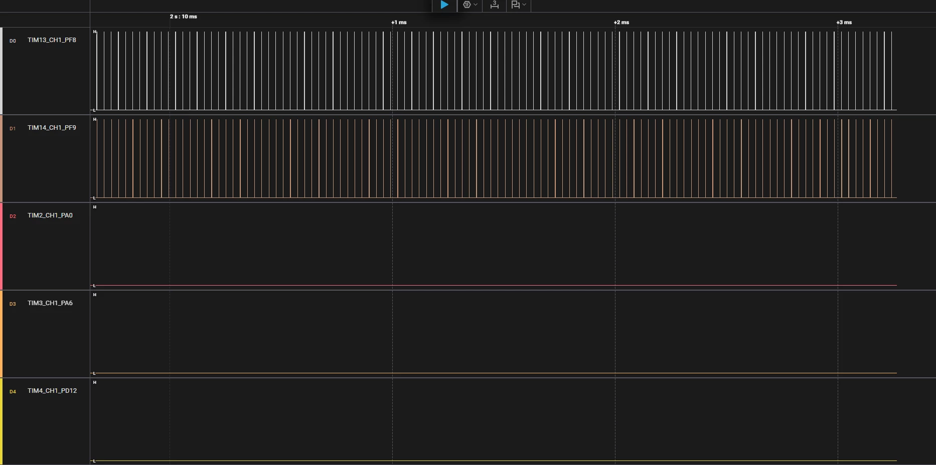

dlewisAuthor
May 14, 2025 8:15 PM UTC
Hi @CMYL
I tried using a similar method to you by ignoring the rtos and manually controlling the PWM of TIM13 and TIM14 in the main while(). This successfully demonstrated PWM for the 2 problematic pins as visible on the connected RGBW LED on our pcb. This seems to be consistent to me with the fact that those 2 pins could be toggled as GPIO outputs to turn on the LEDs, but the issue still persists where those 2 pins alone do not output any PWM when being used in an application where all of the other PWM peripherals are also being used.
I am going to try manually adjusting the order of timer configurations and also give tim13 and tim14 an initial pulse length using the IOC gui to see if that makes a difference for some reason.
Any other advice or feedback would be appreciated! I can share more of my code if that would help debug as well. Thanks!

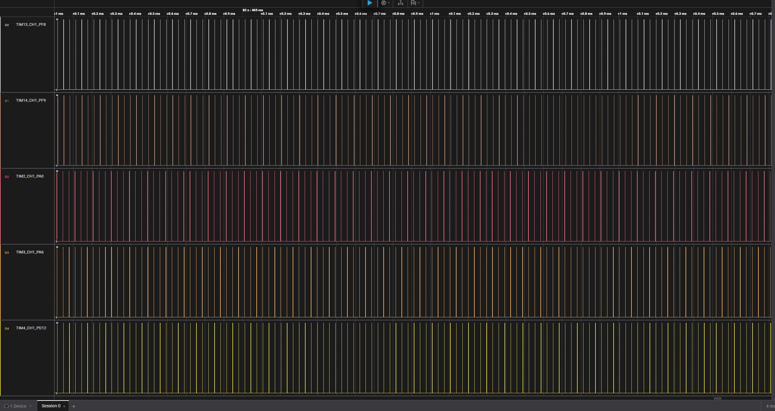

May 15, 2025 1:43 PM UTC
Hello @dlewis, I tested the PWM output of all five timers simultaneously using a Nucleo-H563, and everything appears to be functioning correctly on my end:
When I tried using only TIM13 and TIM14 outputs, I encountered an issue where only the second timer initiated with HAL_TIM_PWM_Start was generating an output. However, rearranging the order of instructions—starting PWM TIM14 before TIM13—resolved the problem!
then, when I reverted to the original order (starting TIM13 before TIM14) it continued to work, which is quite puzzling!
It would be interesting if you could try this on your end! while I try to further investigate the order behavior.
Thank you
dlewisAuthor
May 19, 2025 6:30 PM UTC
Hi @Sarra.S
I tried rearranging the order of which HAL_TIM_PWM_Start is used for each instance/channel and this did not seem to make any difference in results for me.
