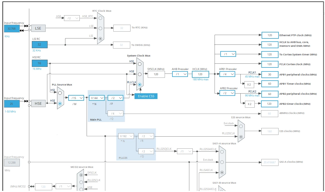

I'm interested in using Timer 1 on my STM32F439ZI to decode the quadrature signal from an encoder but TIM1->CNT doesn't appear to change. I'm not sure what is missing, the TIM1 config looks like:

and the *** config is like:
And I'm just trying to read a value from the timer with (encoder_previous is a uint16_t):
if (TIM1->CNT != encoder_previous) {
 encoder_previous = TIM1->CNT;
which is located in the infinite loop in the StartDefaultTask function but it does not appear to change ever. Does the timer need to be started after initialization or am I missing something in my config?
Thank you!
Sarra.SBest answer
April 23, 2024
Hello  @debug, sorry for the delayed answer,
I assume you're starting the timer and enabling the clock for TIM1 in the RCC
Maybe check that the encoder signals are reaching the timer, and check the hardware connections with an oscilloscope!
