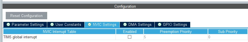

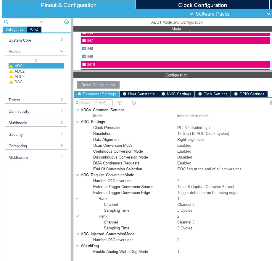

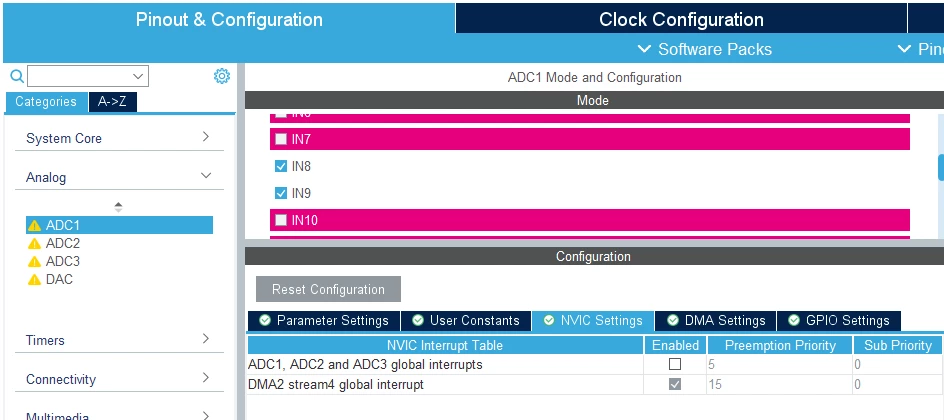

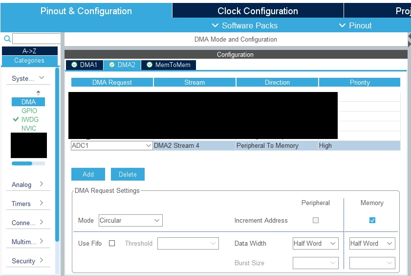

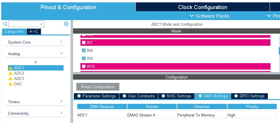

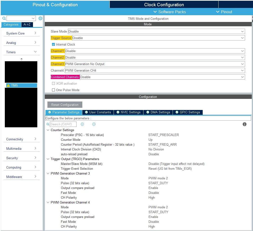

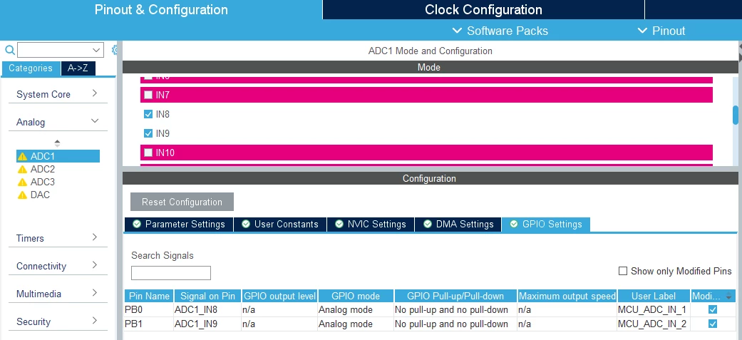

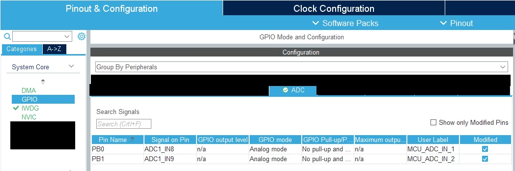

I'm trying to do a periodic ADC capture on 2 channels, triggered by TIM5. ADC should output to memory via DMA, with a DMA interrupt upon each completion to read the data from each scan.
So far, the DMA interrupts aren't hitting, and the ADC doesn't even appear to be reading anything. Any ideas what I'm missing?

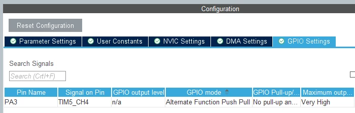

TIM5_CC4 outputs on a GPIO. ADC captures should be synced with that, so I'm trying to use TIM5_CC3 to trigger the ADC.
Code was generated by STM32CubeMX 6.1.1, with STM32F4 package 1.25.2. (MX_DMA_Init() is called before MX_ADC1_Init().)
CubeMX Project Screenshots
Code Excerpts

On further investigation, I see no sanctioned way with the (non-LL) HAL to enable the channels before starting the PWM output.
I'm working around the issue by (ab)using the private function TIM_CCxChannelCmd(). I've replaced
 TIM_CCxChannelCmd(htim5.Instance, TIM_CHANNEL_4, TIM_CCx_ENABLE);
with
 TIM_CCxChannelCmd(htim5.Instance, TIM_CHANNEL_3, TIM_CCx_ENABLE);
 HAL_TIM_Base_Start(&htim5);
EDIT: the DMA interrupts aren't correct yet. The interrupt gets hammered for a while, then isn't called anymore. I think the ADC config isn't correct. But I'm over the main roadblock now.

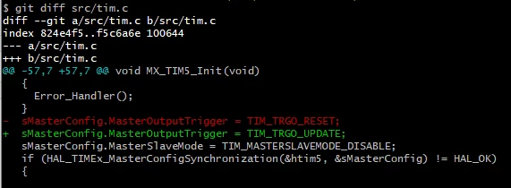

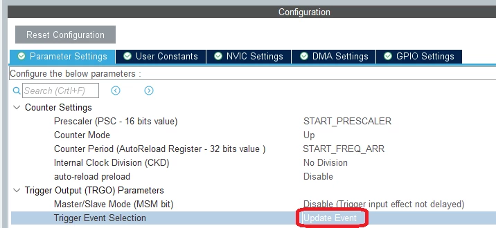

use the timer update event for TRGO, not the reset event.
BMcDo.3
BMcDo.3Author
January 26, 2022
Changed as specified. Problem persists, i.e. HAL_ADC_ConvCpltCallback() still isn't called.
