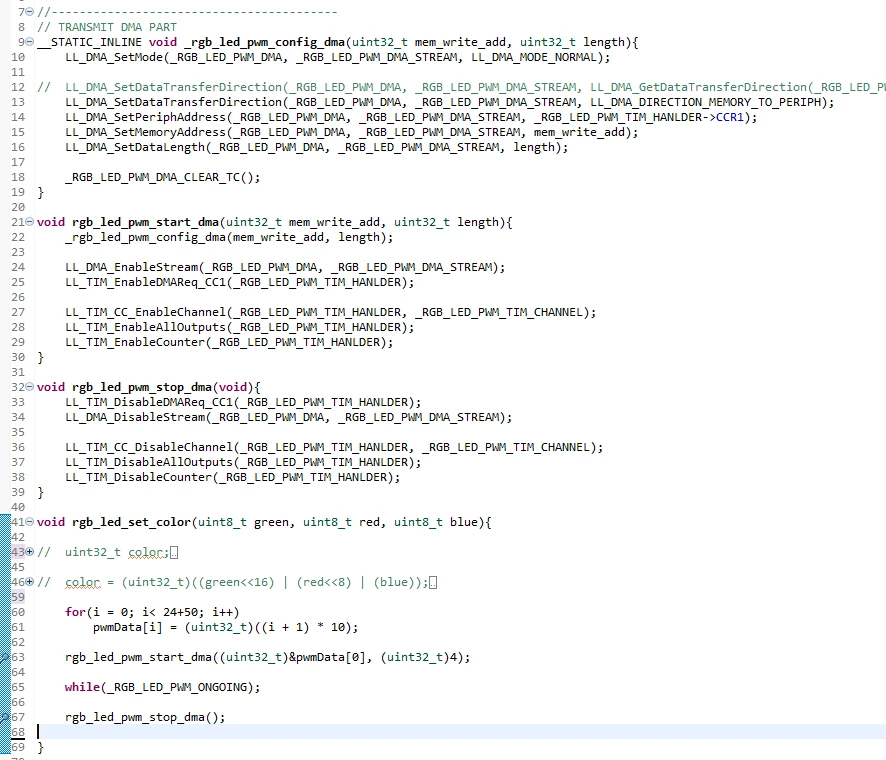

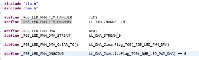

TIM PWM CCR DMA get Transfer error
I am trying to use dma with timer 2 in order to change the dutty cycle of a pwm output in each cycle. However, I get a dma transfer error.

I could solve. I have not referencing correctly the pointer of ccr1
(uint32_t)&_RGB_LED_PWM_TIM_HANLDER->CCR1

Is DMA initialized before ADC?
Is buffer memory accessible to DMA?
Maybe this:
https://community.st.com/s/article/FAQ-DMA-is-not-working-on-STM32H7-devices
waclawek.jan
April 28, 2022
Which STM32?
Read out and check/post content of TIM and relevant DMA registers.
