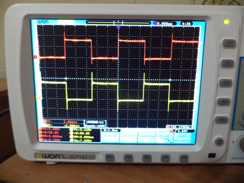

I'm an absolutely beginner in microcontrollers.
I want to create a PWM signal wave signal  to drive main power switch at 100Khz
TIM1CH1&TIM1CH1N of   STM32F103VC.
I change duty (CCR1_Val) but the duty stay same at 50%.
Can anybody tell me what I'm doing wrong?
Thank You
Photo to Attachments
vu16 CCR1_Val = 90 ;

    TOGGLE mode would tend to do that as the Period is effectively doubled, and will be even, ie 50/50
    If you want PWM mode then used that, and not TOGGLE mode

    But that's not a negated signal, I think here you'd need to use two channels and modulate the pulse width between 0 (OFF) and the 25% on alternating channels at the Update interrupt. 100 KHz should be possible. Alternatively you could use two timers.
    I seem to recall posting an elegant solution to a similar A B timing diagram before, but a quick search isn't pulling it up. I'll need to view my own source trees.

    Isn't this what dead-time insertion is to accomplish in the advanced timers (TIM1 and TIM8)? Refer to the TIMx_BDTR register and ''Complementary outputs and dead-time insertion'' chapter in manual.

    One might suppose, but I've never had much joy with the dead-time settings, so an example doing this would be welcome.

    For what it's worth this was the other example I was thinking about.
