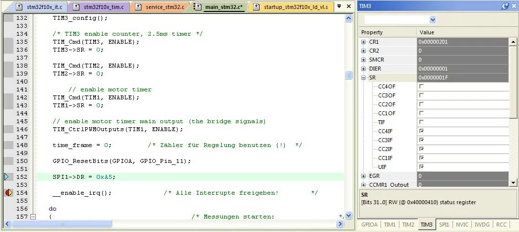

The configuration for TIM3 is as follows, void TIM3_config(void) { TIM_TimeBaseInitTypeDef TIM_TimeBaseStructTIM3; NVIC_InitTypeDef NVIC_Init_TIM3 = {TIM3_IRQn, 2, 1, ENABLE}; RCC_APB1PeriphClockCmd(RCC_APB1Periph_TIM3, ENABLE); TIM_TimeBaseStructTIM3.TIM_Period = 0x75A0; TIM_TimeBaseStructTIM3.TIM_Prescaler = 1; TIM_TimeBaseStructTIM3.TIM_ClockDivision = TIM_CKD_DIV4; TIM_TimeBaseStructTIM3.TIM_CounterMode = TIM_CounterMode_Up; TIM_TimeBaseInit(TIM3, &TIM_TimeBaseStructTIM3); /* TIM IT enable */ // TIM_ClearFlag(TIM3, TIM_FLAG_Update); NVIC_Init(&NVIC_Init_TIM3); TIM_ITConfig(TIM3, TIM_IT_Update, ENABLE); } If you have any ideas where I should start looking for the problem, it'll be very helpful to progress in my work. #me-too
I am facing a problem with the timers I am using in STM32f100 MCU. I have configured different timers to operate during the execution of the code, but somehow, all the flags related to Capture/compare or Update in the SR are set as soonas I enable the timer. As I read in the datasheet, they are all set in the hardware, and even if I clear them manually in debug mode, they are set again immidiately. My configuration for TIM3, for example, does not need any CC functionality, though i do use it in other timers. But considering that I need TIM3 only for generating a time base, I still dont understand why should the CC flags in SR be set. Below is the snapshot where I enable the TIM3 and the flags are set.
