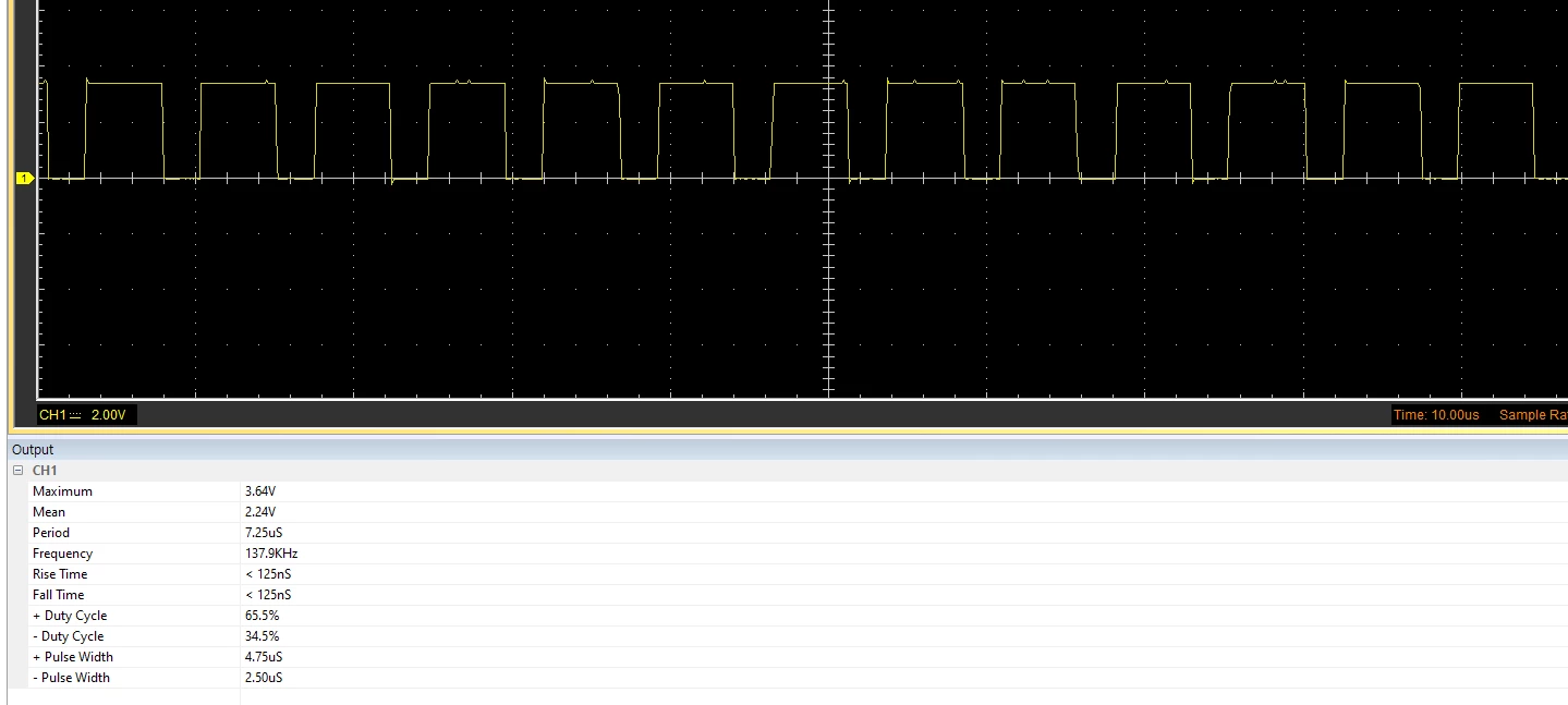

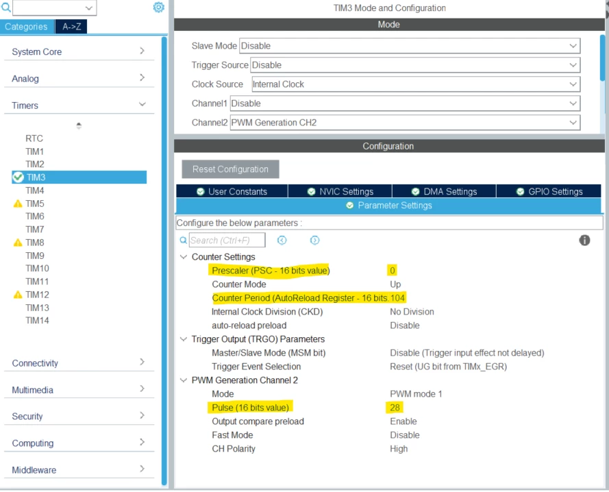

I'm struggling to get DMA working on a PWM Timer. I've read just about everything i can, but  it is not working.
Running this code.. produces a PWM signal as expected on the output.
 /* USER CODE BEGIN 2 */
HAL_TIM_PWM_Start(&htim3, TIM_CHANNEL_2);

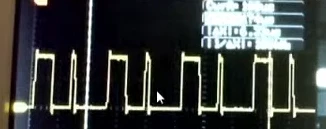

However, when I swap the code to the following, all I get is a one duty signal. It never produces a two duty PWM at all.
neo_data[0] = 52; //104(puls)/2
neo_data[1] = 26; //104/4
HAL_TIM_PWM_Start_DMA(&htim3, TIM_CHANNEL_2, (uint32_t *)neo_data, 2); //tim3 ch2

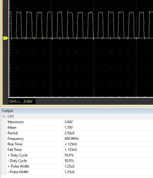

My expectation is that it should this. (youtube((4) STM32F103 네오픽셀 제어(Live Coding) - YouTube) capture)
I have my scope on single shot, and triggered correctly.

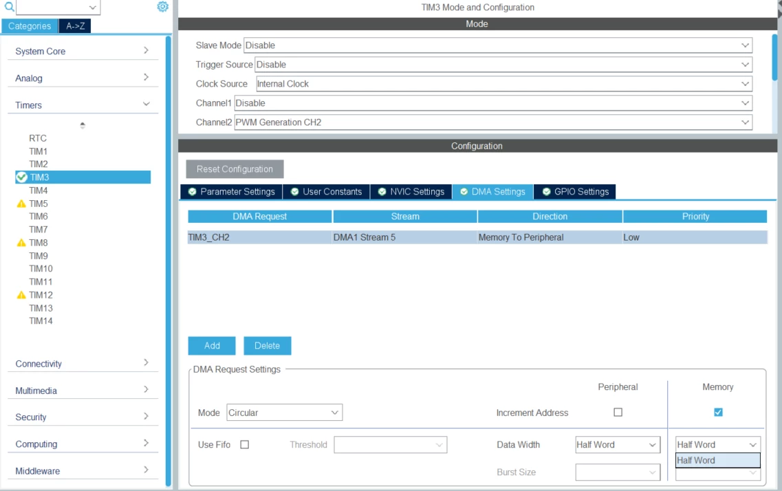

I have DMA setup for the timer

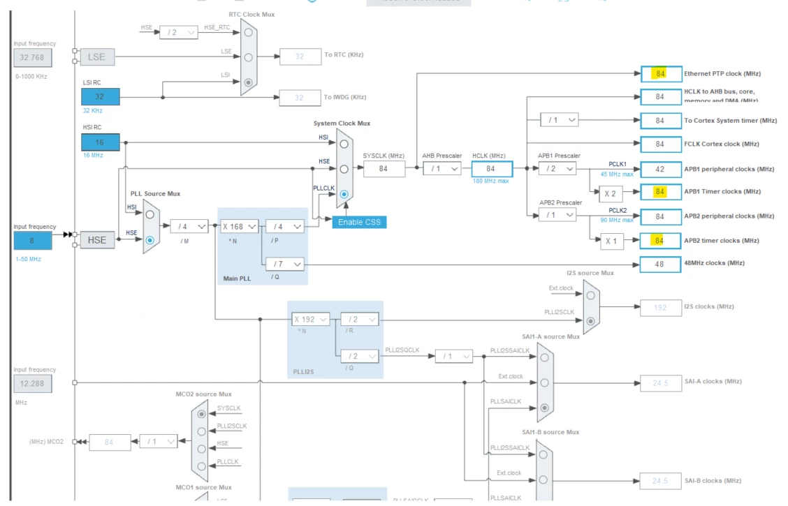

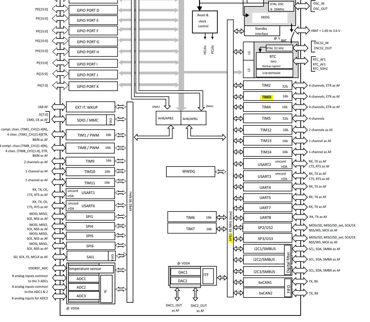

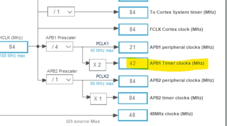

Welcome @Heidi  to ST Community,
From what I understood, you want to change the timer's duty cycle using DMA. your code looks fine
But notice that the APB1 timer clock is running at 84 MHz (you're interested in APB1 since TIM3 is connected to the APB1 clock as you can see in your product datasheet
So, you need to change that value (45MHz) in the clock tree, and since you're using a prescaler 0 that means you are dividing this frequency by 1.
By choosing ARR=100, you are dividing this frequency by 100 => 45KHz ( this will give you the advantage of changing the duty cycle to a percentage of 100)

Hello, @Sarra.S
Thank you for your support.
I tried change the parameter settings
APB1 Timer clocks (MHz) : 42
TIM3 CH2
PSC: 0
ARR : 100
Pulse : 0
/* USER CODE BEGIN 0 */
uint8_t neo_data[2];
neo_data[0] = 50; //duty 50%
neo_data[1] = 30; //duty

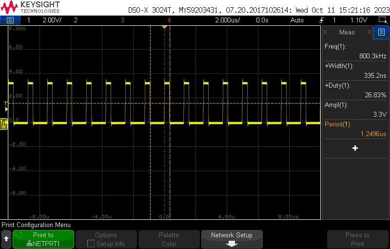

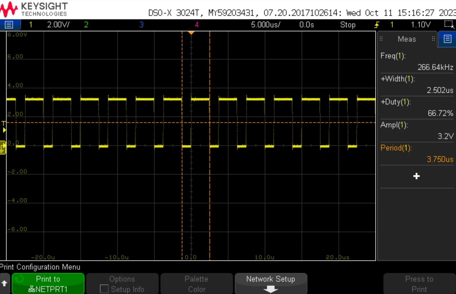

But I want to see 50% 30% duty..
Running this code.. (TIM parameter setting Pulse : 50)
waclawek.jan
October 11, 2023
Read out and check/post content of TIM and DMA registers.
October 11, 2023
Try defining neo_data as a uint16_t or uint32_t array instead. It definitely shouldn't be uint8_t.
October 11, 2023
Yes, I missed this line :
I thought it was declared in PV section, uint8_t is definitely incompatible with a parameter of type uint32_t in HAL_TIM_PWM_Start_DMA
