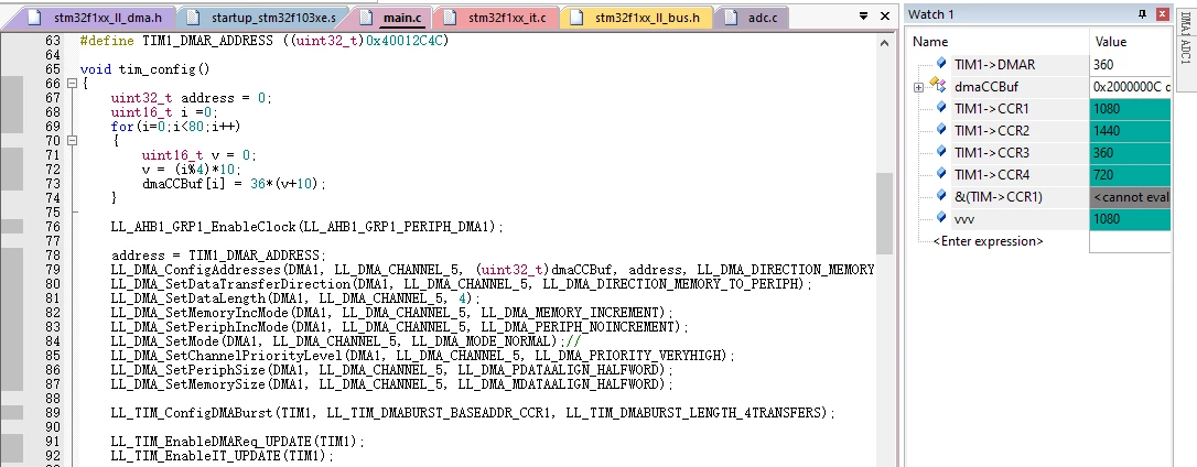

TIM DMA Burst works in incorrect sequence,
I use tim dma burst to update CCRx(x=1\2\3\4),my code works,but the CCRx value not assigned in correct sequence. My purpose is to let CCR1= 360�?CCR2= 720�?CCR3=1080.
But the result are random.0693W00000AMamoQAD.pngTIM and DMA config codes

waclawek.jan
waclawek.janBest answer
Apr 27, 2021 5:26 AM UTC
Don't observe TIMx_DMAR in debugger. Debugger is intrusive and reading DMAR in it advanced the internal counter/pointer to the individual TIM registers.
2 replies
waclawek.jan
xzi.1
xzi.1Author
Apr 27, 2021 5:36 AM UTC
Oh,Thanks very much. you are right! This program run ok!
