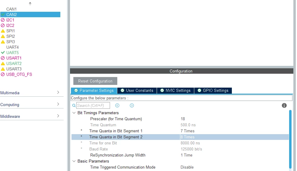

This specific CAN2 config crashes during HAL_CAN_Init(), why
Lets hope someone has a felicitously revelation, or a clue.

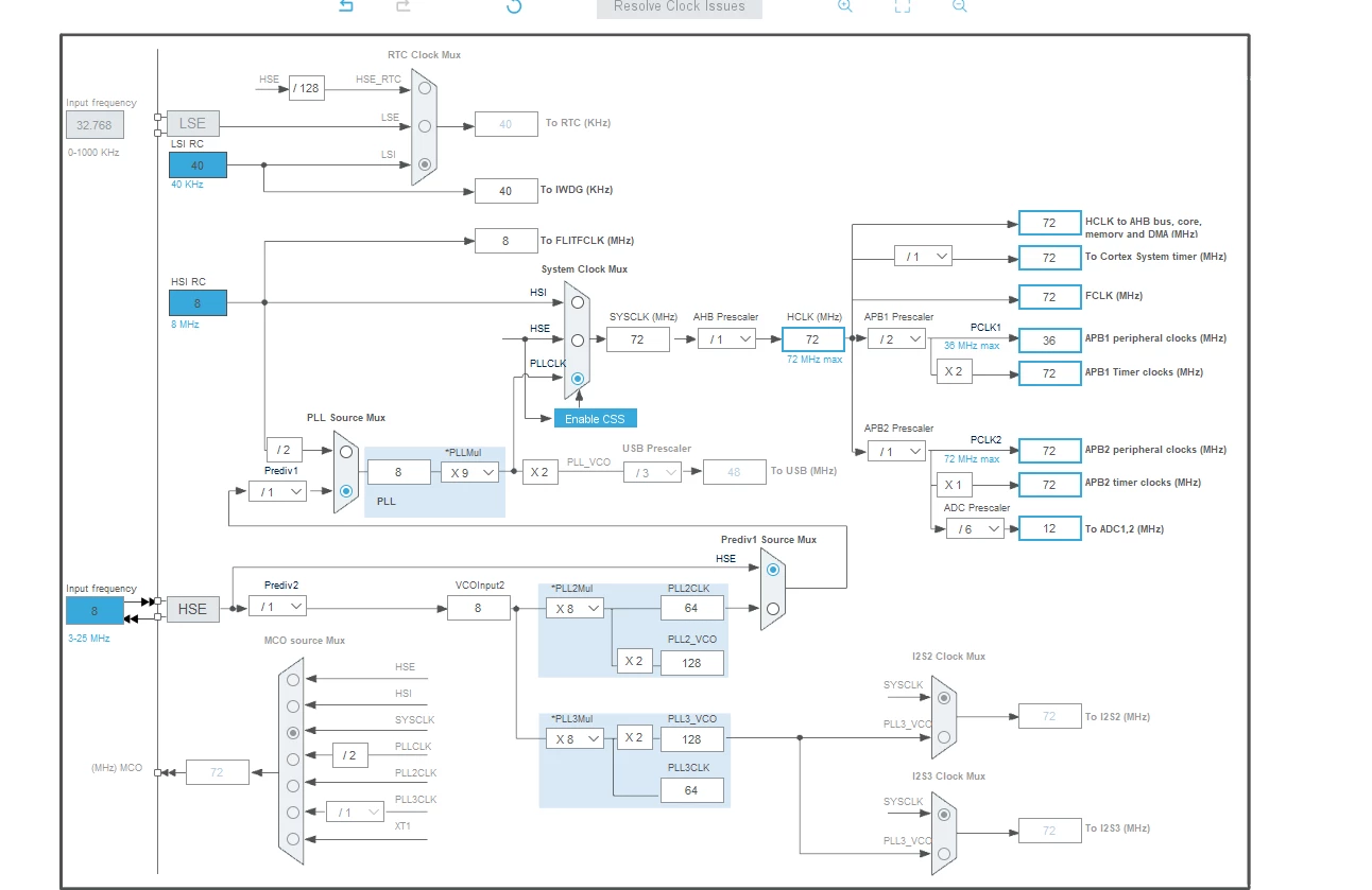

I am using a custom board with a nice stm32f105rbtx, fed with external XTAL.
Everything worked like a charm untill i configured the clock to be 72Mhz and readjusted the can parameters in CUBEMX to match 125.000bauds0693W000007ZNwVQAW.png

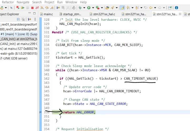

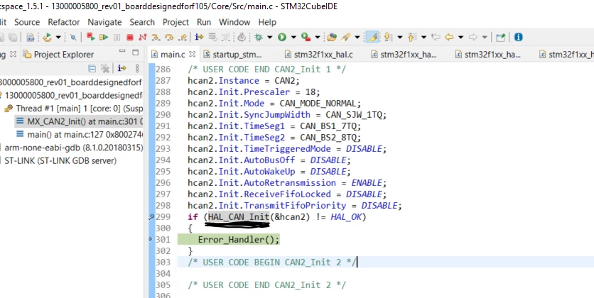

when i run the generated code it crashes riight here in HAL_CAN_Init();
The init function timeouts right here and returns HAL_ERROR
/* Check Sleep mode leave acknowledge */
 while ((hcan->Instance->MSR & CAN_MSR_SLAK) != 0U)
 if ((HAL_GetTick() - tickstart) > CAN_TIMEOUT_VALUE)
 /* Update error code */
 hcan->ErrorCode |= HAL_CAN_ERROR_TIMEOUT;
 /* Change CAN state */
 hcan->State = HAL_CAN_STATE_ERROR;
 return HAL_ERROR;
I have no idea why the canbus "stays in sleep mode" during initialization with this config.....
