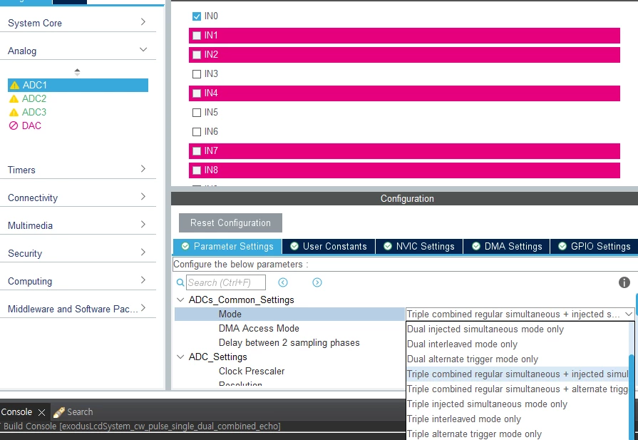

there's no triple regular only mode in mx now version
I've used triple regular simultaneous mode only before
(stm32f427zgt6)
but now i try this with updated cube mx version, i cannot find it
Is it deleted?
so now i am trying combined regular simultaneious but it is no

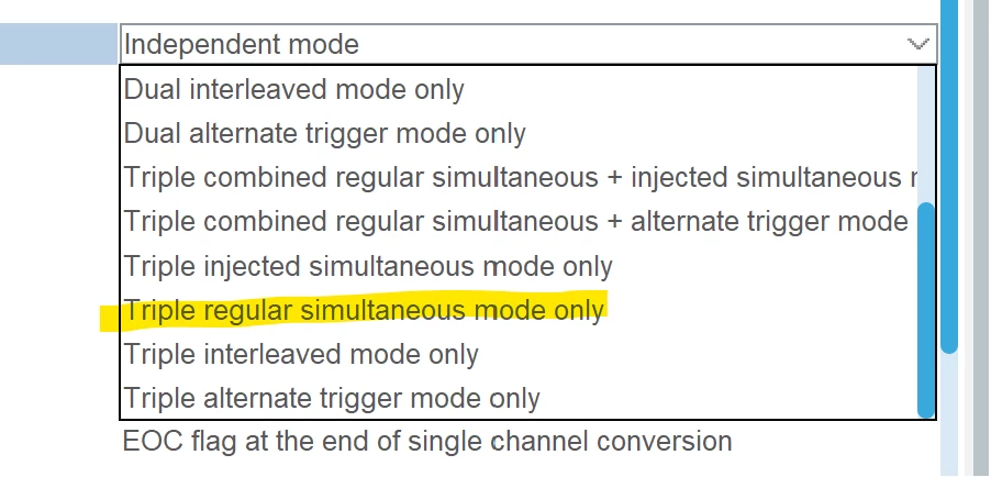

It's there for me using v6.10 CubeMX and v1.28.0 package, which I believe is the latest.
Attach your IOC if you can.

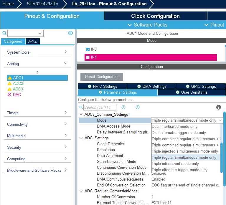

Thankyou i found what was problem
Before project was stm32f42'9'zi
Now i am trying with stm32f42'7'zgt so chip partnumber is diff
