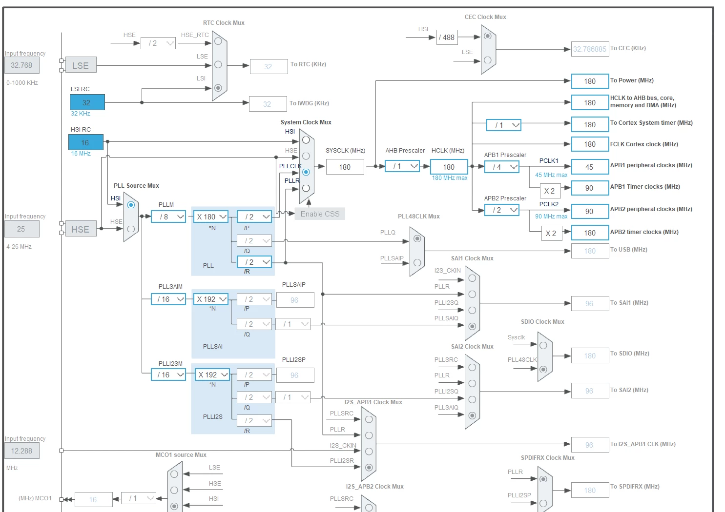

There is UART BUG on STM32F446RCT6
STM32CUBEIDE:  version 1.14.1
PA0-WKUP ------> UART4_TX
PA1 ------> UART4_RX
On a new project when enabling the UART4 with interrupt on receive ,everything is working normal .
But once I enable PH1 pin as a GPIO_OUTPUT the UART is not transmitting or receiving any more.
Any ideas or help please?
Update 1: I attached the two code form comparing.
Update 2: if I configure the PH1 pin as input the UART4 will work normal

Dear @Mugtaba ,
PH0 and PH1 are used by the HSE - High speed crystal oscillator for precise clock and get right UART baudrate , if PH1 is configured as GPIO , the system will run on internal HSI and your  UART baudrate will be lost and so stopping at application level . Can you check your clocks ?

Thank you for your reply
but the HSE is already disabled, I am using the internal clocks

January 20, 2024
Interesting ! And what is your UART4 baudrate ? We need to replicated such behavior never seen before .
