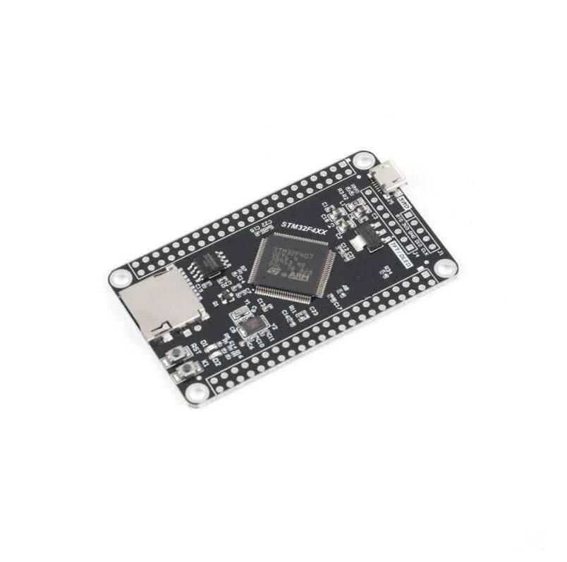

Hi everyone.
I tried adding USB_OTG_FS/Virtual Port Comm to STM32F407VET6 as a device only, but the problem is that when I try to connect the STM32 USB to my PC/laptop, it says “USB not recognized” on my PC/laptop, and I think it might be a problem with the cable, but after I replaced the cable 5 times and tried connecting it to my laptop, the problem remained the same.
Where does this problem originate—in the code or the hardware itself?
I used two boards, and both experienced the same problem.

Okay, I've found the problem.
The problem lies in the clock settings, more specifically in the PLLM value being too low.
Wrong.
 RCC_OscInitStruct.OscillatorType = RCC_OSCILLATORTYPE_HSE;
 RCC_OscInitStruct.HSEState = RCC_HSE_ON;
 RCC_OscInitStruct.PLL.PLLSource = RCC_PLLSOURCE_HSE;
 RCC_OscInitStruct.PLL.PLLM = 25;
 RCC_OscInitStruct.PLL.PLLN = 336;
 RCC_OscInitStruct.PLL.PLLP = RCC_PLLP_DIV2;
 RCC_OscInitStruct.PLL.PLLQ = 7;
Correct.
 RCC_OscInitStruct.PLL.PLLM = 8; <- set 25 to 8
After I changed the PLLM value to 8, performed debugging, then unplugged and plugged the USB cable back in, the Virtual Port Comm was finally fully recognized by the PC/laptop.
