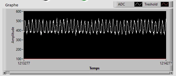

The values read by my ADC have not sense considering my RES setup (STM32H747).
I am using the VREFBUF as a reference for my ADC reading and I set it up to the max (2.5 V) and used the capacitor circuit described in AN5690 p.2 Fig. 2. The code used for my ADC and VREFBUF are described here :

Now when I read the value collected by my ADC under a 12bit res setup I do expect for a signal with a 1V offset and a 500mV amplitude to read values above 4095/2 yet I read values between 400 and 500, it seems like the signal is read correctly but not it s scale (I joined a picture of my GUI made with Labview illustrating my results, the signal is a bit deformed but it is linked to speed limitation for data exchange via serial, I can not represent every sample)?? I don't get the reason as to why it does not consider the scale properly ... even if I were to have the wrong voltage Ref value the ADC readings should still be much higher considering the fact that the max voltag ref should be around 3.3V (based on my component's inputs) .

Check the resolution of the ADC you set.
if Vref=2,5v
if ADC- 12bit
1,5V=(4095*1,5/2,5)=2457
1V=(4095*1/2,5)=1638
0,5V=(4095*0,5/2,5)=819
(If i were you i would use a much slower square signal to test your ADC)

I checked and I indeed did setup a 12 bit res for my ADC, the only point where I doubt is that I chose the 12 bit res but there is also a possibility to go with the 12 bit "legacy" mode, what is that?
Also I will try with a slower square signal as soon as I get my hands on an oscilloscope (but I doubt it will change anything to my readings in term of ADC values).
Could it be linked to data management I saw many exemples where they were right shifting data but I completely ignored that part since I did not see the point( I did not add an offset afterall).

Hmm i tried going for a 16 bit res (RES=000) for my ADC but somehow while the values get within a 16 bit range the 0 V signal is referenced around 3000 also the maximum value of 2.5 v from the reference is referenced around 10000 what is leagues under what I should get for a 16 bit RES... maybe I should work on recalibrating the whole thing. Since I calibrated the ADC before initializing it maybe I should work on the VREFBUF trimming circuit (though the STM exemples don't imply such a big difference with theoretical values.
