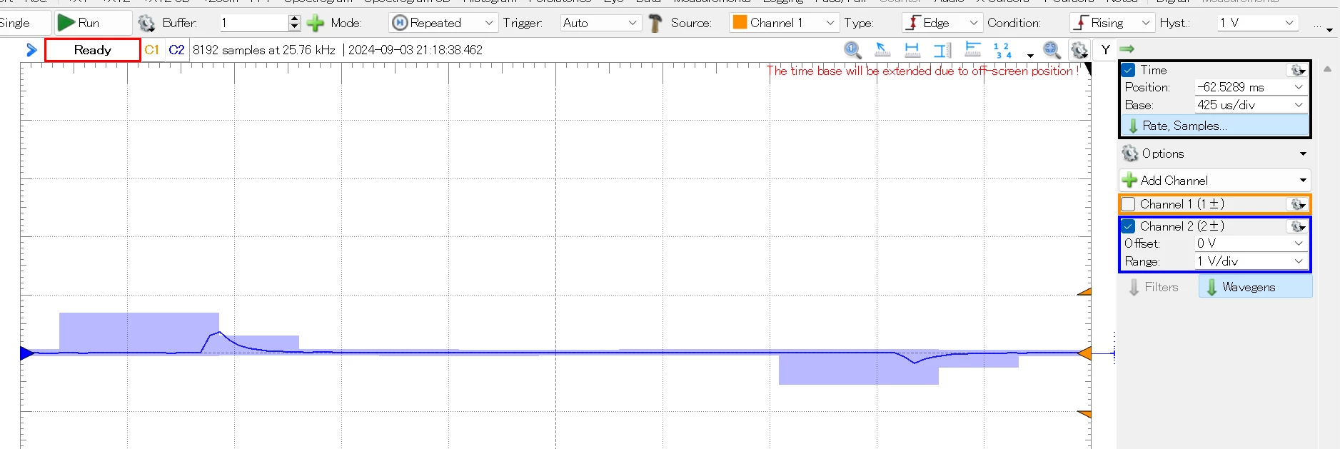

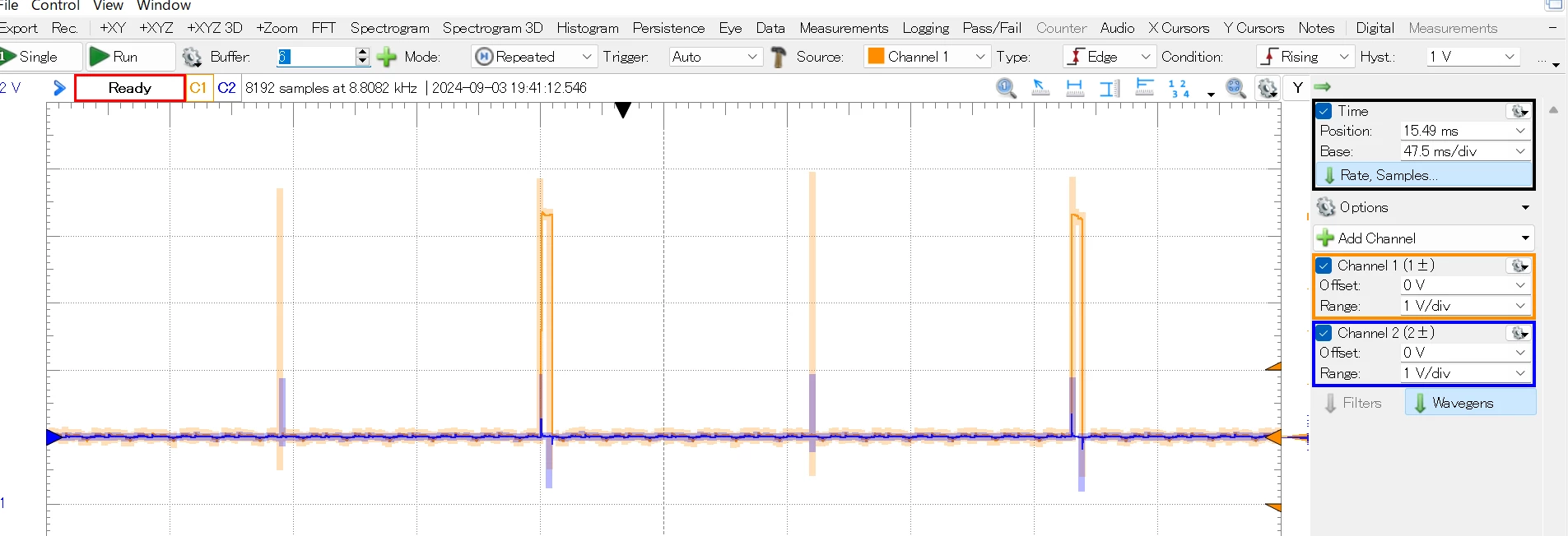

Show waveforms on the bus taken by oscilloscope or logic analyzer.
September 3, 2024
Orange is CS and blue is SCLK.
Best regards.

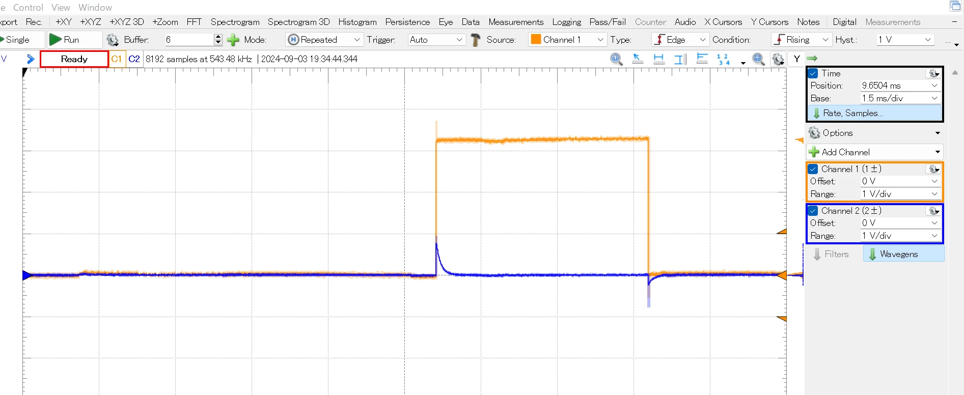

Show CLK vs MOSI

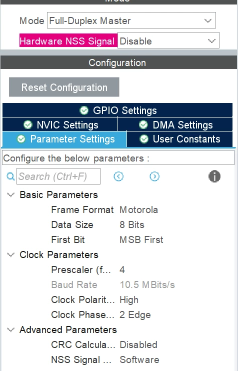

Get the clock rate to 1 MHz rather than 10 MHz

Orange is SCLK and blue is MOSI.
Best regards.

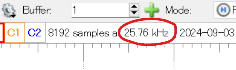

Your scaling and what you're capturing is unhelpful. You need to capture the interaction of the data/clocks at the point where you're interacting with the WHOAMI register.
Do you work with someone who has more experience debugging digital circuits and signals?
Perhaps start by drawing a schematic of exactly what you've wired to what.
The make/model of boards the TDK IC is mounted on would also be good contextual information in your presentation of the problem.

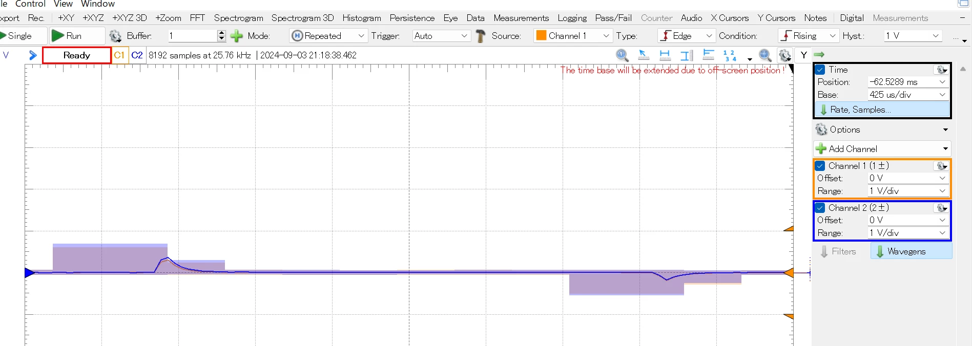

This doesn't seem to be correct - there are no pulses on SCK (nor MISO/MOSI).
Double-check the wiring.
September 3, 2024

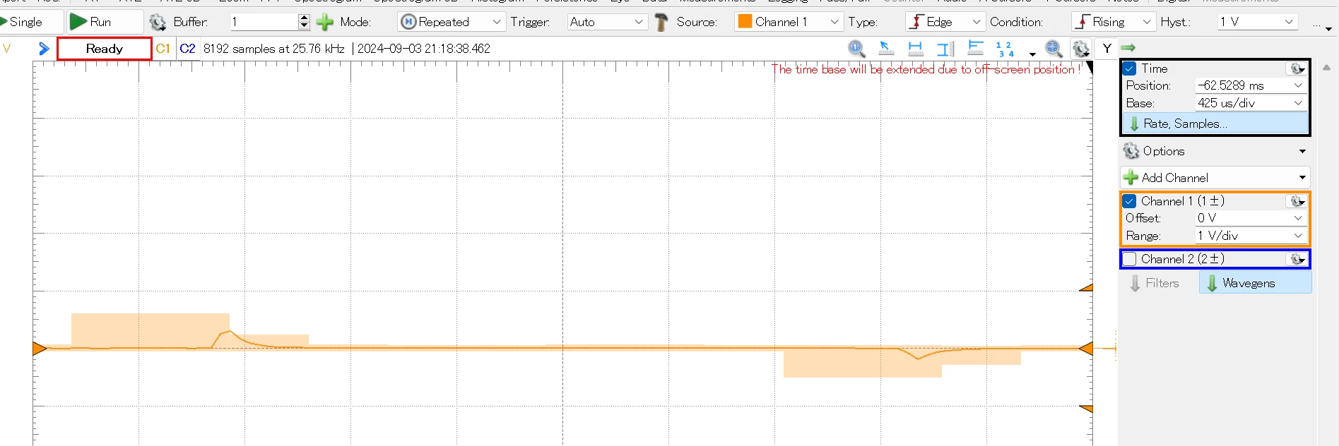

Not going to catch a 10 MHz signal with a 27 kHz sampling rate.
Code seems fine.
September 3, 2024

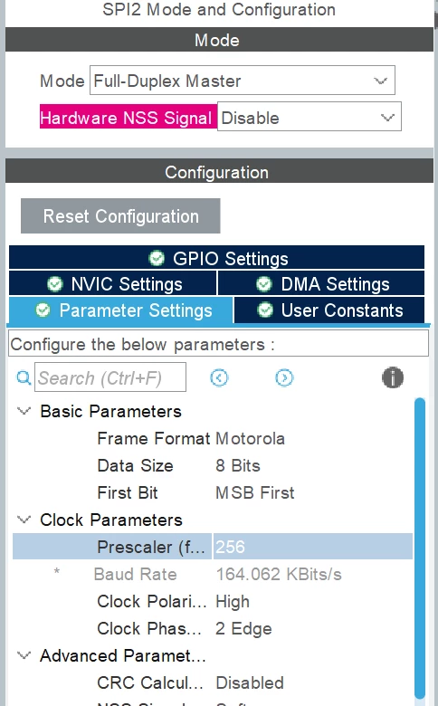

How much is optimal in this case?
Best regards.
waclawek.jan
September 3, 2024
Show waveforms on the bus taken by oscilloscope, this time set with proper sampling rate (i.e. at least 4x the SPI baudrate, but more is preferrable).
