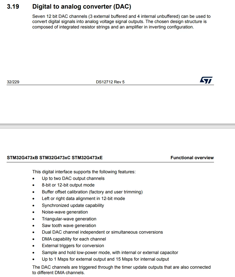

STM32G473CB has 3 DAC channel outputs.
a. Can these three DAC channels output a 100KHz triangle wave signal at the same time?
b. In addition to the triangular wave, can the output signal output an irregular 100KHz waveform?
thanks

May 22, 2025 2:04 PM UTC
I'd say 15 msps / 4096 = 3.6 kHz if triangular wave at full scale up-down.
For 1 msps dac it accordingly lower.
But dac can produce up to 7.5 MHz sinewave having properly design hardware filters

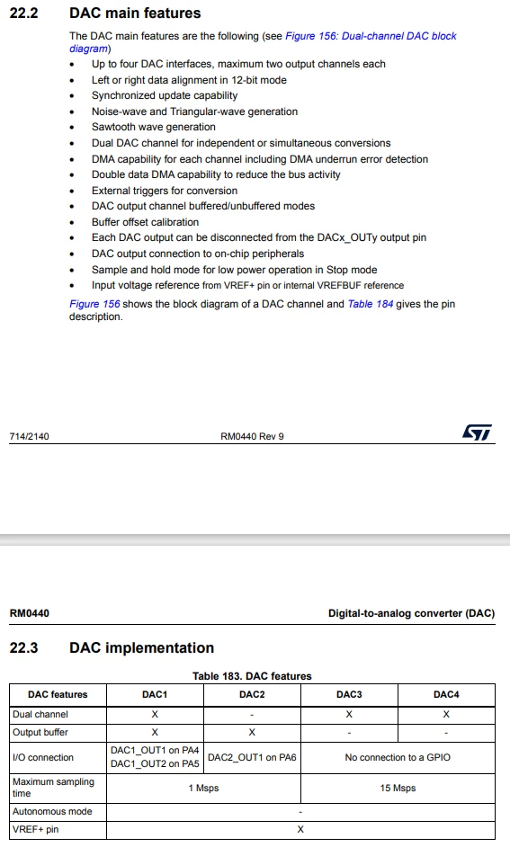

Hello @licunxu and welcome to the community;
According to the reference manual and the datasheet, the STM32G4 supports up to 4 DAC interfaces and maximum two DAC output channels each.
