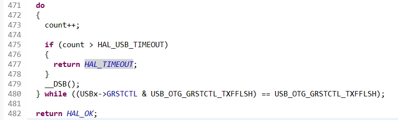

USB_FlushTxFifoc & USB_FlushRxFifo API flag USB_OTG_GRSTCTL_TXFFLSH & USB_OTG_GRSTCTL_RXFFLSH can not clear when set.

I use the USB3340-EZK and checked the clock configuration is correct,and the USB_CoreInit API can return HAL_OK.
It's run OK last week, but get the HAL_TIMEOUT in "Flush TX /RX Fifo " this week. I have no change.

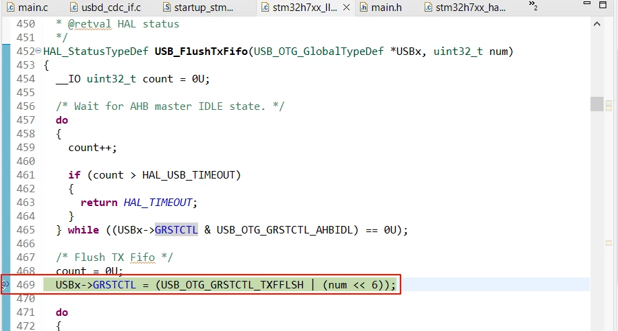

The local variables below when break stop on 469 line.
numuint32_t0x10
USBxUSB_OTG_GlobalTypeDef *0x40040000
GOTGCTL volatile uint32_t 0x30100c0
GOTGINT volatile uint32_t 0x100000
GAHBCFG volatile uint32_t 0x0
GUSBCFG volatile uint32_t 0x40001410
GRSTCTL volatile uint32_t 0x80000000
GINTSTS volatile uint32_t 0x14000020
GINTMSK volatile uint32_t 0x0
GRXSTSR volatile uint32_t 0x0
GRXSTSP volatile uint32_t 0x0
GRXFSIZ volatile uint32_t 0x400
DIEPTXF0_HNPTXFSIZ volatile uint32_t 0x4000400
HNPTXSTS volatile uint32_t 0x80400
Reserved30 uint32_t [2] 0x40040030
GCCFG volatile uint32_t 0x0
CID volatile uint32_t 0x2300
GSNPSID volatile uint32_t 0x4f54330a
GHWCFG1 volatile uint32_t 0x0
GHWCFG2 volatile uint32_t 0x229fe190
GHWCFG3 volatile uint32_t 0x3b8d2e8
Reserved6 uint32_t 0xe3f00030
GLPMCFG volatile uint32_t 0x0
GPWRDN volatile uint32_t 0xc200010
GDFIFOCFG volatile uint32_t 0x3b80400
GADPCTL volatile uint32_t 0x0
Reserved43 uint32_t [39] 0x40040064
HPTXFSIZ volatile uint32_t 0x0
DIEPTXF volatile uint32_t [15] 0x40040104
countvolatile uint32_t0x0

I have seen a similar issue on F4, could you confirm inserting __DSB(); resolves the issue to ensure transaction is complete.

I inserted the __DSB(), but can not solve my issue. But still get the HAL_TIMEOUT return.
