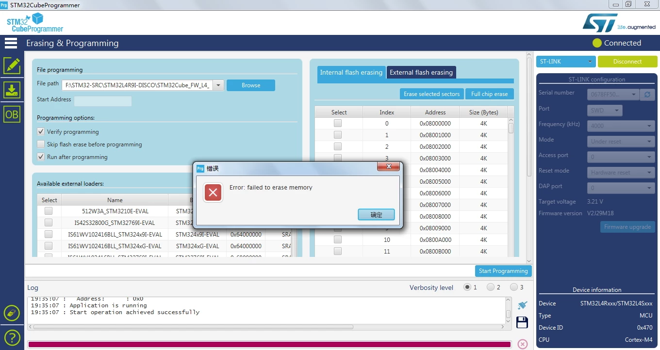

The *.stldr file generated by MX25LM51245G_STM32L4R9I-DISCO (@ ST-LINK Utility 4.2.0.0) can't work for STM32L4R9I-DISCO device. Please give me some advices. Thanks.
- 23 replies
- 6883 views
Step1. According to the readme.txt in the directory of "C:\Program Files (x86)\STMicroelectronics\STM32 ST-LINK Utility\ST-LINK Utility\ExternalLoader\MX25LM51245G_STM32L4R9I-DISCO", The detail is as follows:

Step2. Add Existing project of MX25LM51245G_STM32L4R9I-DISCO by using the EWARM 8.22.1,then rebuild all files.So the
*.out file will be generated, then rename to *.stldr and copy to the directory of "C:\Program Files (x86)\STMicroelectronics\STM32 ST-LINK Utility\ST-LINK Utility\ExternalLoader\"
IAR Configuration
Step3. When downloading MenuLauncher-STM32L4R9I-Discovery_V1.0.0.hex through ST-Link Utility 4.2.0.0,the error is as following:
23:49:29 : ST-LINK SN : 0678FF504955857567011028
23:49:29 : ST-LINK Firmware version : V2J29M18
23:49:29 : Connected via SWD.
23:49:29 : SWD Frequency = 4,0 MHz.
23:49:29 : Connection mode : Connect Under Reset.
23:49:29 : Debug in Low Power mode enabled.
23:49:29 : Device ID:0x470
23:49:29 : Device flash Size : 2MBytes
23:49:29 : Device family :STM32L4Rx
23:50:24 : [MenuLauncher-STM32L4R9I-Discovery_V1.0.0.hex] opened successfully.
Address Ranges [0x08000000 0x080001BC] [0x08006000 0x08006F48] [0x08007000 0x0803B303] [0x90000000 0x9022C30A]
23:50:24 : [MenuLauncher-STM32L4R9I-Discovery_V1.0.0.hex] checksum : 0x0F9EA60A
23:52:26 : Timeout during flash programming
23:52:26 : Error occured during erase operation!
