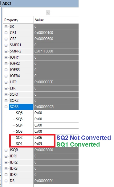

A sequence appears in the ADC_SQR3 register.
But when I then write HAL_ADC_PollForConversion(&hadc1, 1000);
That conversion occurs only for the first Rank, in this case for the fifth channel.
The second Rank is not converted. Why?

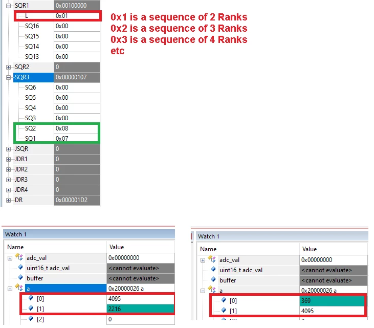

This code works for me and takes data from two Ranks.
But I think it is necessary to rewrite the HAL_ADC_PollForConversion function.
In the HAL_ADC_PollForConversion function, the ADC_SR_EOC bit is enabled after the conversion is completed.
If such settings are set hadc1.Init.EOCSelection = ADC_EOC_SINGLE_CONV; then all Ranks are converted in order, and after each Rank is converted, the ADC_SR_EOC bit is set.
And after the end of the conversion, you must immediately start the next conversion.
In my code above, I probably somehow accidentally manage to make it in these gaps, but I don't think this code is reliable.
But it works.

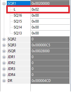

Where do you set the sequence length?
hadc1.Init.NbrOfConversion = 2;
waclawek.jan
July 24, 2023
Which STM32?
> only the first Rank from the ADC_SQR3 register is measured.
 How do you know?
Well, I don't see it in ADC_SQR1.L, in the list of registers you've given.
As I've said, if you want to learn how ADC works, don't use Cube/HAL, write your own code based on reading and understanding the manual.

The SQR1 register actually contained the number 1.
I put 2, but it still didn't help.
ADC1->SQR1=2097152;
2097152==0010 0000 0000 0000 0000 0000

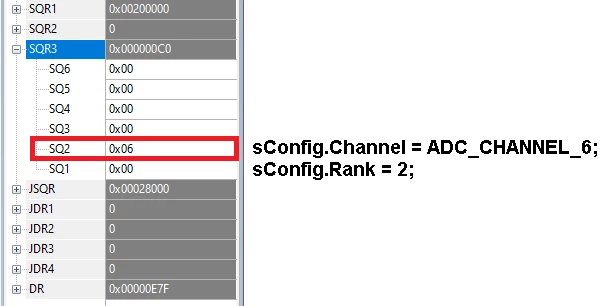

Here is an example if I set ONLY the second Rank.

The problem is that the DR register is 16 bit and when I write like this
a[0] = HAL_ADC_GetValue(&hadc1);
then I load the result from only one Rank.
How to download the result from the second Rank
And when I write this
HAL_ADC_Start(&hadc1);
then the conversion always starts from the first Rank
Maybe the second Rank is being converted, but I just don't know how to save the result of the conversion.
