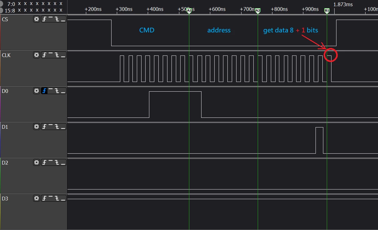

When I sent an SPI commnad to get the status from an SPI NAND, an extra clock was sent by the STM32F4.
I chedked the waveform with a logic analyzer.
An 8-bit command was sent to D0.
An 8-bit address was sent to D0.
There were 9 clocks sent by the controller to get data from D1.
I expected only 8 clocks.
The behavior of the SPI slave or SPI NAND was correct. It replied the 8-bit data normally.
The board I used is NUCLEO-F412ZG.
The tool I use is STM32CubeIDE.
The code I worte was given below.

    This looks like a classic case of the wrong CPOL and/ or CPHA setting...

    Not sure on the question. If you increase dummy cycles to 1, does the number of bits increase by 1 (to 2 extra)?
    Might be something with auto polling. Does the same happen with HAL_QSPI_Command + HAL_QSPI_Receive?

    Show initialization code.
    Clear auto/local variables in a function as they can contain random junk.
