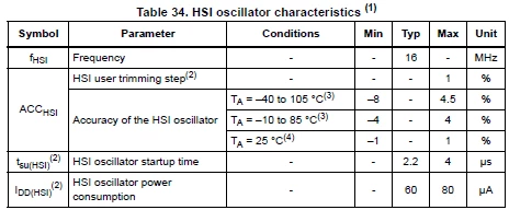

Hello everyone,
I have a question related to MCU oscillator. Honestly, i usually design MCU with external crystal , by belief that it is surely always better internal oscillator. Even i believed that if MCU isn't run with external crystal will make some grumpy designers unhappy. For example, in the past , with UART communication purpose, they often use 11.0592 MHz crystal instead of popular ones like 8Mhz or 16Mhz.
But one day, i tried with internal oscillator, i really that i don't know what is the purpose of external crystal ?

When the internal oscillator is not accurate enough for some tasks, then it's necessary to use an external crystal with tighter tolerances. Consider e.g. this one (STM32F417)
It doesn't even guarantee the +/- 5% required by asynchronous UART communication at extreme temperatures. USB requires 1.5% accuracy, so it would not work reliably if the MCU warms up a bit, that's why an external crystal is required when using USB.
That would be for Low Speed device, and no STM32 provides that AFAIK.
For Full Speed, you have to be more precise, quoting from USB2.0 7.1.11:
The full-speed data rate is nominally 12.000 Mb/s. For full-speed only functions, the required data-rate when
transmitting (T FDRATE ) is 12.000 Mb/s ± 0.25% (2,500 ppm).
