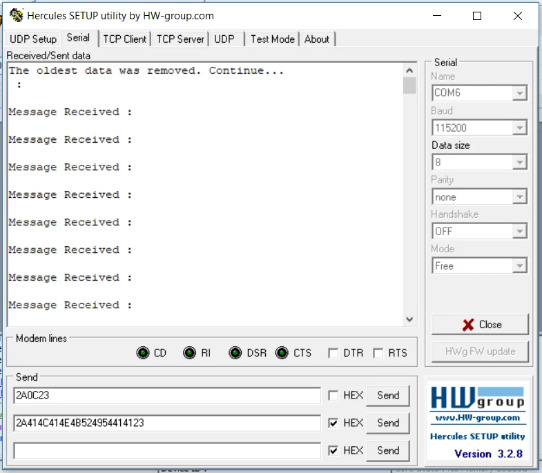

The problem in CAN Receive using Interrupt. As code hangs in (HAL_CAN_RxFifo0MsgPendingCallback) function in STM32F103C8T6.
I am working on CAN on STM32F103C8T6.
I am using a Callback Function of (HAL_CAN_RxFifo0MsgPendingCallback) but soon after receiving message code hangs in Callback Function even though no data sent afterwards it.
I am not getting the reason. Because this function works fine on CORTEX-M4 pocessor.
However, Transmit_Interrupt is working fine. But receive interrupt is hanging.
Here, is the code Snippet.
Code is getting stuck in the receiver callback function (HAL_CAN_RxFifo0MsgPendingCallback).

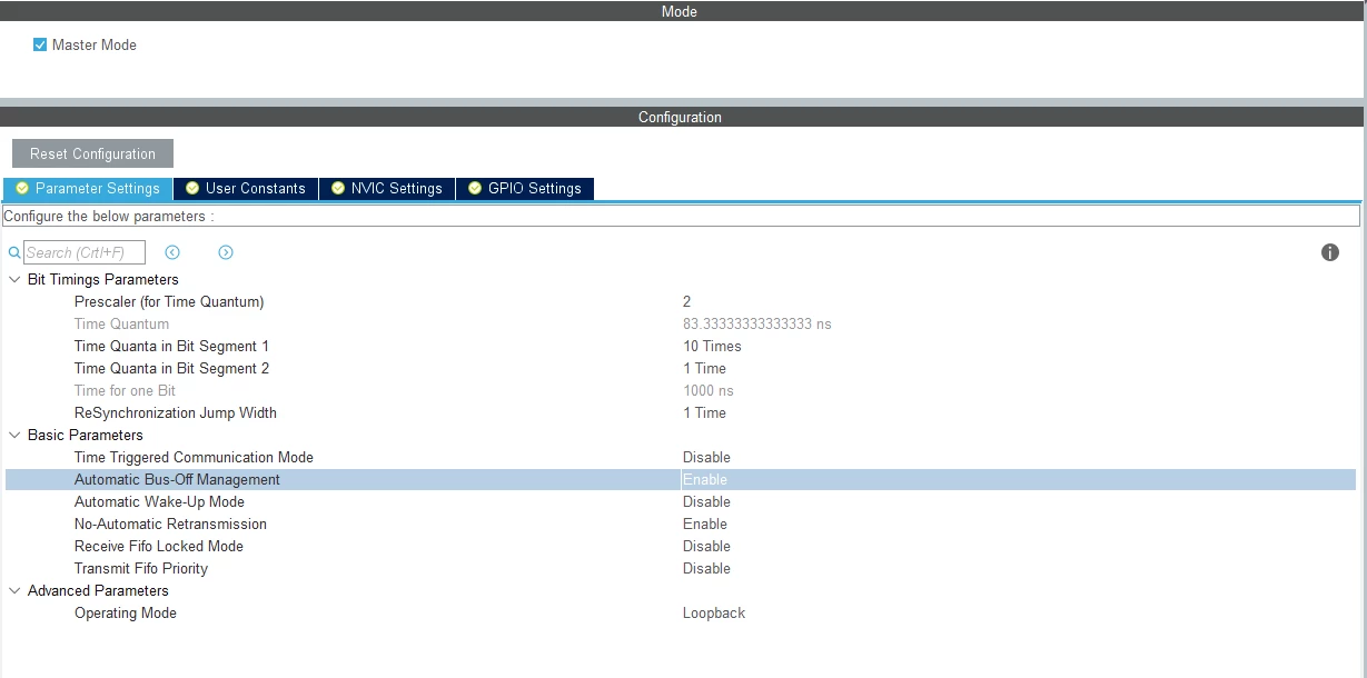

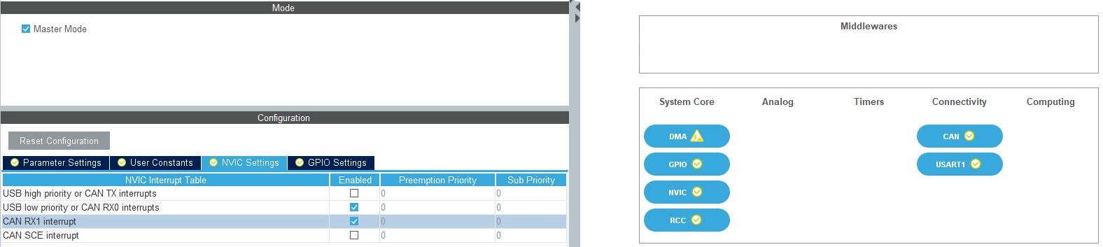

Please show me Your CAN settings.
I propose change in Your function void HAL_CAN_RxFifo0MsgPendingCallback (CAN_HandleTypeDef *hcan). Use sprintf and HAL_UART_transmit in the external functions and call it from the main. Maybe You have problem with the stack.
ALAN4
ALAN4Author
Jun 29, 2020 10:51 AM UTC
Sure, going to share the images and my source code.

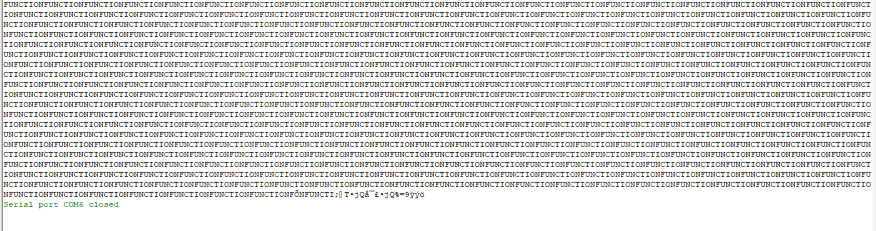

There are 2 interesting things happening :
#1 : Without enabling CAN_Transmit_IT , HAL_CAN_TxMailbox0CompleteCallback() function gets called.
#2 : And then, code gets stuck in the (HAL_CAN_RxFifo0MsgPendingCallback) function even if I am not transmitting in callback function and clearing the buffer.
I am pretty sure, it is not a programming bug. There may be 2 areas of bug :
  1. Wrong CAN_settings.
  2. May be some issue with library.

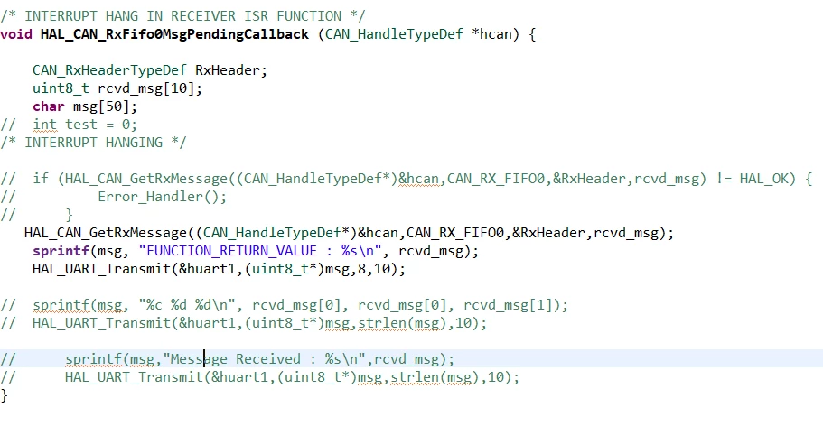

void HAL_CAN_RxFifo0MsgPendingCallback (CAN_HandleTypeDef *hcan) {
	CAN_RxHeaderTypeDef RxHeader;
	uint8_t rcvd_msg[10];
/* INTERRUPT HANGING */
//	if (HAL_CAN_GetRxMessage((CAN_HandleTypeDef*)&hcan,CAN_RX_FIFO0,&RxHeader,rcvd_msg) != HAL_OK) {
//			Error_Handler();
 HAL_CAN_GetRxMessage((CAN_HandleTypeDef*)&hcan,CAN_RX_FIFO0,&RxHeader,rcvd_msg);
 	sprintf(msg, "FUNCTION_RETURN_VALUE : %s\n", rcvd_msg);
 	memset(rcvd_msg, 0, sizeof(rcvd_msg));
 	rx_flag = 1; /* Raise the flag */
 	/* Control never gets into the while loop as there is incessant CAN_Receive_Interrupts */
