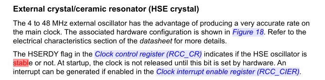

One thing you didn't mention was whether you compared the oscillator startup waveform between power-up (cold reset) and NRST (warm reset). The RM snippet shown suggests that it's possible for the clock to be running, but for the STM32 clock unit to deem it "unstable" and therefore gating the clock from feeding the rest of the chip. You can test for this condition by  configuring an HSE clock, but clocking the processor from HSI16. If you see that the value of HSERDY really is stuck at 0 after power up, but not after NRST, that's something concrete which can be debugged. ST could possibly then provide more specific guidance/explanation. Since this flag is supposed to identify/wait until the clock becoming stable, comparing the startup waveform between the two cases would be an obvious follow-up experiment.

Update: One thing I'm noticing now in the scope shot from the OP, is that in the old board the start-up oscillation amplitude grows monotonically. But in the new board, it has a "lump in its throat". It grows quickly, then diminishes quickly, and only then increases monotonically to steady state. That's not how it's supposed to look. And, not only is  the startup profile odd but, as a consequence, the effective start-up time is also 2-3 times larger in the new board vs. the old.

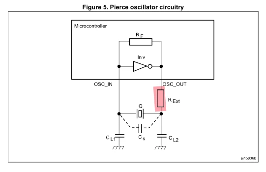

The new crystal used is specified with a typical drive level of 10-50uV. The original crystal is specified as 50uV typical, and 300uV max. It's at least possible that old crystal was more tolerant of a higher drive level (it was also physically much  larger). According to this Crystal Vendor's page on choosing STM32 crytsals:
Overdriving is an issue for the stability of the oscillations and is manifested in no oscillation or high jitter. Equally we need to consider drive through the crystal. The spec will detail the max drive level, and testing should be done to see these criteria are not exceeded.
and too high a drive level can also damage the crystal.
The drive level is proportional to crystal ESR, so a lower ESR crystal also lowers the drive level which
may also be another factor (beyond increased gain margin, which was ample to begin with) why a lower
ESR crystal works better.
it would have been interesting to try and follow AN2867 to see if adding a limiting resistor Rext would
have fixed the issue.
