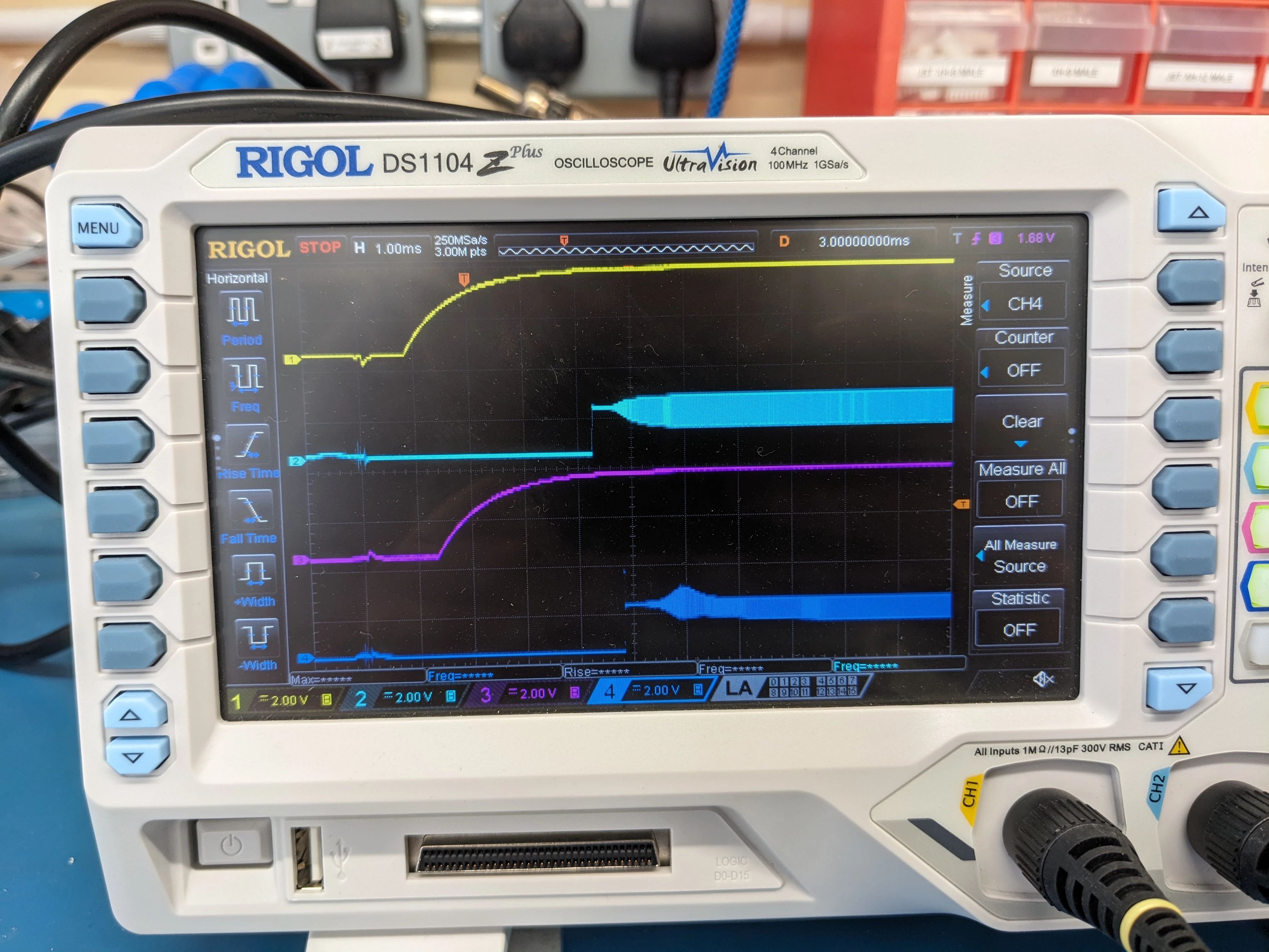

Hi all, I have a problem with a new version of an existing PCB using the STM32F334C8T6 microcontroller.
Known working code is loaded onto the new PCB, power is applied and the MCU starts up the clock and then seems to sit idle. If the NRST pin is then driven low and released the MCU starts up and begins operating normally. Holding NRST low on power up and then releasing it after a duration does not work, the MCU must attempt to start up and fail first. NRST is connected to a 10kΩ to +3V3 and a 100nF to 0V. BOOT0 is connected to a 10kΩ to 0V.
The signals here (top to bottom) are:
old PCB +3V3
old PCB NRST
new PCB +3V3
new PCB NRST
While both boards were powered at the same time the new board has an additional SMPS stage which adds a small delay to the rise of the +3V3 rail.

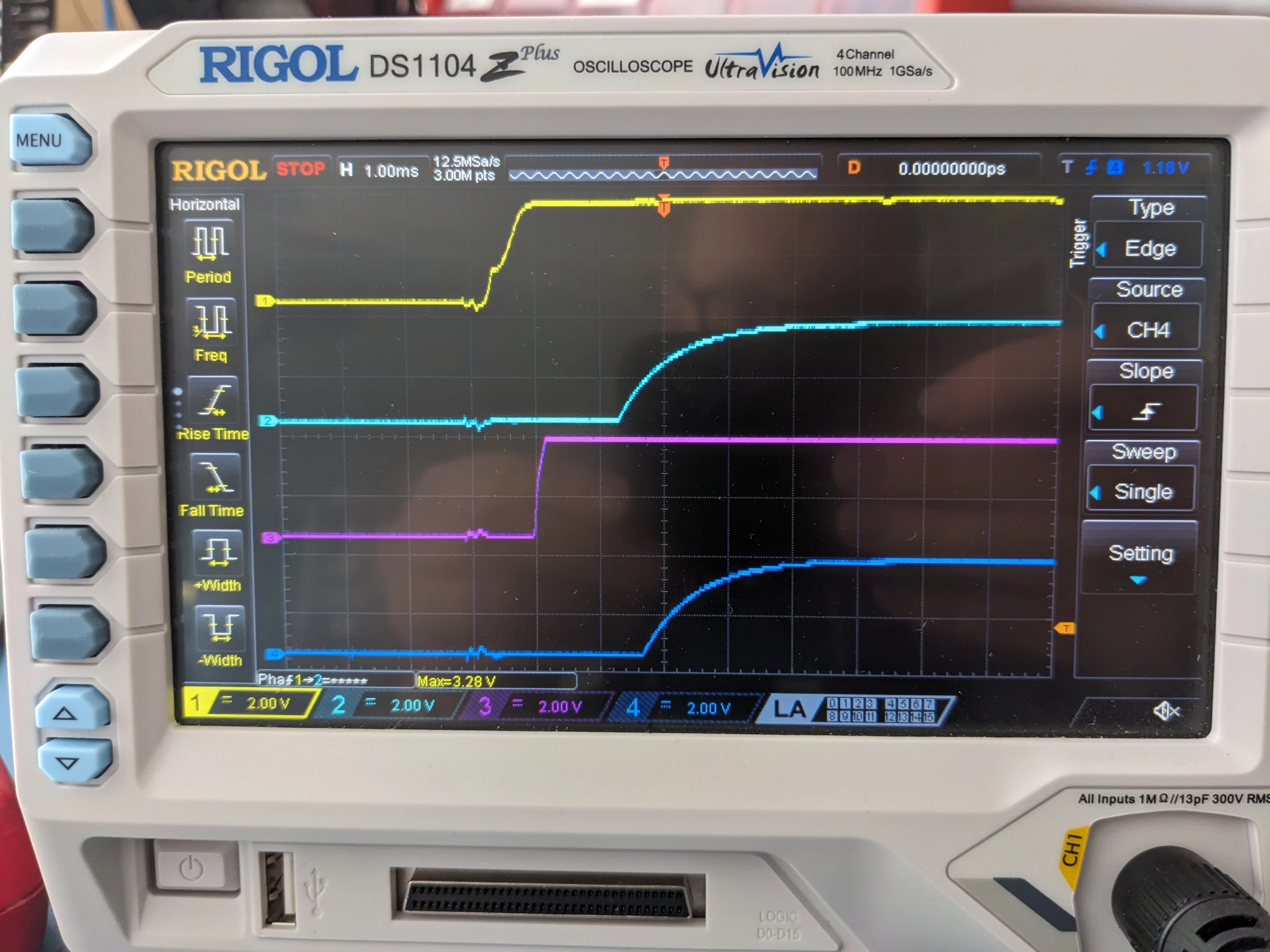

old PCB NRST
old PCB 8.000MHz crystal
new PCB NRST
new PCB 8.000MHz crystal
I've gone through a couple of stages of being suspicious of the clock as it gets enabled by the code, but then the code seems to stop/stall. However the scope traces don't show any significant problems. I've also compared the clock signal after the reset with the MCU running code and it looks identical to the above scope trace where the MCU is stalled.

38 replies
waclawek.jan
September 28, 2023
Are all VDD/VSS pins connected, including the analog ones? BOOT0 is connected how?
Try writing a minimal program e.g. a loopdelay-blinky, i.e. no clock setup etc. If it works without the explicit pushbutton reset, then the problem is in your code and you have to debug it in the usual way (maybe hot-connecting the debugger into an already "frozen" system). If it does not work, the problem is likely to be hardware-related.

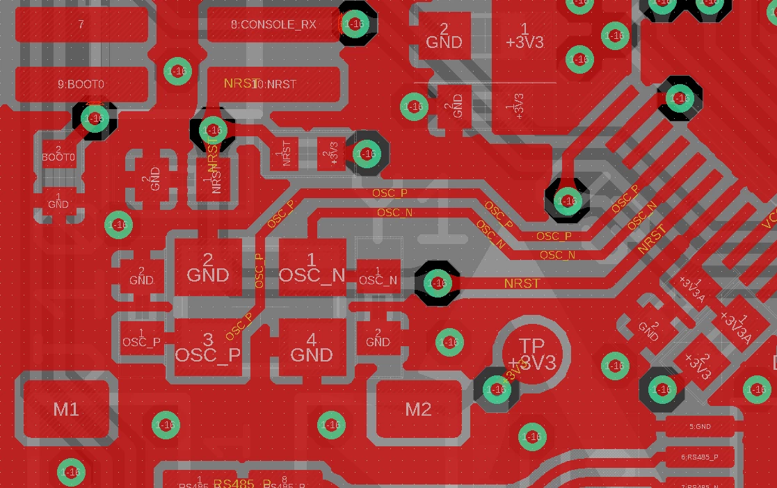

waclawek.jan
October 26, 2023
Show us the relevant portion (i.e. around crystal) of PCB layout.
RobertKAuthor
October 26, 2023
Okay, it's a 4 layer, 1.6mm thick FR4 board with 2oz copper per layer PCBA.
Top:
Crystal is a 3225 package, left middle. I tried to route the osc pins as a differential-ish signal. Tried to surround them with GND.

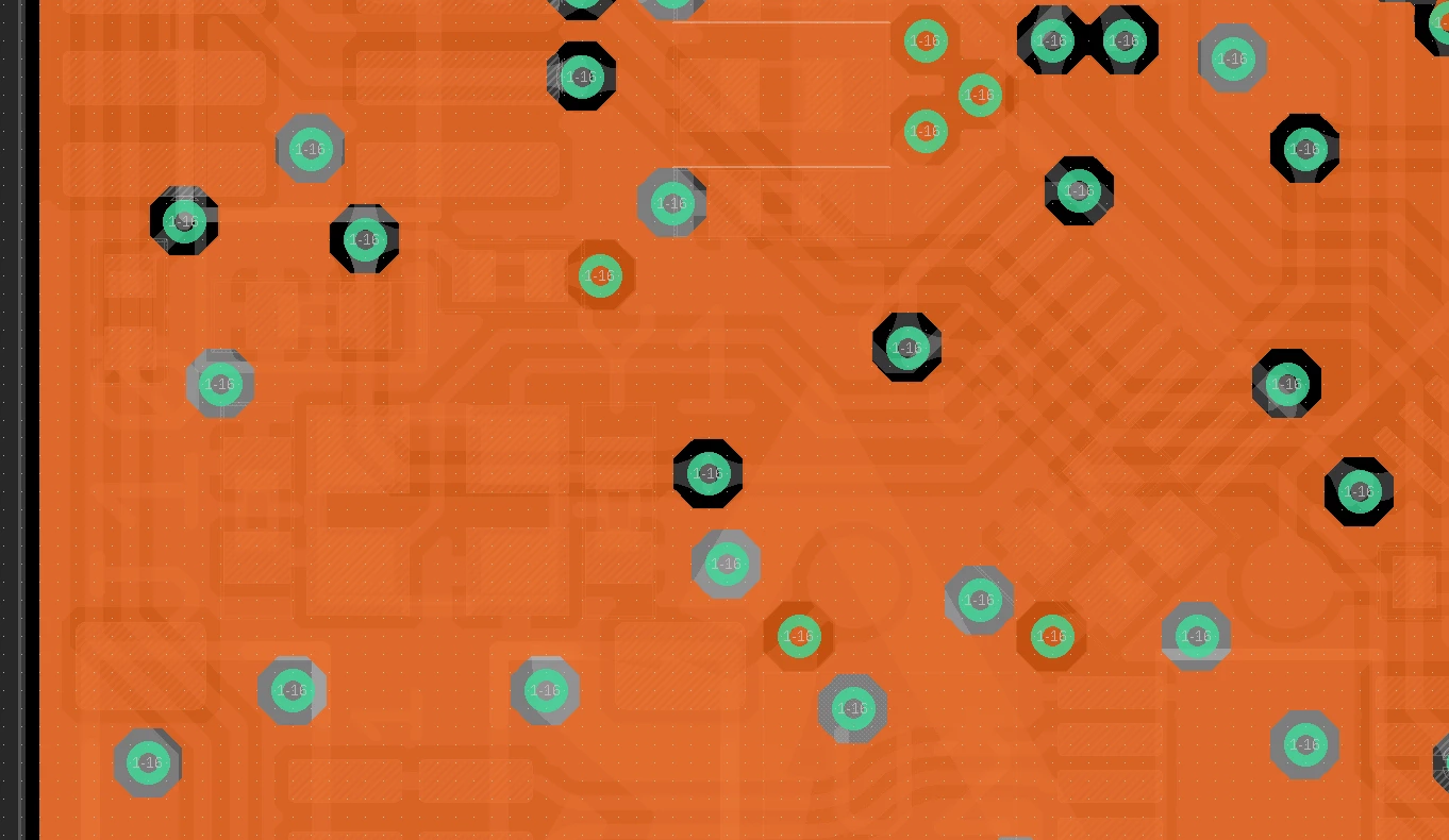

Inner 1:
Pour of GND.

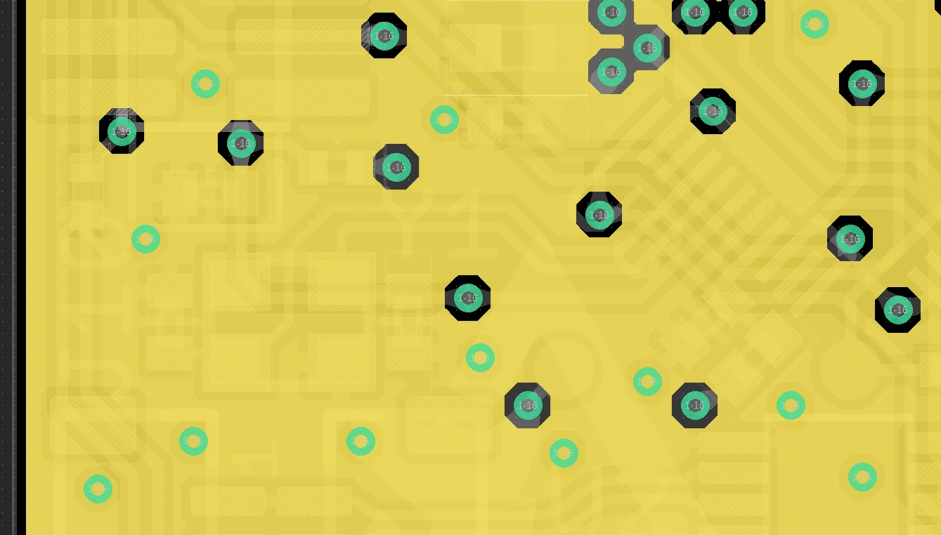

Inner 2:
Pour of +3V3

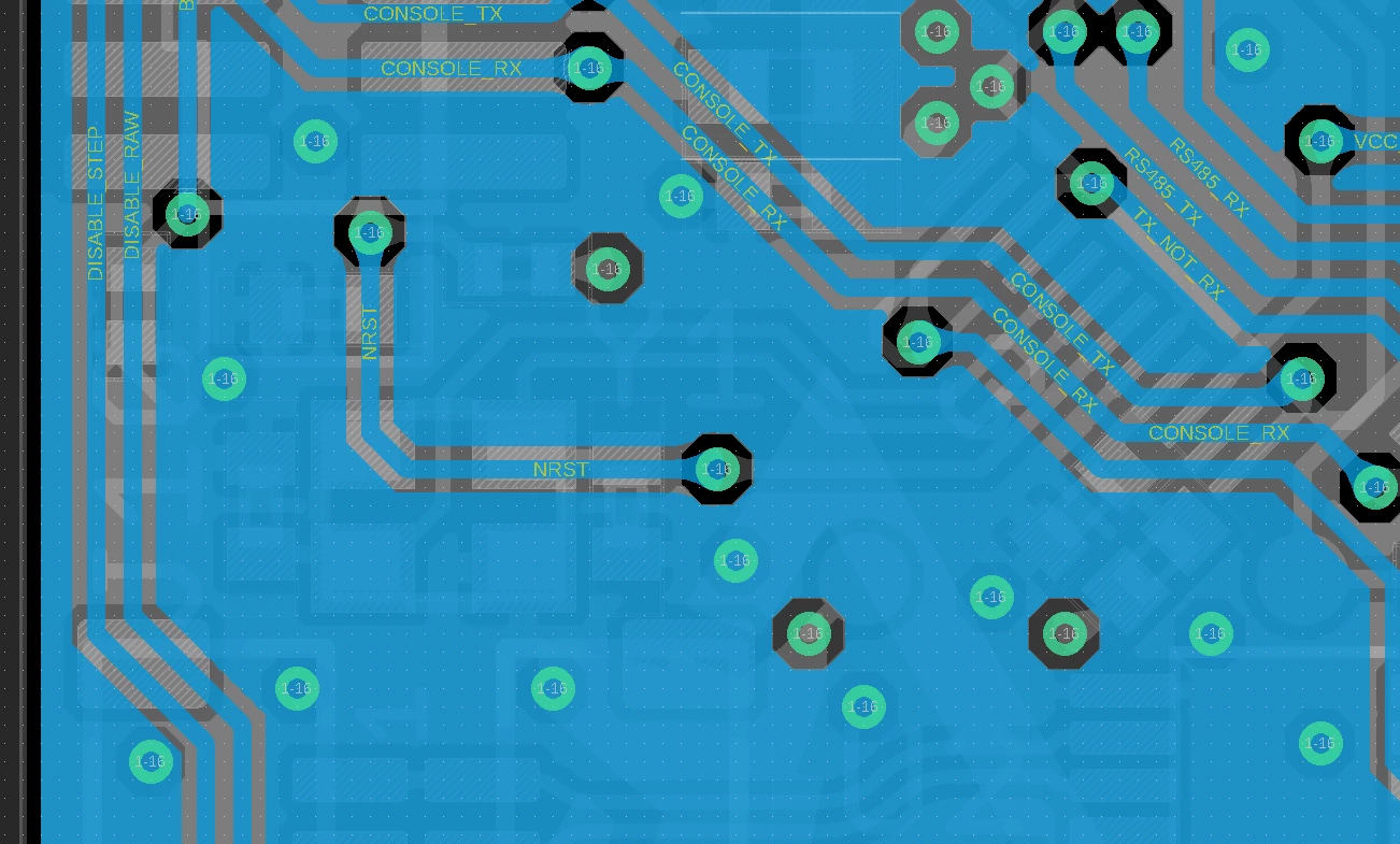

Bottom:
Mostly a pour of GND with some traces. NRST runs under the crystal, and CONSOLE_TX/CONSOLE_RX/TIMING_PULSE are all unused signals crossing at 90deg under the MCU pins.
I think I've done a pretty good job here and there shouldn't be anything iffy about the layout.
